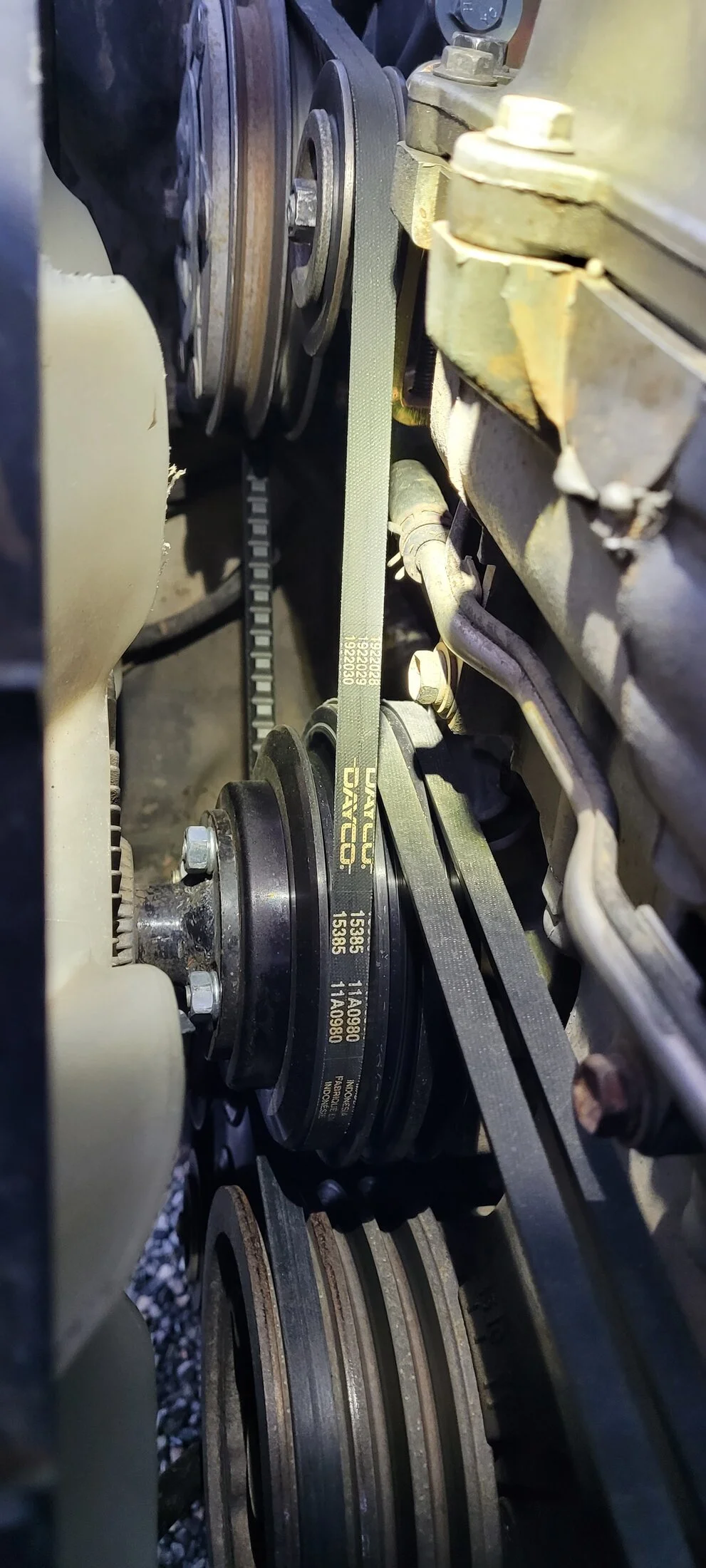

Guys, I can't recall which belt goes with the York compressor mount (which is what happens when you stockpile parts and never get around to installing them.) Anyone have a quick part number?
If no-one gets here before me, when the :princess: gets home from work with my rig, I'll grab the number off the belt for you.
90916-02281

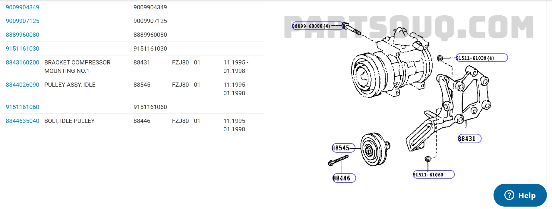

one more question - my single sheave 210 pulley has a bad belt alignment/offset - what is the recommended pulley for this setup?
Its the same pully as the AC idler for a 95-97.
8844026090​

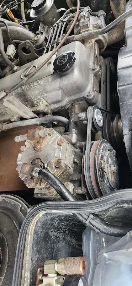

Mine is the two groove, just like Jon's.
I ordered it off the net, don't recall from whom.
