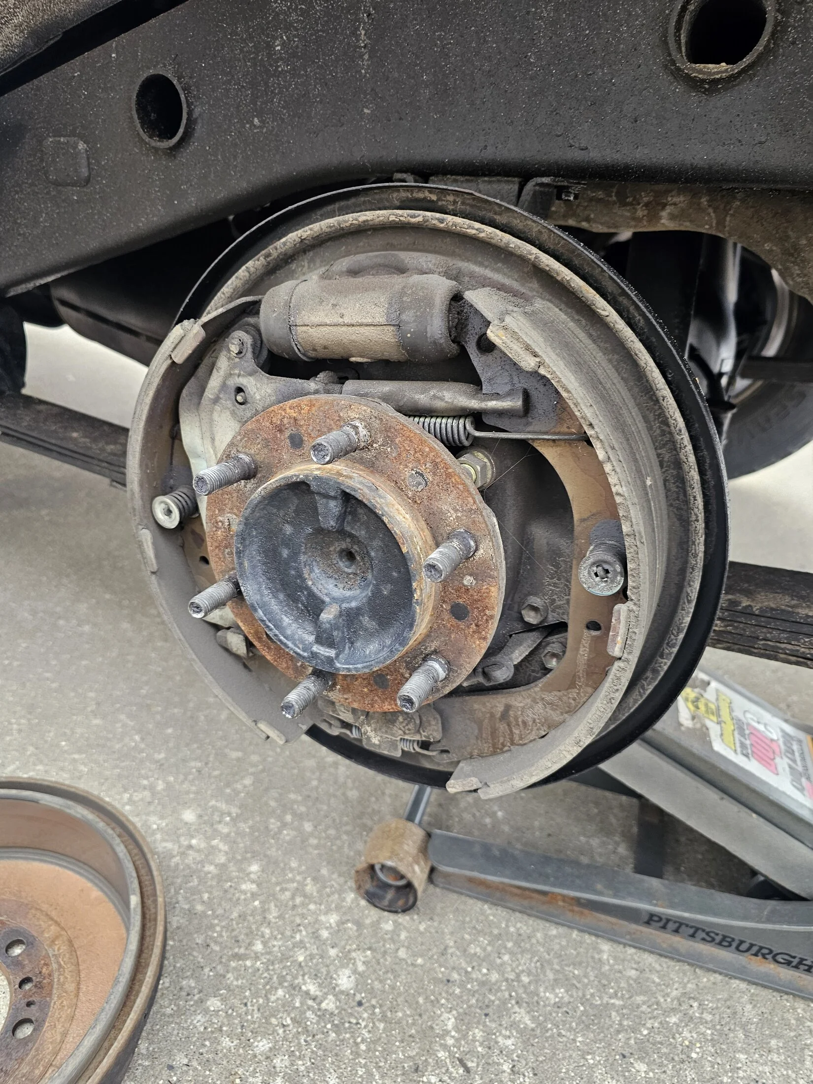

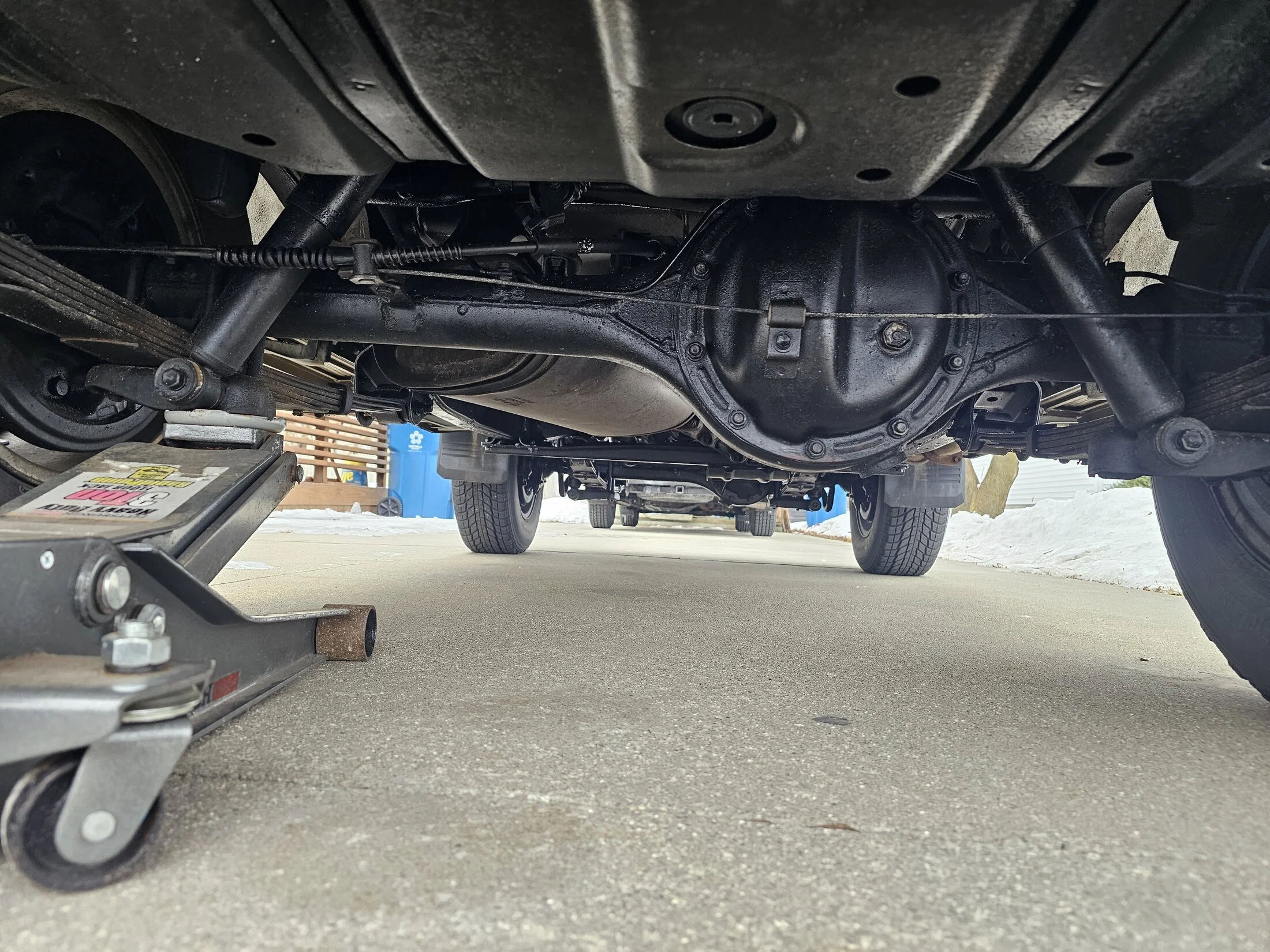

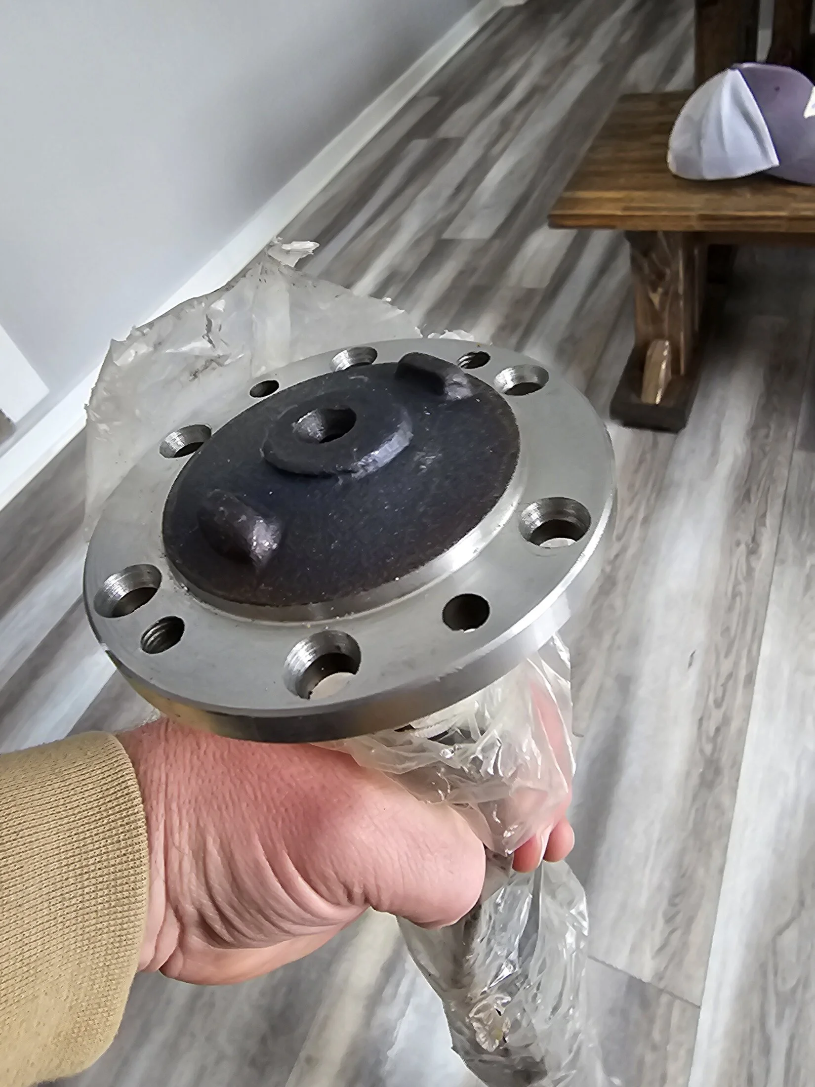

I recently purchased my first Land Cruiser, and I was having some vibration/death wobble. The tires are shot, one of the rims is slightly bent, and the steering stabilizer was bad as well. The wobble went away by replacing the steering stabilizer. I had a shop tell me that my Left rear axle shaft is bent, causing a slight vibration as well. I ordered what I thought to be the correct part (42312-60042) and it does not look the same at all. Can someone help me understand what I did wrong? It is a challenge ordering parts that I am not familiar with overseas sight unseen. Does this truck have a different rear axle from other 7x series trucks?
You got a full-floating axle shaft. Your truck has semi-floating axle shafts.
Totally different systems and what you have in your hand won’t work.
42312-60072 is what you need.
Looks like Terrain Tamer sells an AFT version -
Give their USA location a call/email and they can sell you one.
