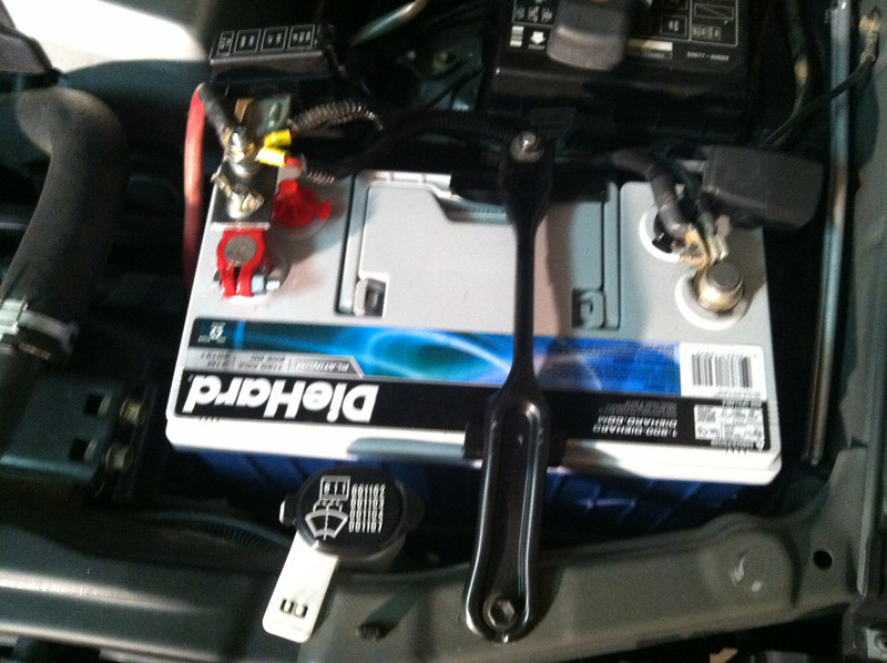

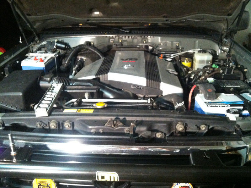

Here is what I did.. No doubt you have seen the 31M here from other pics.
But the spacer I fabbed up and the bracket fit might be another good example. Next step is to pick up Christo's dual batt kit and wire it all up.
Lookin good Chris! It it pretty stable of you try to move the battery around?

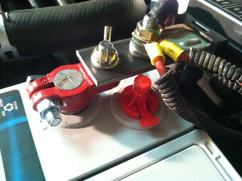

What type of metal did you use for your bus-bar? aluminum? That's what I used for my 31 install.
Die Hard Plat 31M, copper bus bar, mild steel bar stock and angle for the tie-down, factory j-bolt and front bolt, factory battery tray with one side sanded down (Outside, away from radiator / fan shroud), and a rubber drawer liner sheet inserted under battery. It seems to be plenty stable with the tie down securely tightened. Just need to paint it.
Where did you get the copper to fab up your bus bar? I'm just using aluminum and it appears to work fine, but copper is a better conductor..
My father in law is an industrial electrical contractor, and it was a piece of scrap from their shop. They use them for bus bars in a variety of enclosures pretty consistently. That's the smallest they had, the largest was I think 1/2" x 6" bar stock for a 5kV 2000A vacuum breaker cabinet they're working on. They had a couple feet of that stuff laying around.
Kinda funny, I told my brother in law I was looking for copper bus bar for a project, he mentions the 1/2" x 6" stuff, I was like, uh.... a) I'd feel bad taking that, I shudder to think what it costs, and b) that's WAY too big.
I think somewhere like Graybar or similar electrical contractor supply would sell it, if there's one near you. I know in ham radio circles folks buy it for station grounding equipment, usu in like 4-6' lengths.
Looks like 1' of the stuff is about $45 online, or about $11 / battery install:
http://store.electrical-insulators-and-copper-ground-bars.com/b-026-250-100-012.html
If you were buying, I'd definitely just get a narrower piece that you don't have to notch down and save some bucks. In reality I'd imagine the aluminum is probably fine. If you're winching across it, eh, maybe, dunno. Hit it with an IR thermometer or something and see, or spray some water on it and see if it sizzles? (Joking about the water test... mostly...)
Take a short copper pyp ,put a hammer to it and drill two holes in it ,works for me
That was my original plan as well.
I looked for copper but could not find. I used a 3/16 piece of steel from Home Depot. cut it, drilled two holes, done.
Jon, it does not move at all I bent the top OEM bracket in a vice.
