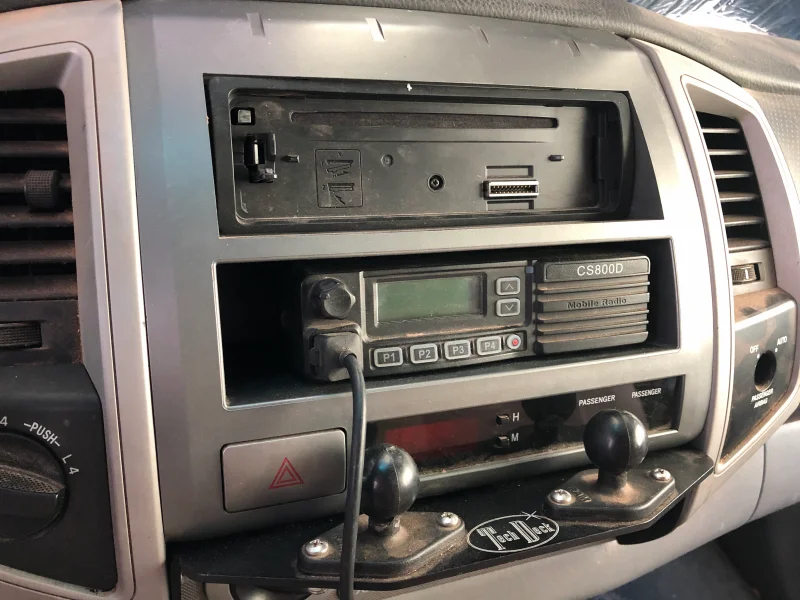

I replaced the double DIN factory radio in mine and the new insert had a pocket under the new single DIN radio that fits a mobile radio face nice. It might be possible to fit a complete radio here if it's not too deep. It would be close with my CS800D, might stick out a bit. The body is under the seat, though.

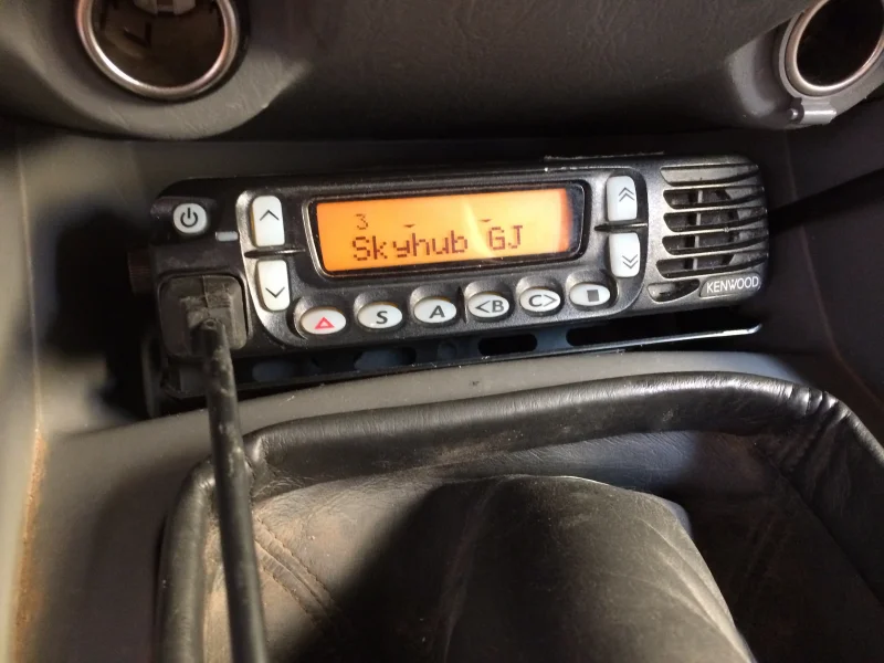

Put one in the slot ahead of the shifter on my truck, too. A complete radio wouldn't likely fit here. The face for my Tk-8180 (primary use is GMRS) is pushed almost all way back. MIght be 6 or 8 inches deep I'd guess. Body of the radio is also under the seat.
I ended up going with the Ram mount pictured above and the Ram "X" mount.
