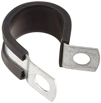

Would this type of clamp work?
I've found these in stock st Orchard Supply, in up to 1" diameter.
