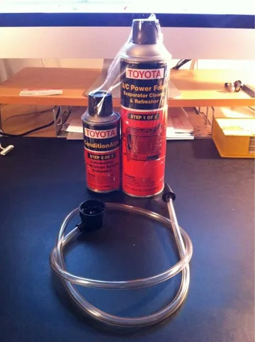

Same in the 100. Since OP doesnt have cabin filters thats one less thing to remove to see the evap. Toyota has an aerosol kit t o do this job.
