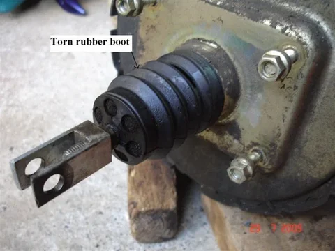

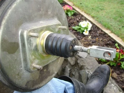

As far as I can see this booster 44610-60190 (photographed here) is identical to mine. (I just bought it as a spare and the EPC says it fits August 1980 onwards BJ40, BJ42 etc.)
As expected, the boot on this one is perished/torn also:

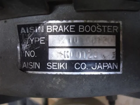

Once I had it, reading this sticker ...

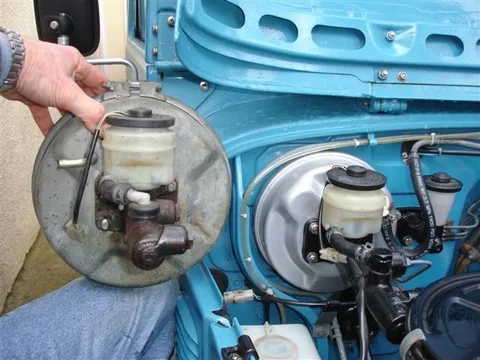

...told me the booster was part number 44610-60120 which was used on both BJ60 and HJ60 models (with front disk brakes) between Aug 1980 and November 1984.
As you can see, the booster diameter is too large for my BJ40 and the shortened length of the mastercylinder means that item would not be capable of moving enough fluid for my drums-all-round either:
But ....... at least I finally have my boot .... and the reservoir (with cap and level "switch") is a perfect match for mine too ... so it will be good to hold for a spare.

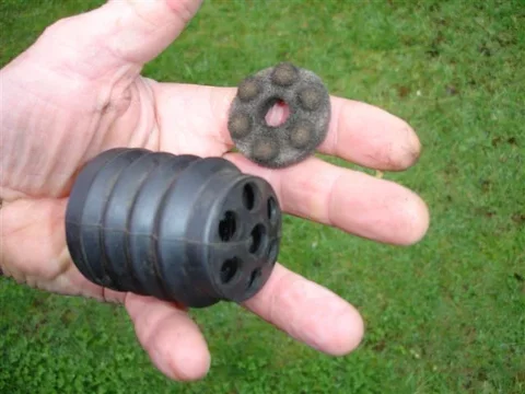

Here are some more pics of the parts I was interested in:

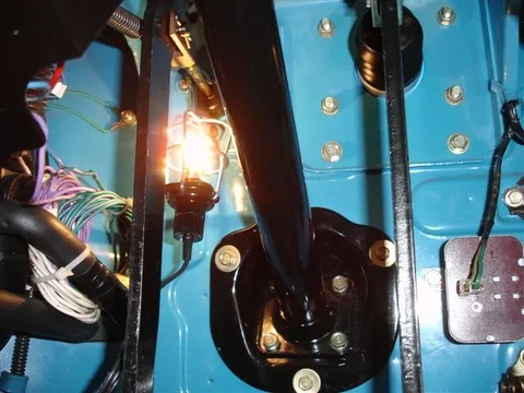

And I installed this new stuff yesterday morning (same day the booster arrived on my doorstep and before going to work) using my new trouble-lamp that I got recently from CruiserCorps. (Cheaper to get it from them in the USA than to buy it here from Toyota NZ.)
This trouble lamp is great for this sort of work because you can hang it right up there where you want to shed the light.
I found it a little awkward to get my 14mm socket (and ratchet) onto the pivot bolt to enable removal of the brake pedal .... but at least I managed to change the boot without needing to re-adjust the stop-light switch or pedal free-play. (I simply counted 12 3/4 turns to get the thing-i-me-jig off the rod and back on again.)
