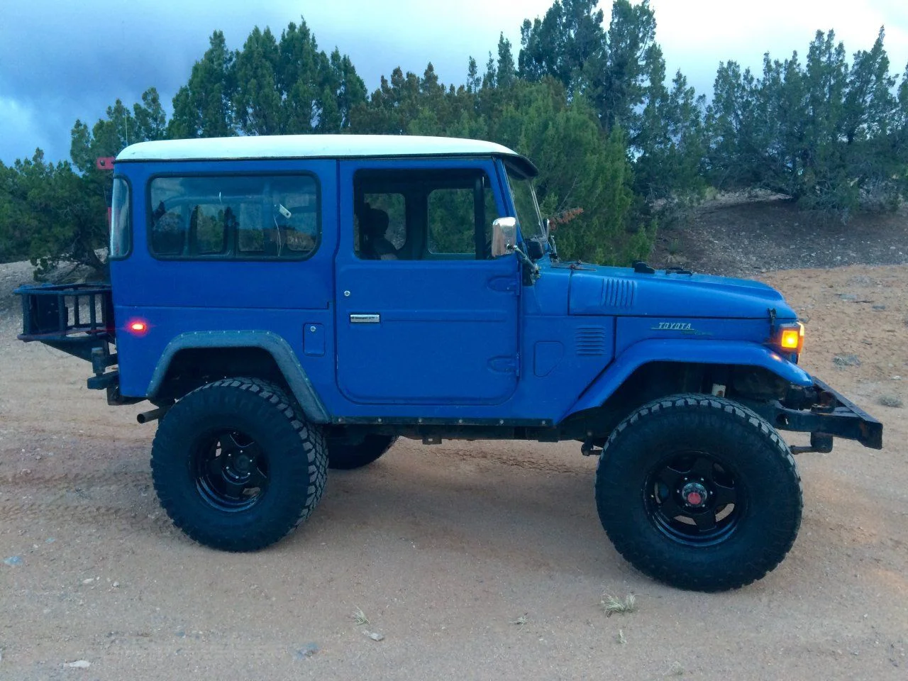

16" wheels work fine. They thing that you have to watch out for are the center hole diameter and the offset. Most newr vehicles with 6-5.5 pattern have a substantially smaller center hole and more negative offset offset than a 40 can use.
Typically, if it will fit an 80 then it will work on a 40.
For a 16" wheel that is probably acceptable. A 15" wheel is 3.25".
I have 3.5 on a 15" and it works fine. 4" is a no go for sure and that's the most common.
I just went with these on the 40 16x8 and 3.5" backspace.
Stealth Custom Series » F5 MODEL
I tried a set of Stock FJ80 wheels and they rubbed on the steering joint.
