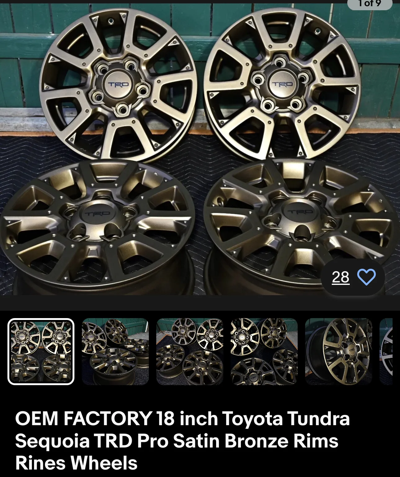

Also, I’m guessing something like this would work?

Yes, those TRD 18's you posted work great! I had those for a while too. They fit up stock just fine, but I ran them with a 1" spacer due to 35" tire diameter (to maintain stock-like scrub radius). If you're going with 32-33" tires, spacers are totally optional and not required.
