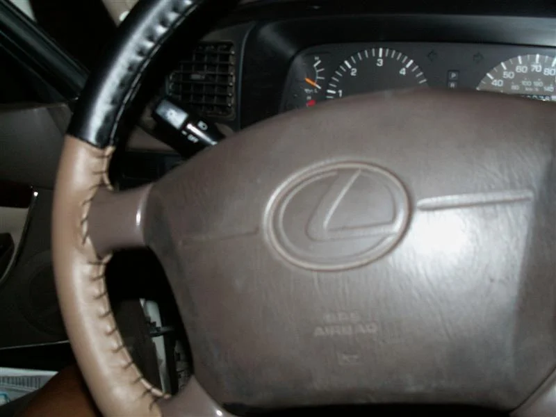

Here's what mine sorta look like -- pic sucks, I know...
attachment.php
