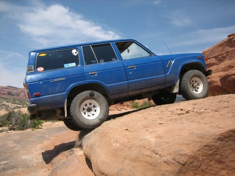

I have the same size on Toyota White Spoke wheels. I had them on stock chromes but now they're on 8" wide and I still get some rubbing. I suggest 10" wide which I understand avoids most of the rub.

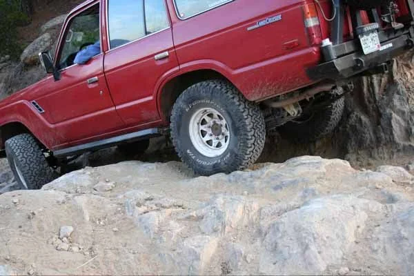

If you are ordering new rims, get some 15x8 steal wheelswith 2.5-3" BS (I think you can still order these from Summit, this has been discussed on here in several threads, just not recently.) I run 15x8.5's with 3.5BS and get just a little rubbing in the innner rear wheel well, which I have heard alot of people rub there. (Its not a big deal I cant tell it rubs except that you can see on the wheel well where it rubs.
Hope this helps.
