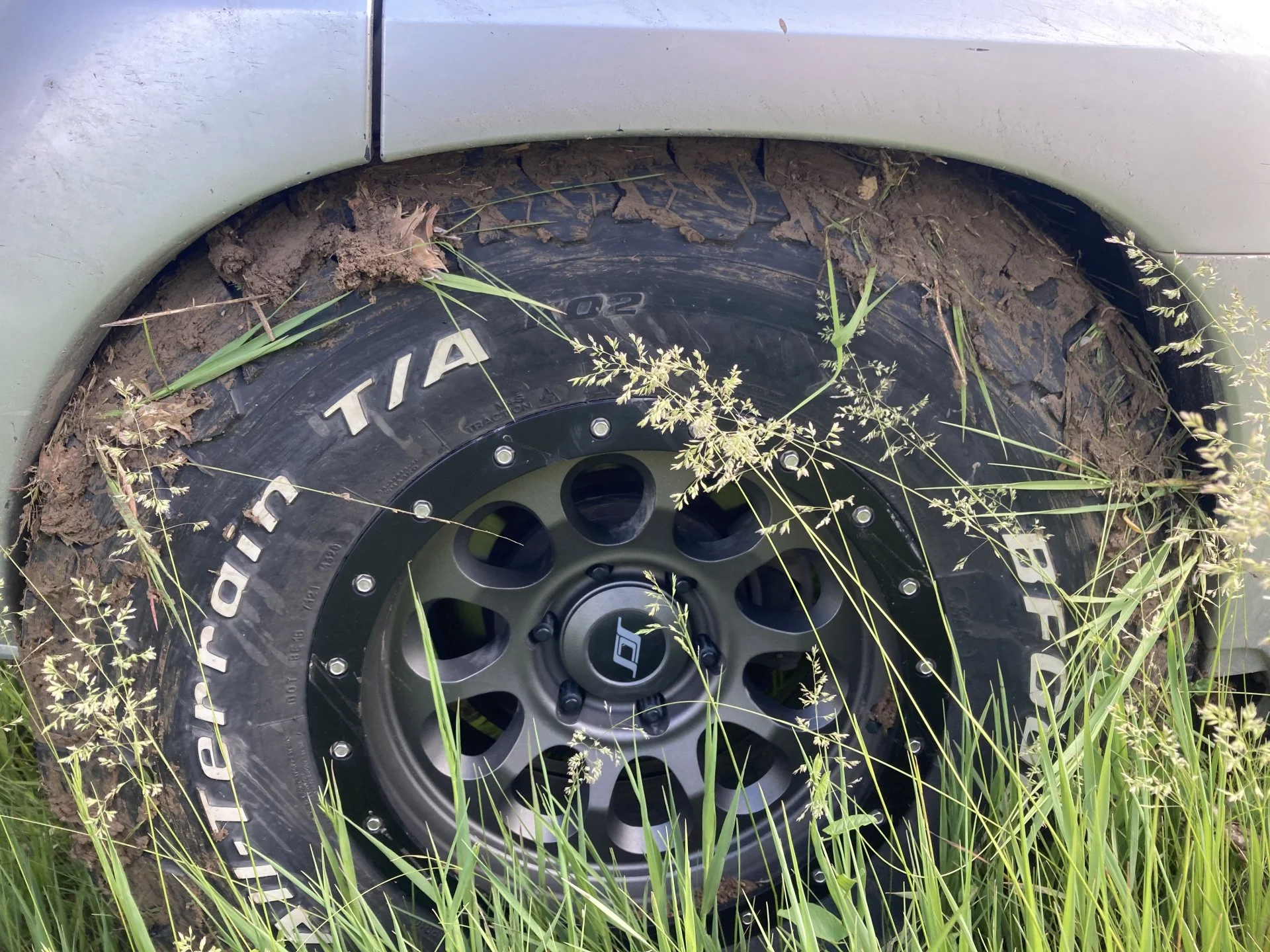

I’ve got some SCS BR6 -38’s on my GX. I like them alright, but I think I’m going to have to sell them. The -38 is killing me. The rear tires will not stuff. The scrub makes steering more difficult when aired down. Not to mention they are mud slingers & I live on dirt. Who runs 35” tires & where is the sweet spot in wheel offset?

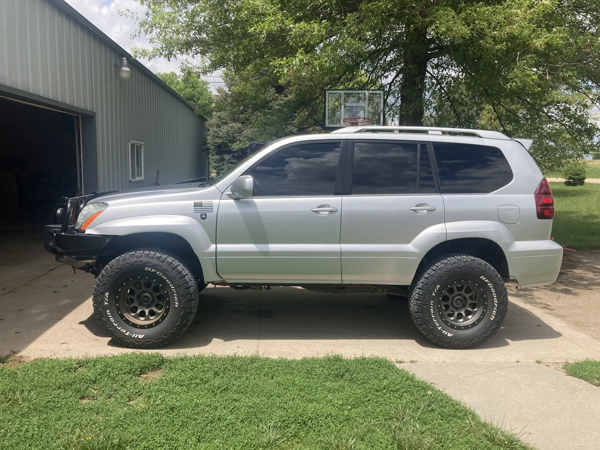

I put the -10’s on. Man the truck is so much narrower. Drives so much better on gravel. Does not pull all over the place. The rear tire stuffs nicely, but barley. I ordered some Method 701 Trail series wheels in a -12 offset. The stuff will be close in the rear but the lip can be adjusted (beat with a hammer) to clear if so. The -10’s just barely rubbed in the front on the sway bar. The -12’s should help this.
