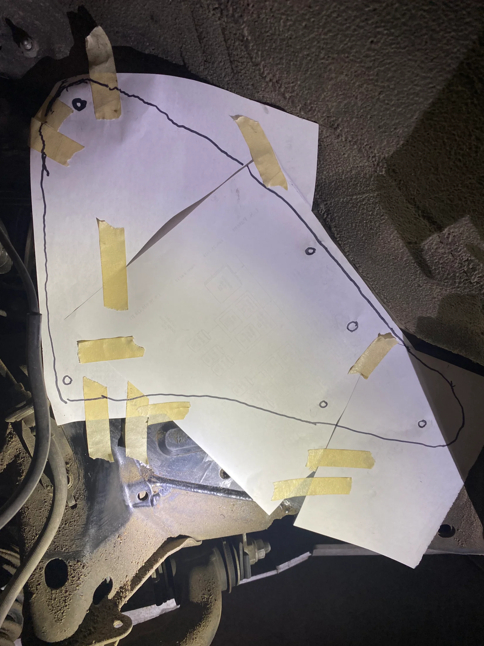

I ended up making my own following YouTuber GXBob. Bought a 1/16 rubber sheet 12”x4’, made a template, sketched an outline and cut. It was $20 for the rubber sheet and I should have enough for both wheels. Definitely seems a lot sturdier than the oem material.
