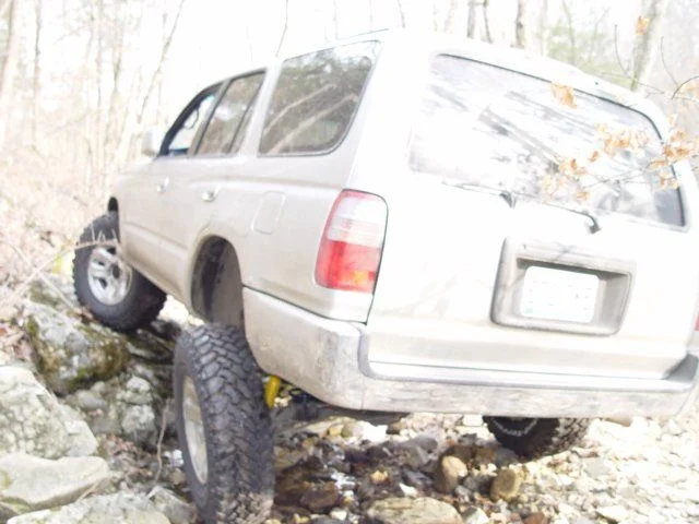

i've got a friend that wants to sell his 00' ready to go 40K on it...
its got some minor body damage and what have ya
this pic is from a few years ago but it still looks the same last time i saw it...
