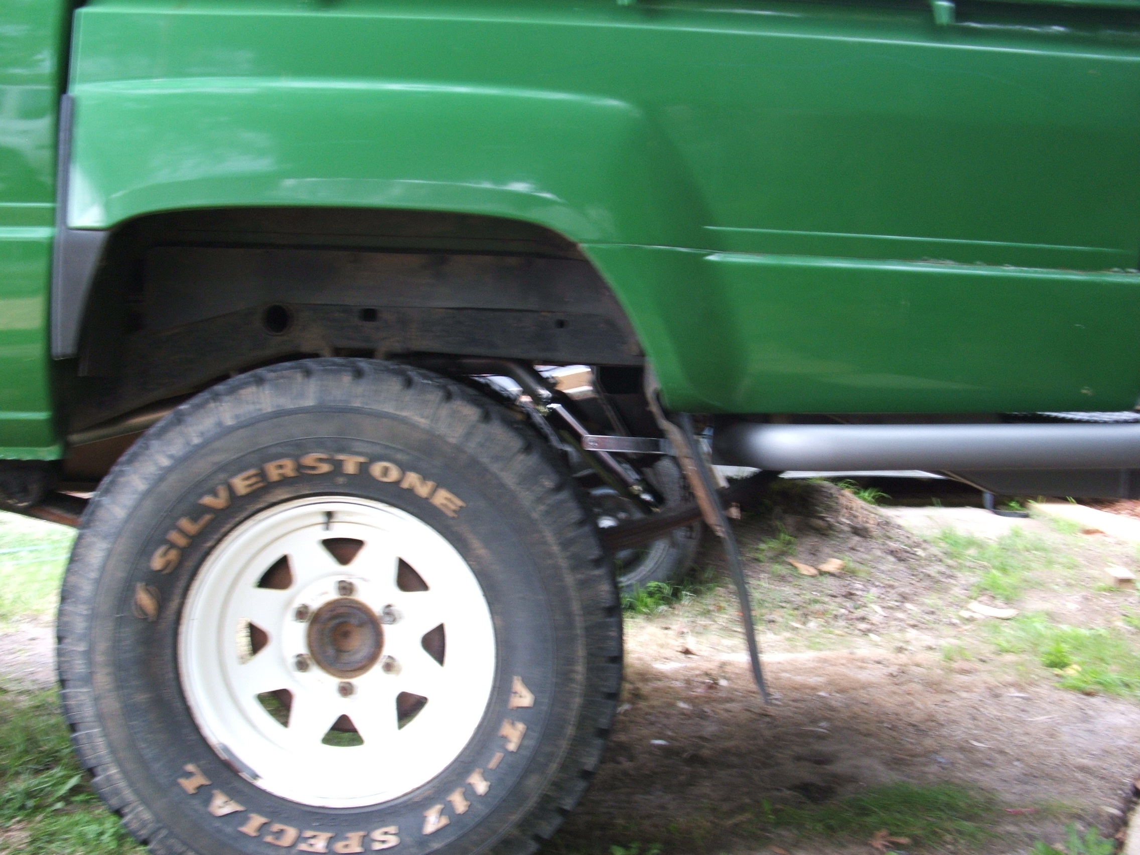

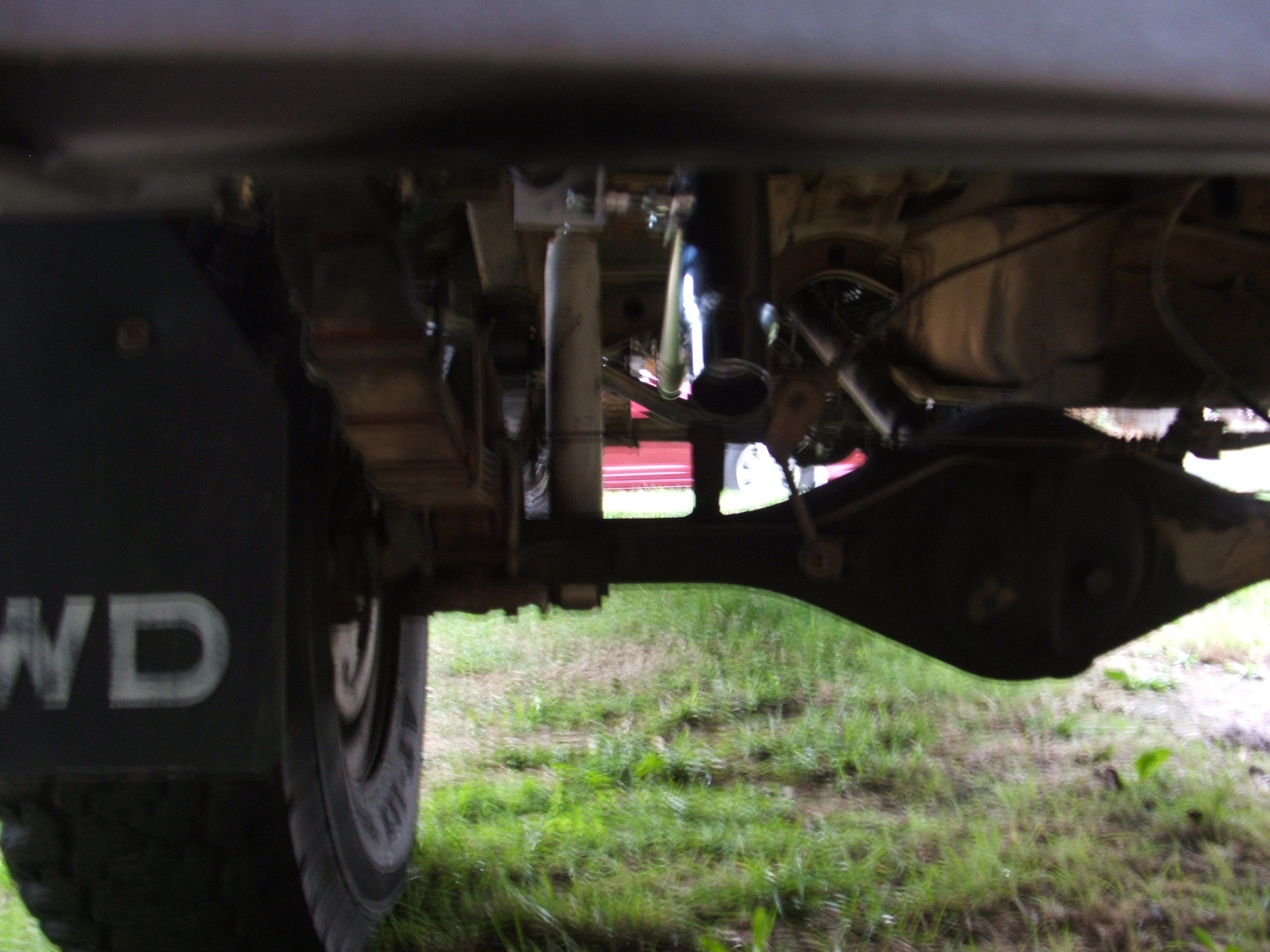

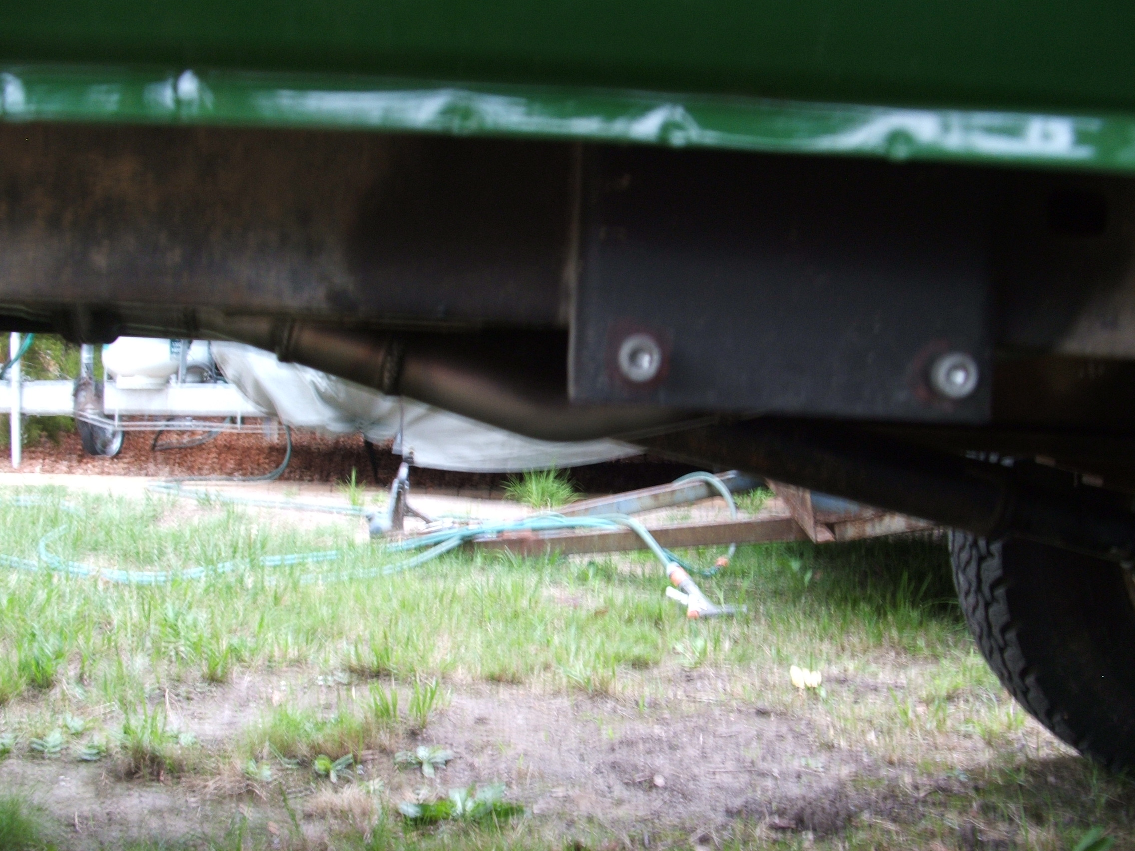

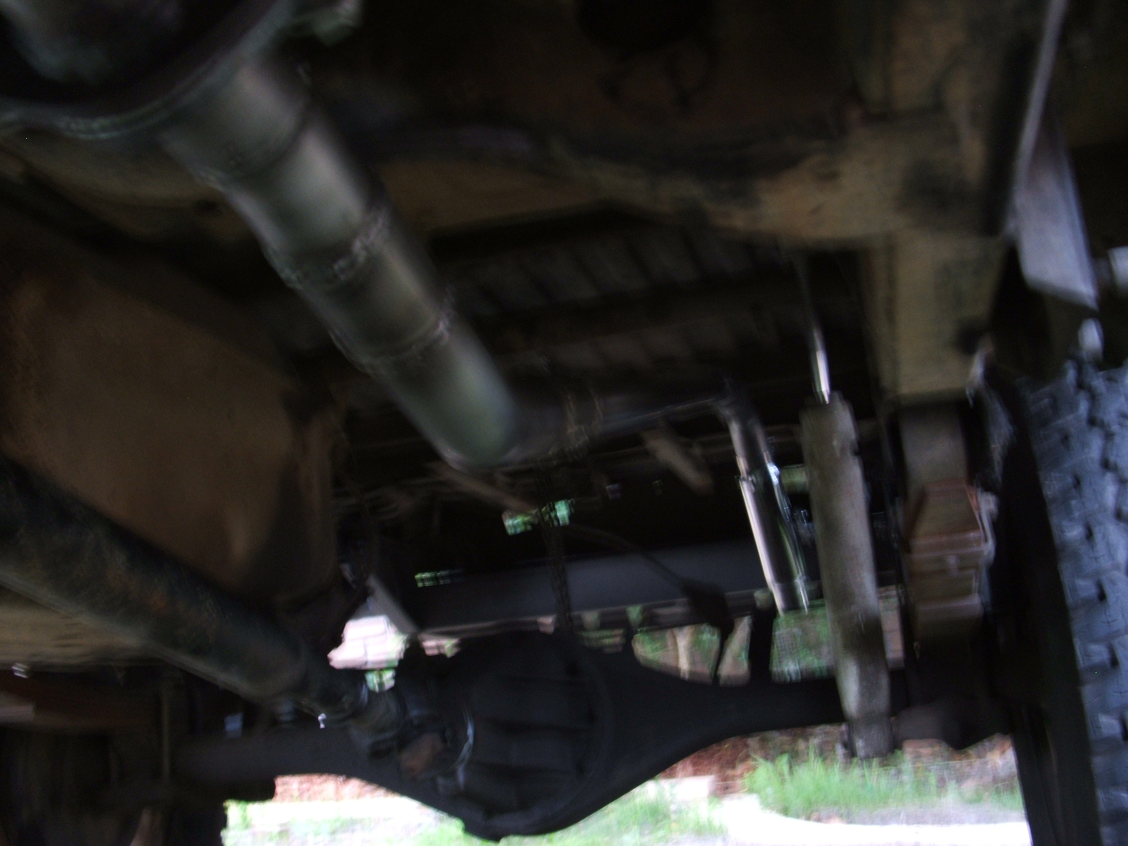

Here are awful photographs of my 1.5" schedule 5 pipe Exhaust with Motorcycle Silencer.
Notice that the Silencer's mounting strap is horizontal with the chassis and that the strap did not need to be cut down to affix to the wee bracket I made to utilise the original rubber hanger. It is hard to see but the lowest point of the exhaust is exactly at the same height as the sidestep bracket, fuel tank and across that point of the propeller shaft. The very tip of the silencer is inline with the bottom of the leaf spring.
I have driven around the local residential streets where it's all second and third gear between 1,500 and 2,500 RPM, and I have driven on two major arterial roads with 60km/h limits. In both situations I was amazed at how quiet it was, but I haven't wound the windows down yet.
Before fitment of this system I had run the car around the local residential streets without the secondary pipe fitted, where it sounded like a tractor or small earth-moving equipment on idle-up to run the hydraulics. I have also run the same design secondary pipe as my new setup but without the silencer, where the extra length and four bends made so much difference that the exhaust no longer emitted such a harsh tractor sound.
The bends used were a 15°(Down 15°), a 30°(Up 15°), a 15°(Parallel), and a 45°(Down 45°).
