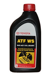

Thanks for the info and suggestions. Unfortunately I have to ask the stupid question that the rest are too embarrassed to ask. What is WS fluid?
I believe WS stands for Toyota "World Standard" transmission fluid.
FWIW, Amsoil shows their ATF (red label) is compatible with both Type III and Type IV. The WS is a lighter weight fluid that matches up with the Amsoil "Fuel Efficient" ATF (blue label).
