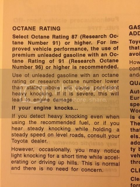

My 1999 LC calls for premium gas? Or is that sticker on the gas door just BS?

This is from my '03 owner's manual:
Either works. 92 gives slightly better mpg at a higher price. At best it neutralizes the cost delta. Zero reports of knocking on 87. Pretty sure it will run fine on turbid moonshine. It's not exactly a high strung performance engine.
The other difference between LC and LX is the adjustable steering column. If you have T-Rex length arms like me and don't enjoy driving like an Italian madman (arms straight out from the shoulder), you need a steering wheel than gets closer to you and the LC doesn't have that, at least in 2000 it didn't. I preferred the looks of the LC and was leery of AHC, but my 2000 has 172K and the AHC still works fine. YMMV.
As to premium vs. regular fuel: I had a '94 Z28 many moons ago and it's OM had the same verbage as above. The Z had 10:1 compression and a knock sensor (so the motor wouldn't destroy itself). I tested 87 vs 93 octane. The 87 was cheaper, but went through the motor faster with noticeably less zing on acceleration. I stuck with 93- it was cheaper to run the car that way and of course better performance. I'd do it again on anything with fuel "options" and high compression.
