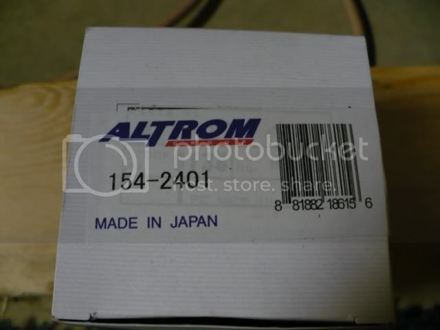

would you be so kind as to give us the product# for the 82*c t-stat and where did you purchase it?
thanks, BIG :cheers:
I just went to NAPA for it. Altrom brand part # 154-2401 (just in case the picture doesn't stay on photobucket)
Great info! Thanks a ton. Could I get the part number for the 88* t-stat too? You should put those numbers up on the part numbers sticky. When you went into NAPA, how did they locate the right part? Just told them the engine year and they looked it up? Thanks.

That part number is as you mention for a toyota part. I don't have an after market part number for the 88*c t-stat sorry. The one I have was/is stock.
Yes, I went into Napa and told them that I needed an 82*c t-stat for a 83 toyota landcruiser with the 3B motor, 3.4L diesel. The info the better.
Well, if anyone has an aftermarket (or even toyota) part number for the 88* tstat, I'm pretty sure that's the one I'm after. I'm pretty sure the one on the part number thread is an 82* tstat, but I could be wrong. Thanks for the info guys!
