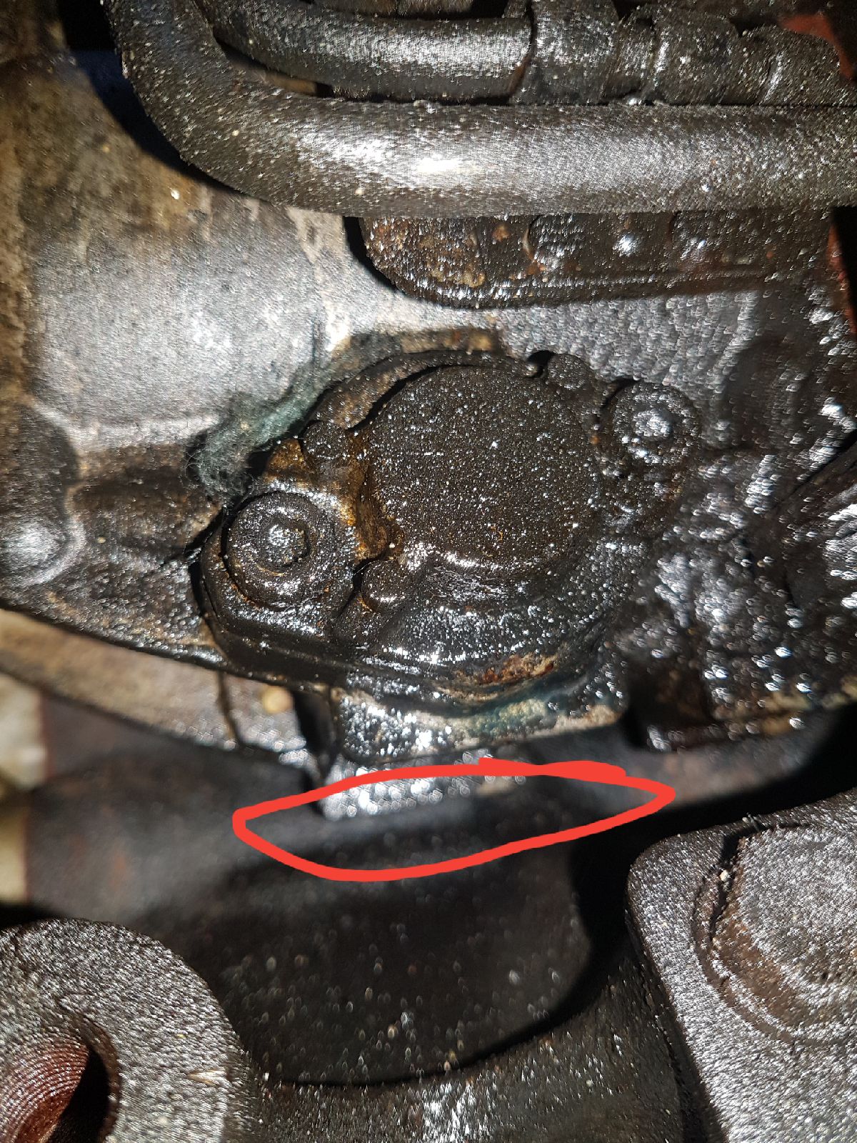

I recently bought a 1991 Toyota Land cruiser Prado EX5 with the 2L-TE engine.
Since purchased I did an oil change and changed the air filter
It ran OK for about a week then started leaking coolant fluid from the bottom of the part attached on the ** Passenger side (its a right hand drive) of the engine...I cannot figure out what is leaking and what the part is...My best guess is its a gasket that's leaking...
Any ideas on what it is and how to fix it would be greatly appreciated.
You may have a Prado but it is a 70 series. We call that the left hand side of the car/engine. With so many LH and RH vehicles, passenger/driver side is confusing.
Looks like the injection pump, but post a bigger pic in the diesel section. Lots of 2LT II nuts there.
Clean it all down and watch where the leak comes from.
Sorry about taking so long to reply, I ran out of time so I ended up just taking it in to a shop. Hopefully they can figure it out; I have very limited mechanical knowledge and even less tools.
Thanks for info on it being a 70 series, it's pretty confusing trying to figure out which which one I had.
Edit: You were right! Shop just called, it's the fuel injector pump leaking
