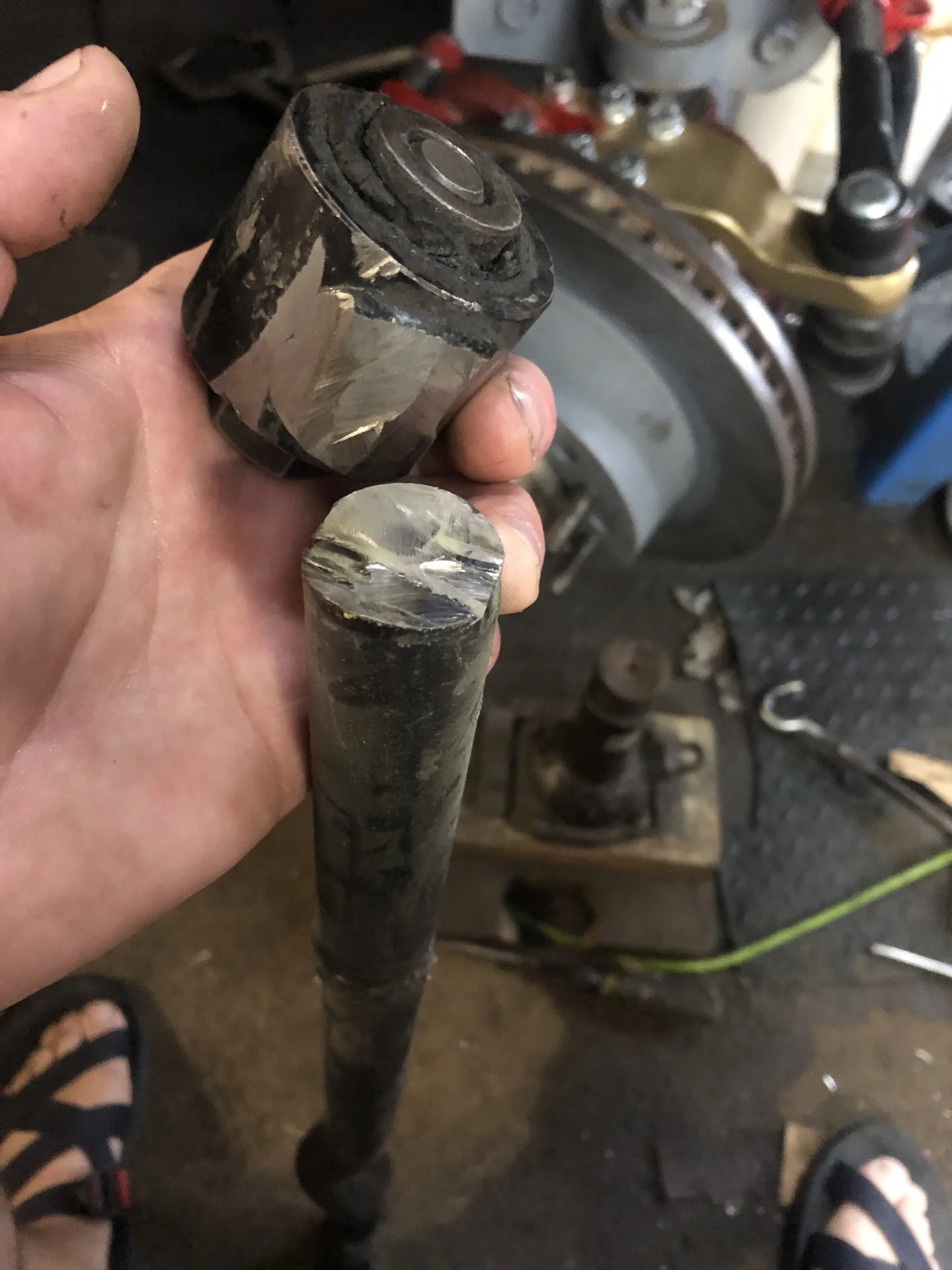

Appears to be, made another cut further in. Measures 1.25”
I’m really wanting to avoid under building it and creating components where death wobble can rear its ugly face. I guess either I’ll go with 1.25” solid bar or heavy wall 1.5” tube
