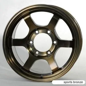

Rota makes a 16x8 +20mm wheel called Grid Off-road. Basically a knock off of Ray Engineering wheel at a fraction of the price. Quality is probably a step below OEM as well but might be good enough for your purposes. +20mm offset would be roughly the equivalent of using a 1.5" wheel spacer.
Yeah, despite the name, I would not rock those offroad. Also 1.5" spacer could get you in trouble depending on the tire choice and suspension.
Rota. hmmm
