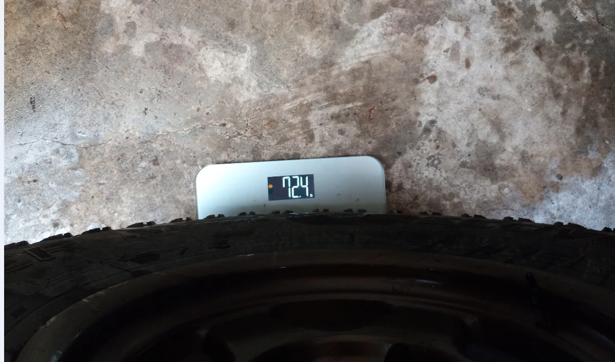

I went in the opposite direction and reduced wheel and tire weight. Sill running eRated tires with SCS F5 rims.
Stock wheels with Nitto Terra Grapler tires 285/75R16 weigh in at just over 75lbs.
SCS F5 wheels with Cooper Evo MT 285/75/R16 eRated at 72.4 LBS No complaints with braking, accelleration, or hills. I drive in the mountains with OD turned off.
