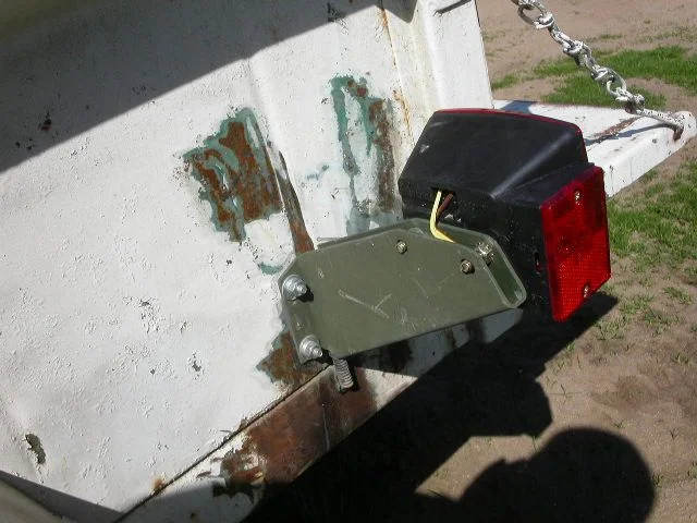

I replaced the broken little round lights in the rear with some army surplus mounts and some common trailer lights.

My suggestion is to reconsider your mounting of the light brackets.
These lights are quite vulnerable to trail and other damage. I've busted my plastic housings a couple of times now. Your brackets are bolted to the thin sheet metal. That invites bending the tub or tearing the bolts out. On the military trailers the light brackets are bolted to the heavier frame.
