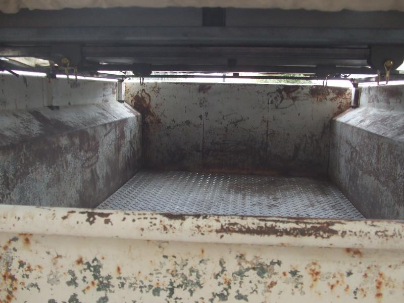

Next modification was the cargo area. I have a Roof Top Tent but really tired of beating it up on the trail while it was mounted on the roof.
I utilized the stake pockets so I could remove the carriage it I wanted to.
I added 3 rubber mounts on the cross bars. The rubber mounts will help support the middle and ends of the tent while bouncing down trails.
I wanted to be able to access the cargo so I pinned it on both sides. I can lift and tip from either side. Idea was inspired by Andre Dieselcruiserhead's while checking out his trailer build during cruise MOAB.
