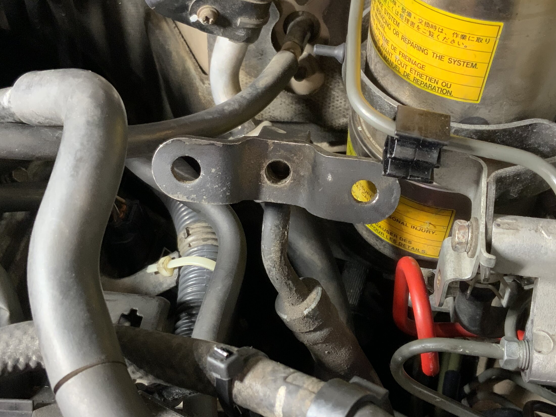

What is this and where does it mount to?
Dec 16, 2009
8
90
Denver, Colorado

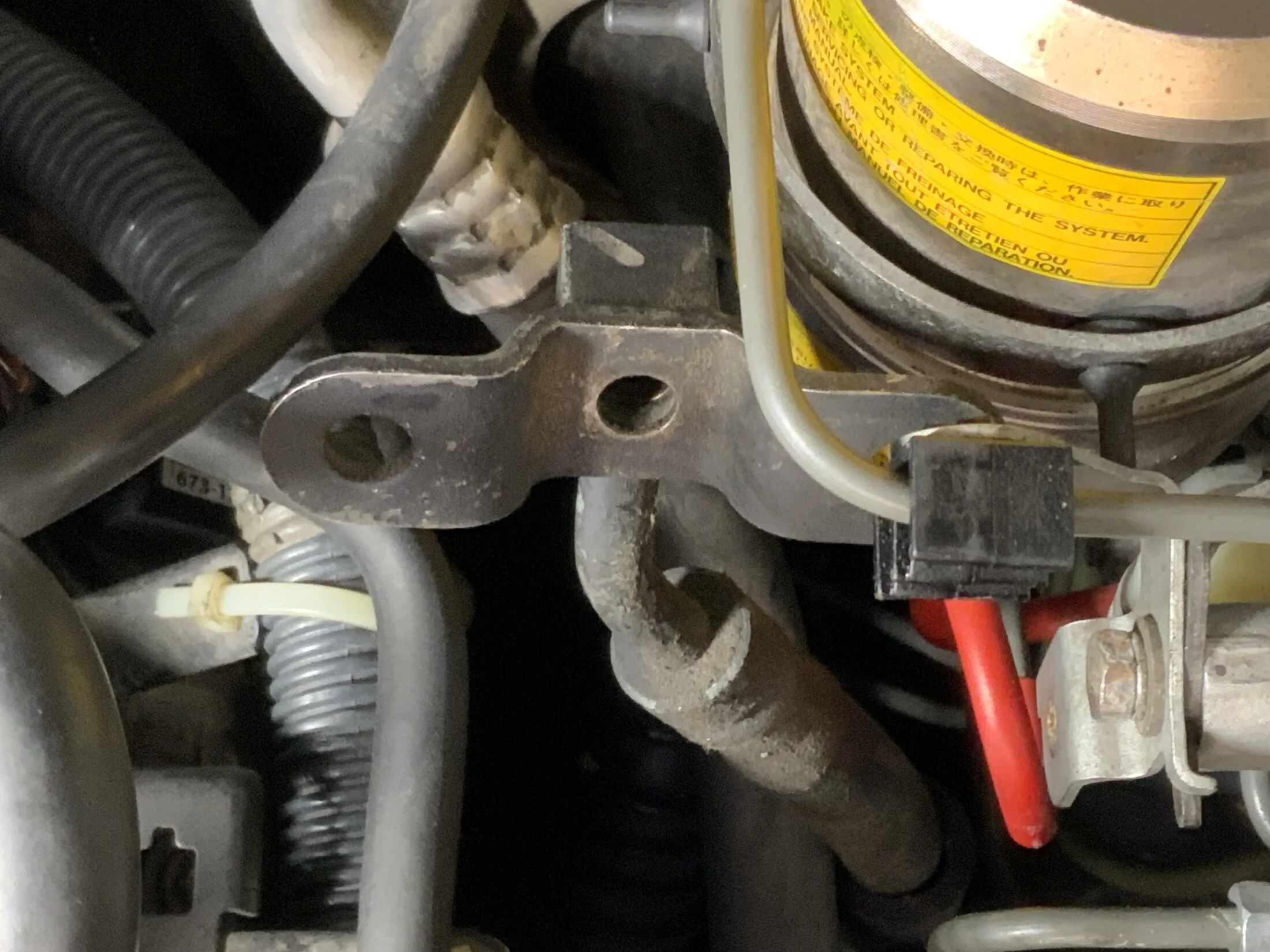

I was replacing the valve gasket and noticed this hose and mount. I don’t remember removing this piece. Last time it was serviced was when a power steering rack was replaced by a mechanic.
Any info would be appreciated, a picture would be even better
1999 lx 470. AHC was Removed, does anyone know where this would mount to? Don’t want to have it dangling inside engine area
Thanks
I don’t remember removing any AHC components on that side, do you know where it would mount t to?
That mounts to the AHC 'shock' itself, right on top.
