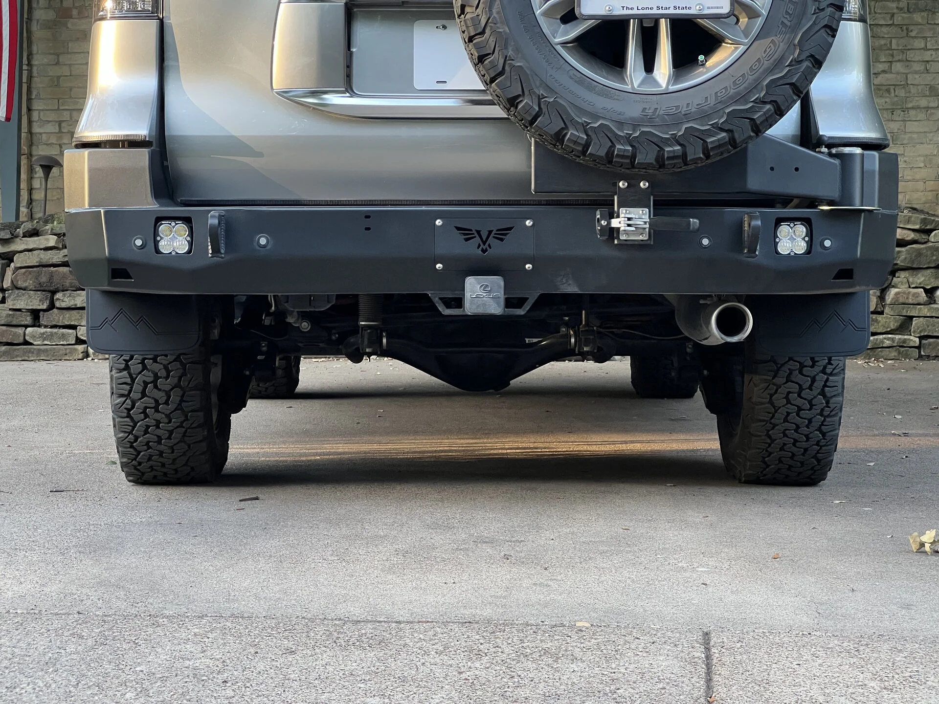

I currently run 265/65/18s on my 2022GX 460 and am looking to remove my victory 4x4 tire carrier and return to running the spare underneath my vehicle. While I know that a 265/65/18 will fit, what tallest tire size can I go to? 70... 75... 80...?
Also, I don't have the hitch down there, but I do have the victory rear bumper, which you can see in the photo.
