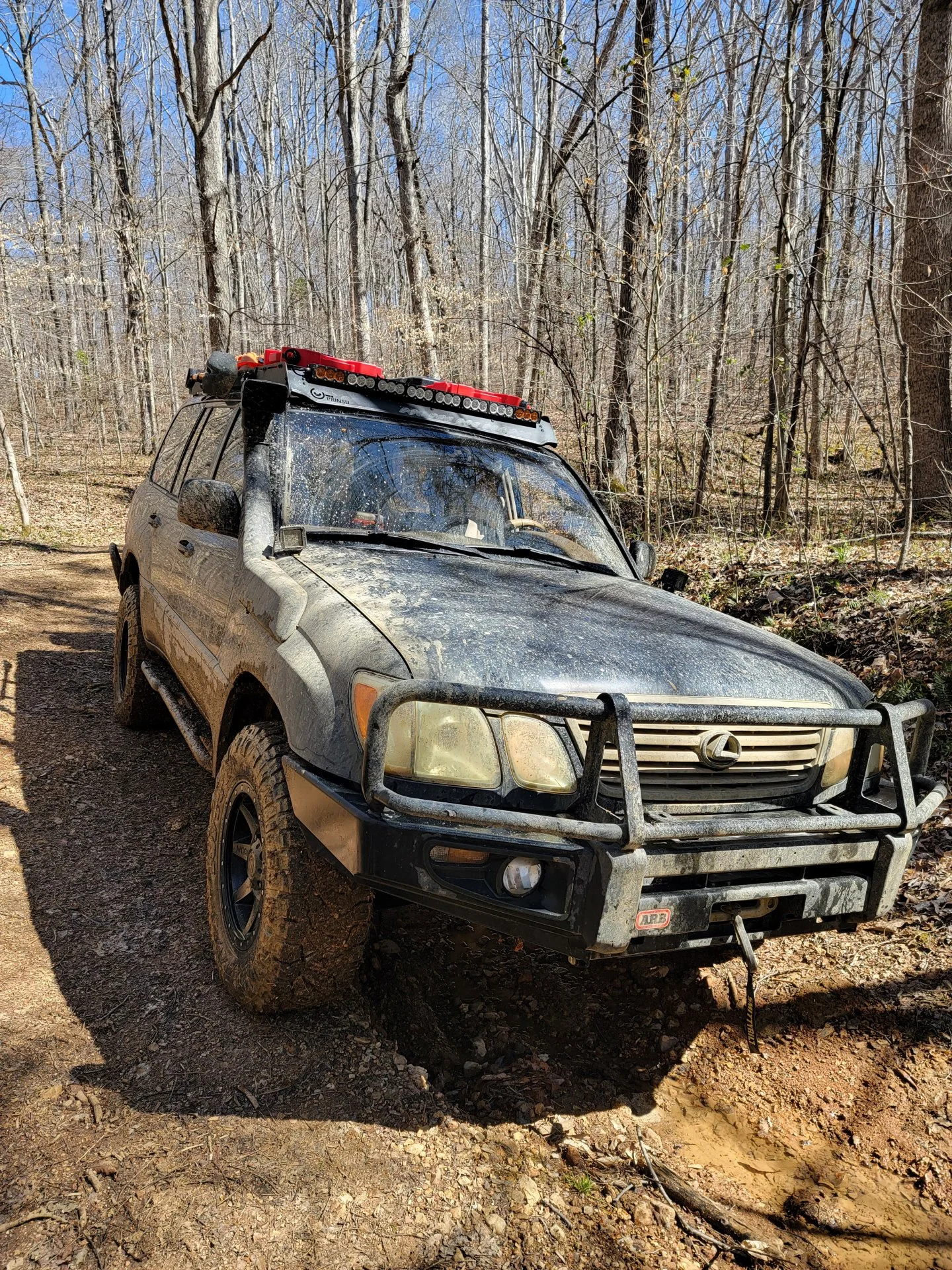

On my 100 (that the son mostly drives) we have 35" tires, true high lift jack, Warn winch, Arb compressor, stock center locker, arb front bumper, coastal off road double swing rear bumper (not happy with where I placed the high lift as it requires taking off spare to access; I would be less happy with the jack location if I did not have the winch) with two 5 gallon tanks (I believe the gas tank in spare tire holds ~12 gallons for a total of 17 gallons beyond stock fuel capacity), King shocks with heavy OME springs, extra fuel tank in spare location, custom sliders that are not that good but double as a step (on my list to upgrade), Gobi Rack.
I have a no-brand snorkel to add.
I need better sliders and I am missing at least one skid.
I am looking into solar for the front hood.
Do most people need the items we have? No. I believe almost everyone could do everything they want with the 5 items I listed for starting. However there are some people who push harder terrain and/or more remote areas. For those people, they will push whatever vehicle they have and will constantly want more (my son has destroyed 3 axels (one solid (80 series), one left and one right) in less than 18 months). Dussy Ershiem, Rubicon, Fordyce Creek Trail, etc. require more than the 5 items I list as starters (but 95%+ of all trails can be done with those 5 items).
