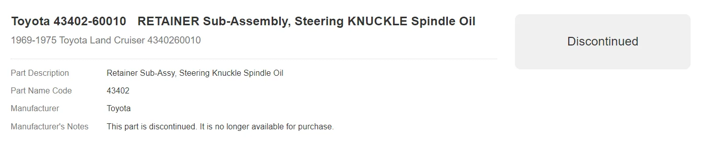

Knuckle Bearing Spindles don't rotate but only, what, 50 Degrees? And certainly not at high speed.
Was there a sealed knuckle that took oil instead of grease at one time?
Seems like that would be a PITA to keep sealed.
