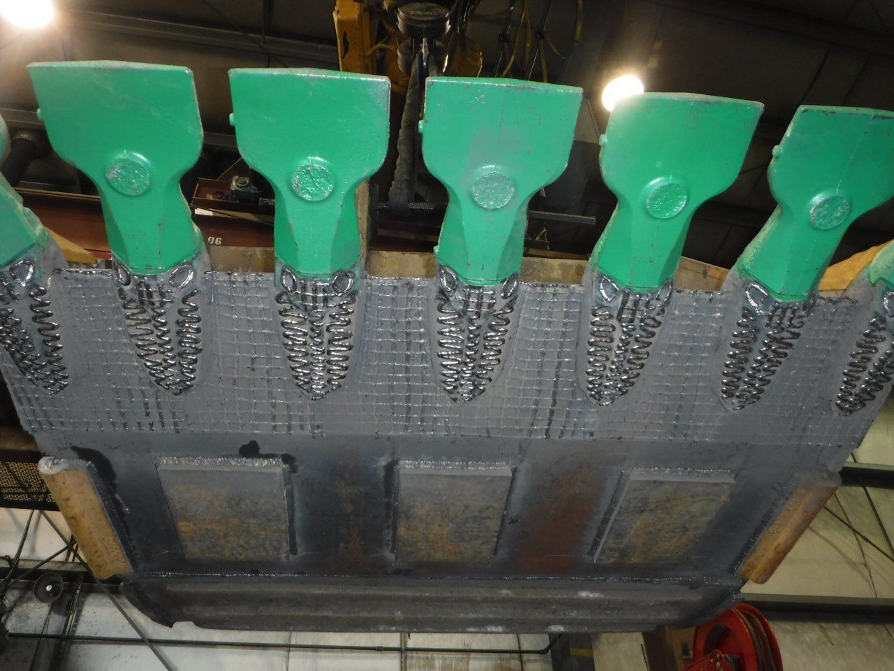

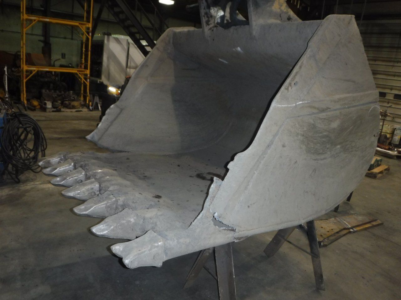

someone asked me awhile ago what I did at work. It is easier for me to show in pics than to try and explain.

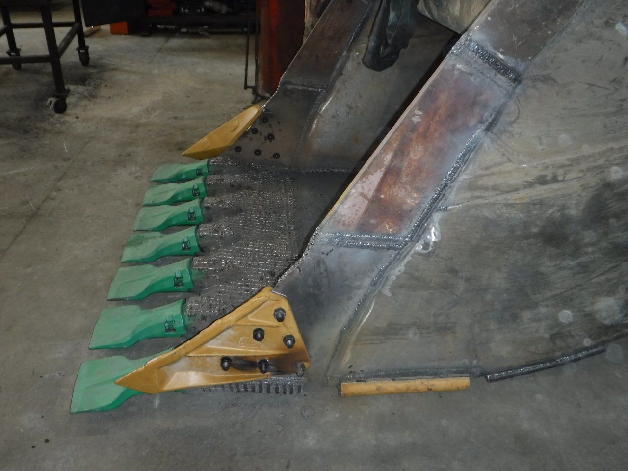

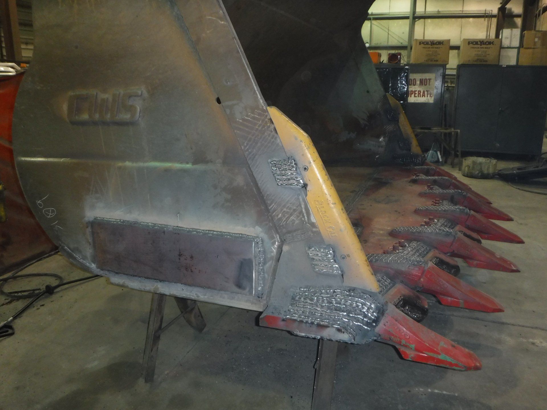

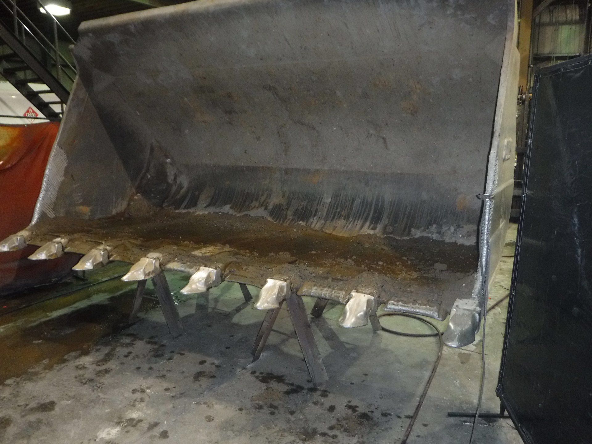

I take this and rebuild it.

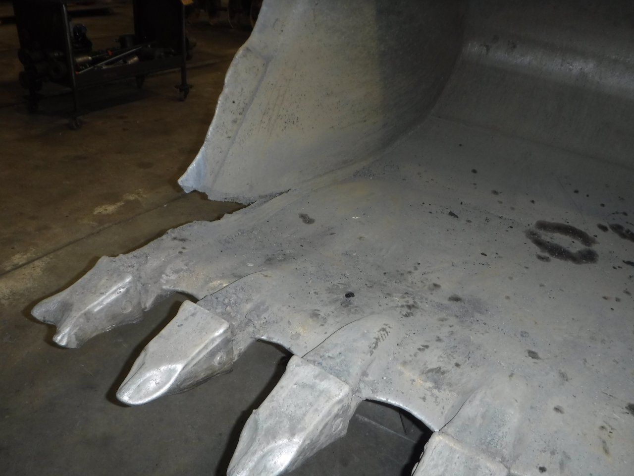

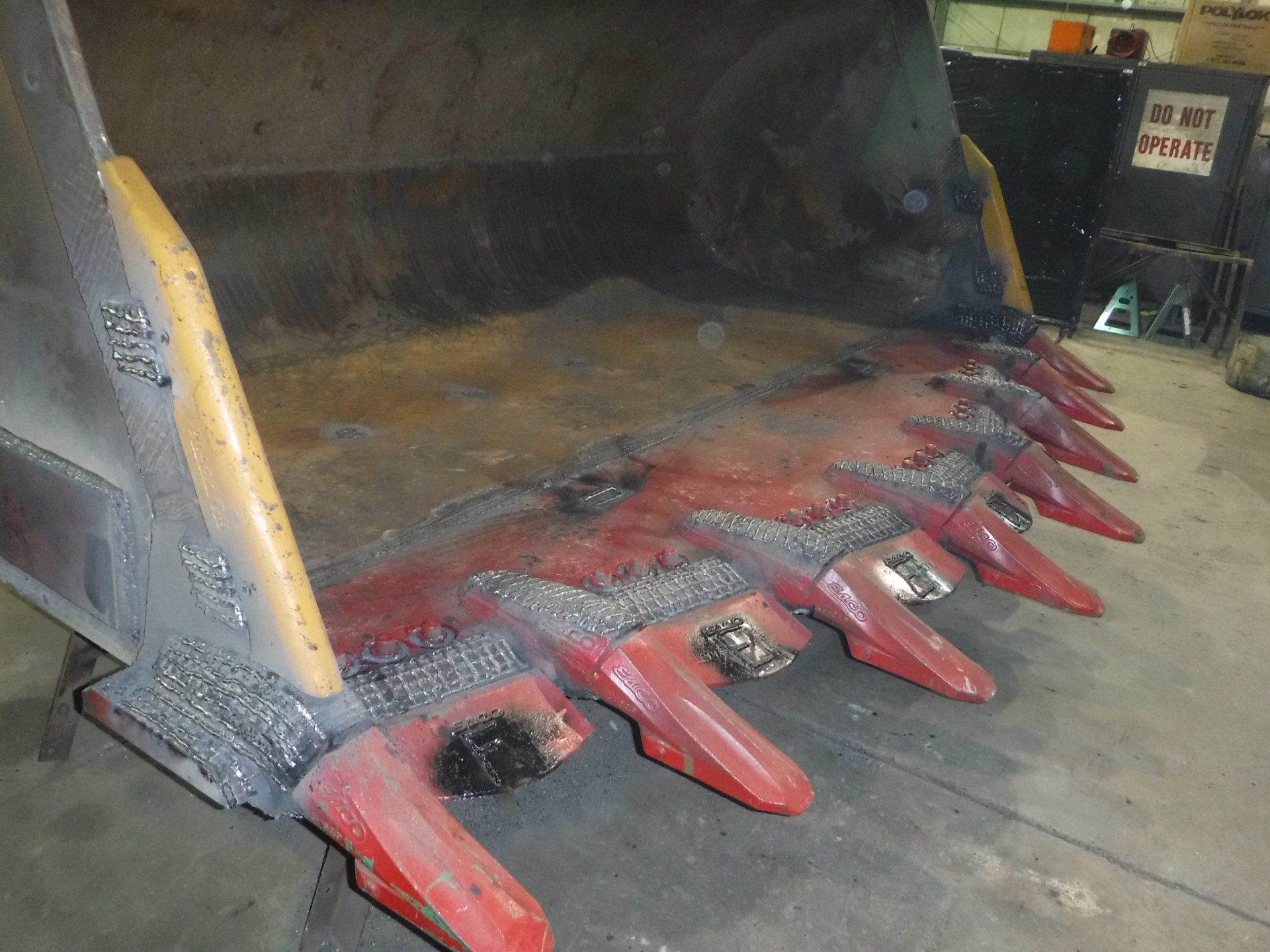

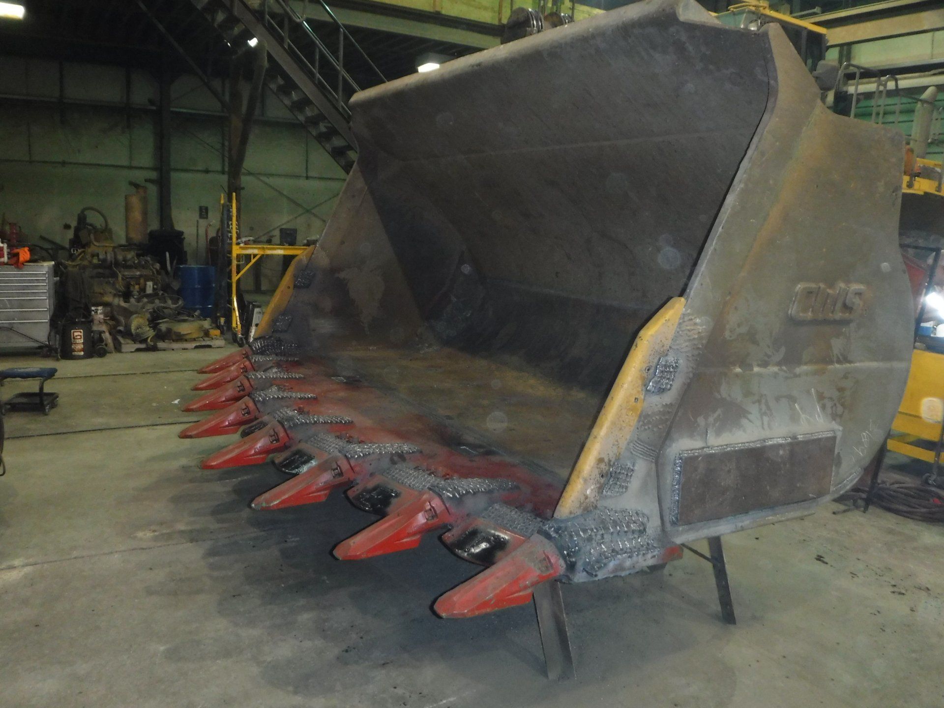

and this is what it looks like when I'm done.

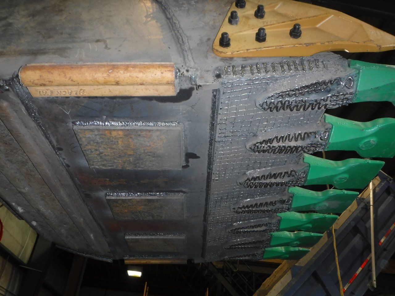

some of the hardfacing and wear plates underneath
That's some serious teeth on that bad boy! Nice going, Paul!
Paul you have all of the fun.

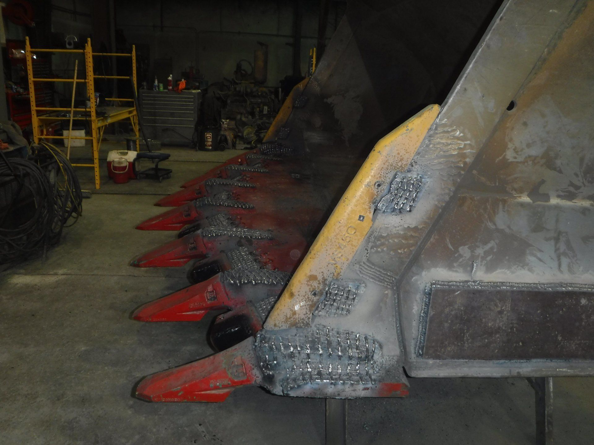

working on a WA600 bucket now pics will be later on in January before I'm done with it.

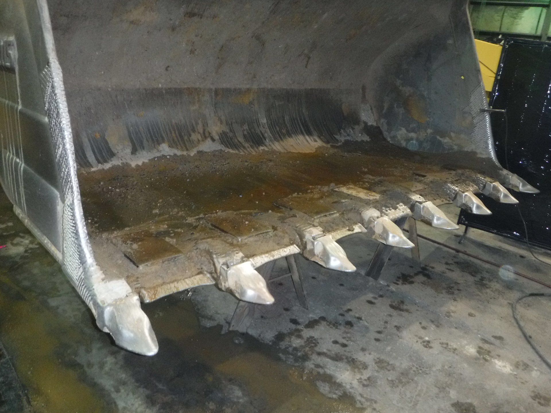

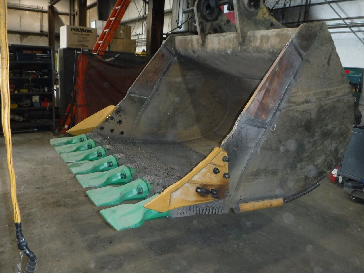

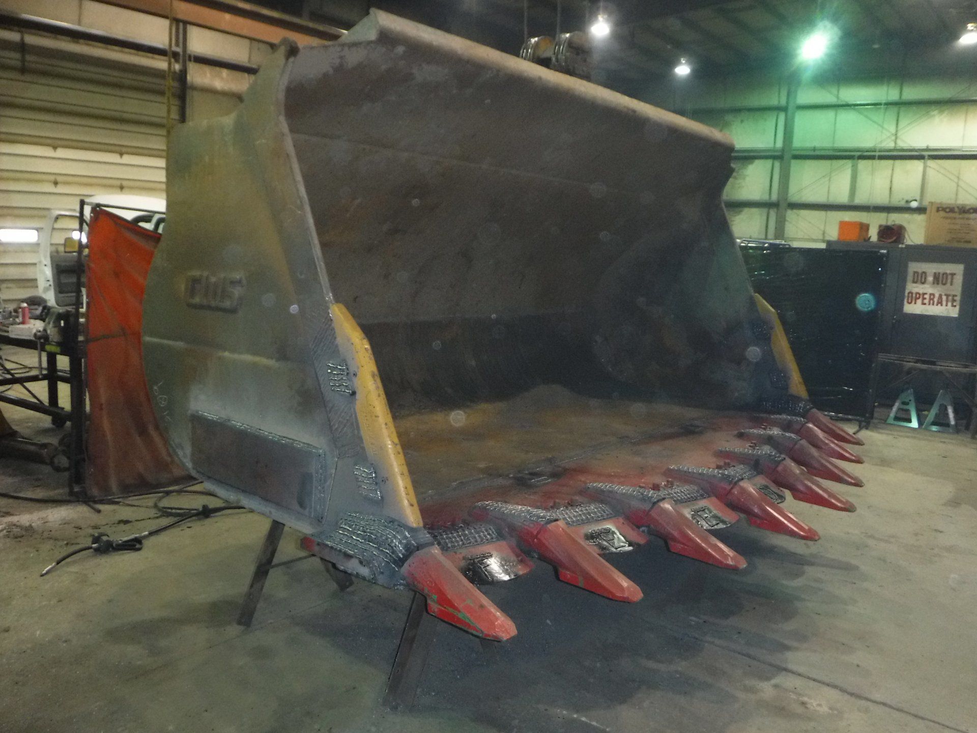

Here is the latest project, before pics:

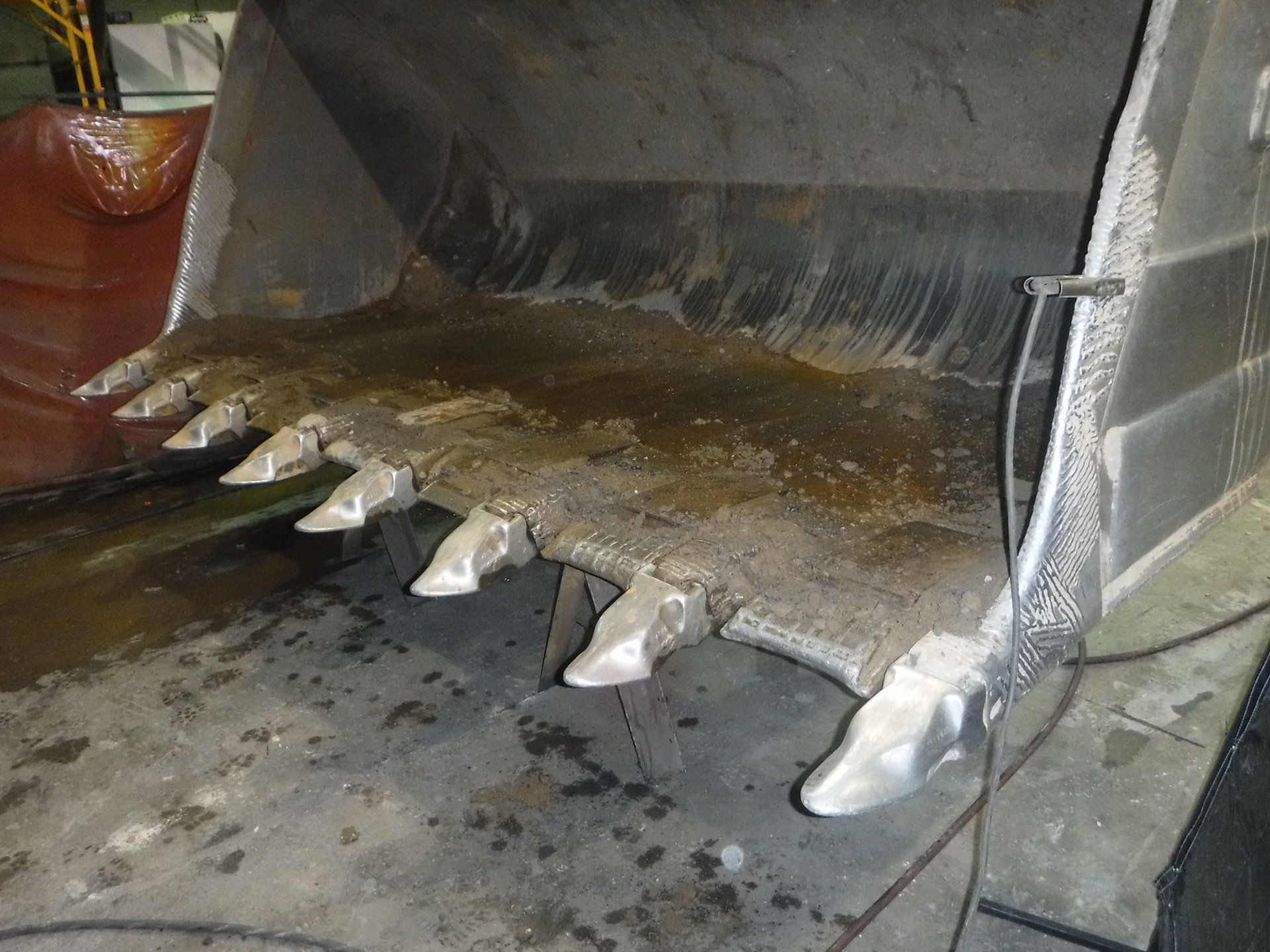

after pics:
replaced frog with a spade nose frog, with replaceable segments, replace lower sides of bucket, replace main structure plates on bottom of bucket, add wear plates, add side wear guards, hardface wear areas
4+ spools of 1/16" dual shield wire at 33lbs a spool.
ready for a few more years of service
Wow! That loader is big-time!
Hi, Great work. I’m amazed those saw horses can hold that much weight. Mike
