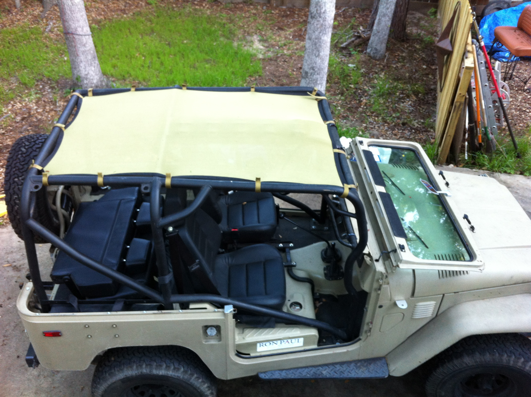

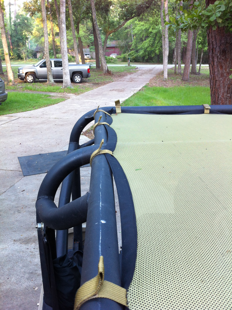

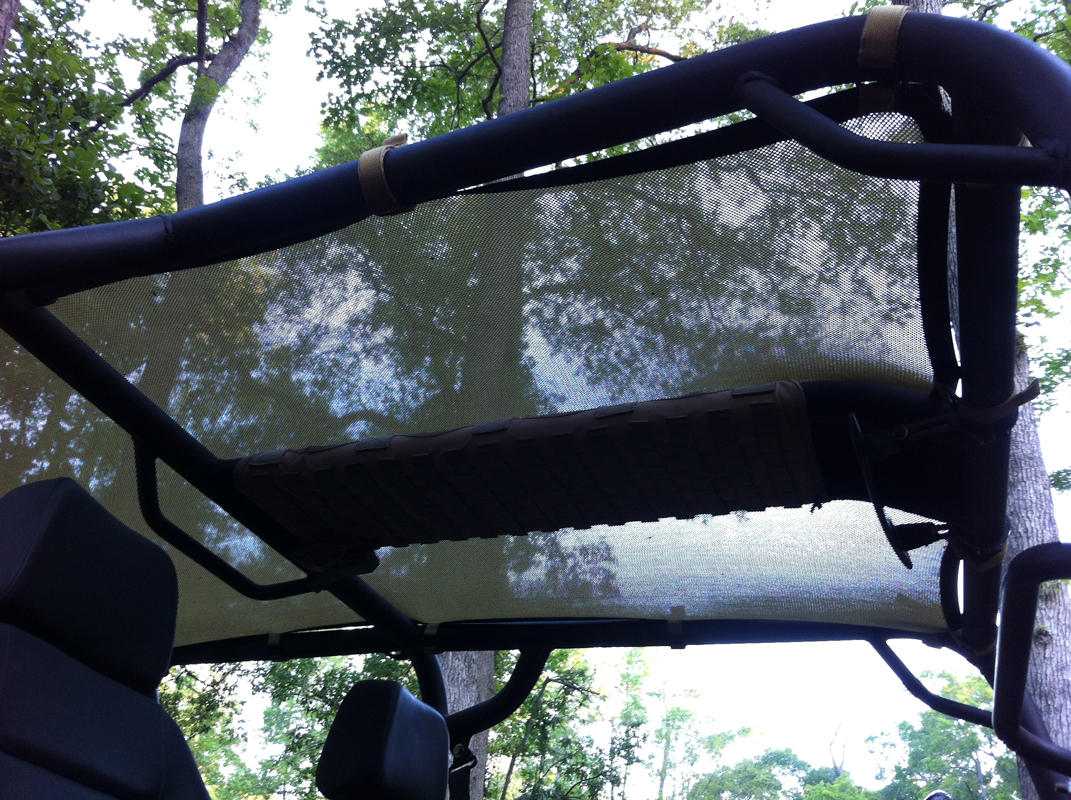

First I made a sun shade top for when we are running the FJ40 with the hard and soft top off, so we can have the windscreen down and still have some prtection against direct sun here in Texas. It turned out very nice. I used some Mil Spec. mesh, edged with backpack weight 1" webbing and sdecured with velcro strapes. It fits tight and works great. It does not flap, and is just a s quite as running with the tops off altogether.

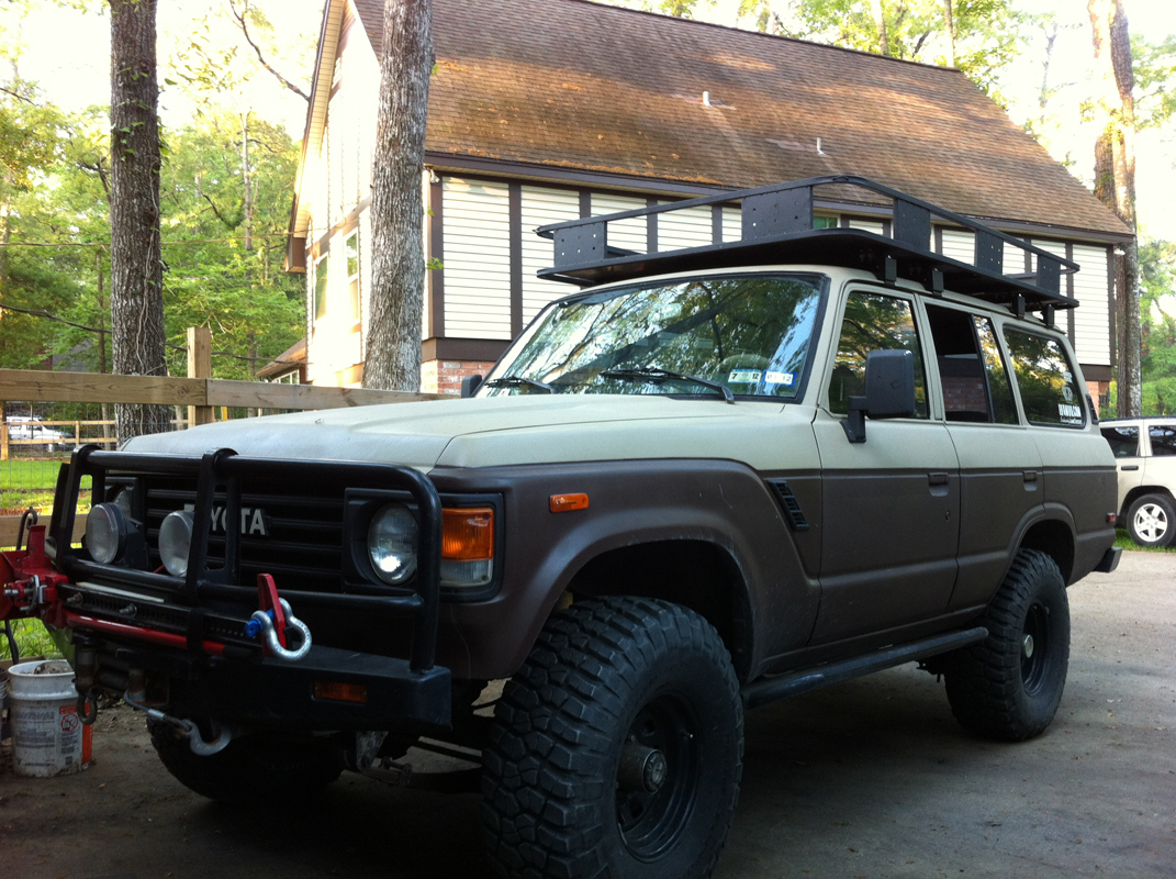

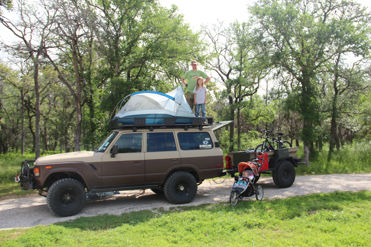

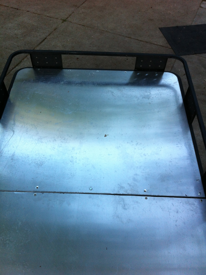

I also made momma a roof rack for her FJ60. We built it a bit larger than the standard sizes as this is for us to camp in with our tent. It's total height is 8" and we are using the mounting feet from Diamond Rax. It's out of 1"x1"X.06" sqaure tubing with a 1/8" aluminum floor, which turns out to be a great barrier against the sun, the inside of the truck stays cool with the windows down even in last weekends high 80's tempature.

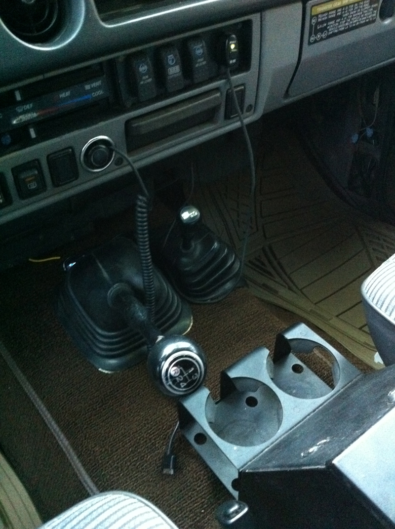

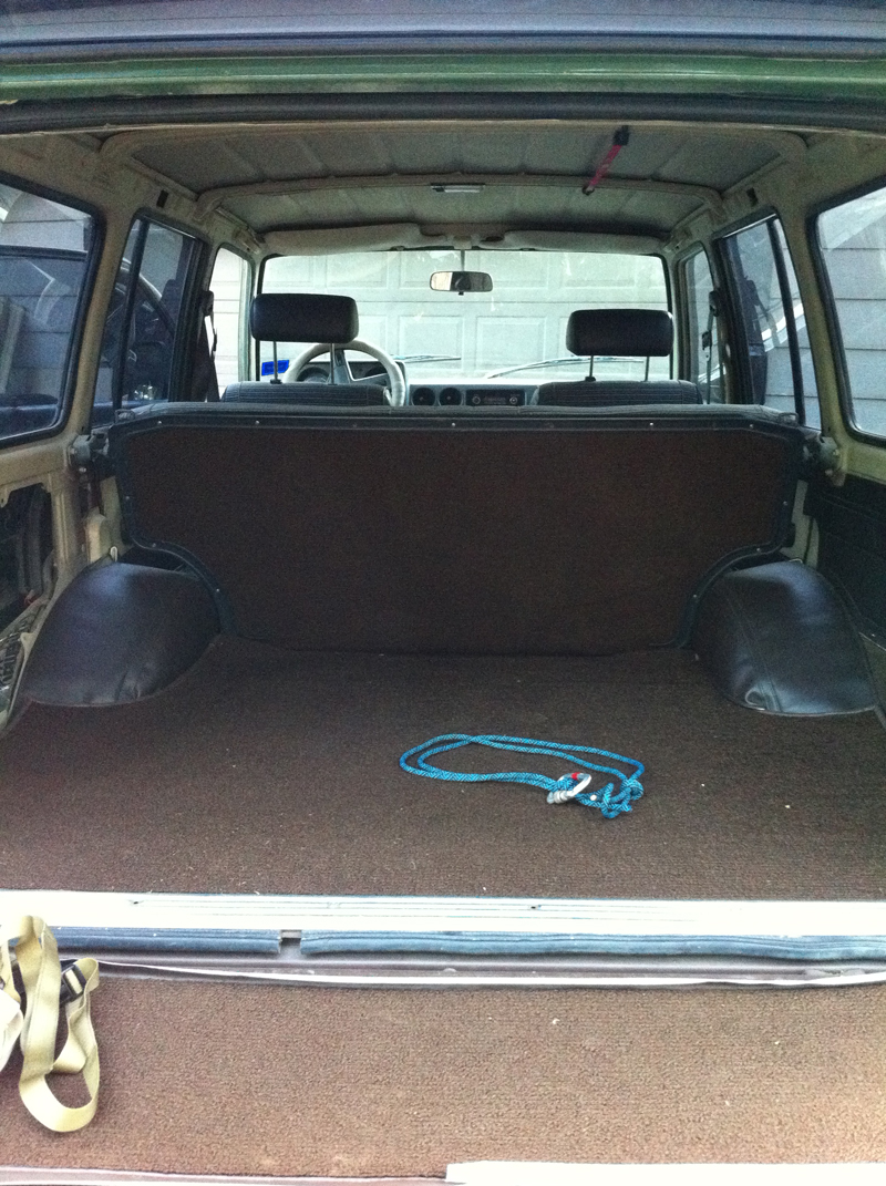

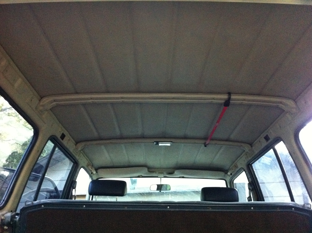

We also bought a carpet kit from SOR and redid the interior of our FJ60. The carpet looks great and covers up all the Dynamat we installed. We left out the headliner for convinence issues but we purchased complete carpet with tailgate, wheel well covers, new seat cushion foam and vinyl seat covers, new door panels to match the interiorbrown which we got from Proffitts Cruisers and door hardwear. The FJ60 also has a new modern sheet of glass for the windshield.
Oh yeah, we also did a rattle can two tone paint job on the FJ60... the previous paint was peeling and flaking

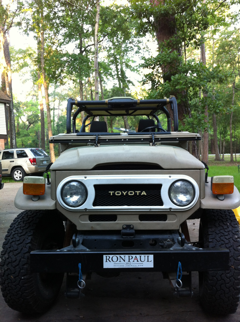

lice ron paul sticker!!!
I mean nice
ouroutdoorfamily said:
every Landcruiser needs a Ron Paul 2012 sticker, lol
Or two lol. I want the Hawaiian Ron Paul sticker I saw in Maui "Shaka Ron Paul"

Outdoorfamily,
Great job on the sun shade. Is that a Metal Tech family cage or one made by someone else? Very cool look and just in time for the heat!
