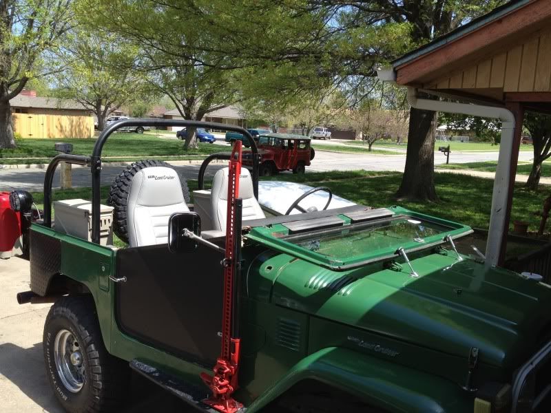

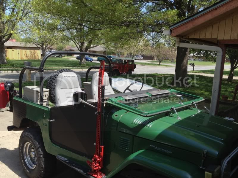

Got the 76 ready for summertime!
Nice! Just curious, do you leave the Hi Jack mounted? Or take it off when not wheeling? Mine is 60" and looks like a flag pole mounted on the step. May put mine on the roof rack.

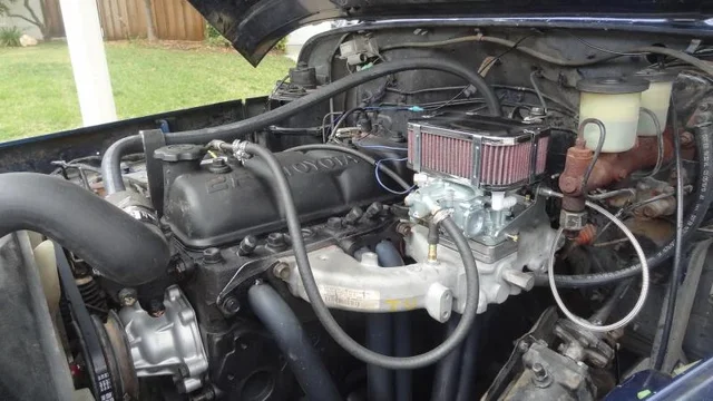

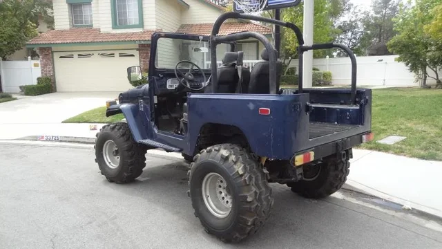

Big Blue came home!!!
After 3 months at my buddy's shop, and a bill that I thought would never end, Big Blue ('75 FJ40) came home to daddy.
Took it in in December, needing a major tune up, new carb and work on the front end. After learning that my original 2F was only running on 2 cylinders, the focus was to replace the engine. Because I want to try to keep it all stock, we did alot of web surfing and found a 2F in New Hampshire for $1200. Shipped it out here to So. Cal, got a new carb. Intake manifold was accidently thrown in with the scrap metal, so my buddy bought a new one from SOR. Headers were wasted when trying to take them off the motor so I had to order a 6-in-1 from Man-a-Fre. New water pump, new tie rod ends, new battery, new belt, few new wires and we are good to go for a little while...until I tackle a new radiator, steering box rebuild and new Mean Green alternator and starter. hahahaha. Good times!
1) I'd shorten your fuel supply line before it sags down and touches the header.:eek: Had it happen to a clutch line once... Much worse with a fuel line.
2) Steering looks scary.
3) Front end could benefit from a cut and turn to improve pinion angles, and also castor angle. Does it tend to dart around the road when you hit bumps?
4) Parts at SOR are priced like they're gold plated... I'd recomend Marks Off Road, the classifieds, or other vendors here on mud for parts you need.
Installed longer 6 inch shackles and 6 degree castor shims.
Went from 4 inch shakles and no castor shims......Man what a difference in the way it steers!!!!!
I defintely have to address the steering for sure. Before they added the tie rod ends and steering stabilizer, it was white knuckle driving all the way for me. This is a temporary band-aid fix until I get to replacing the steering linkage and rebuild the steering box. My buddy recommended the bushings on the leaf springs get replaced as well.
Any links you can lead me to for steering linkage? Where can I find parts for hi steer? I am a semi newbie at this, so please bear with me.
Many sources. Call Marlin (crawler) or Grorge at Valley Hybrids, or 4x4 Labs or any other reputable vendor on this board. Many different options but if I were you I would not drive it like that.. My 2cents.... Use the search function..
I leave the jack mounted. With the windshield up it doesn't seem so tall. A 60" jack is a tall one for sure.
