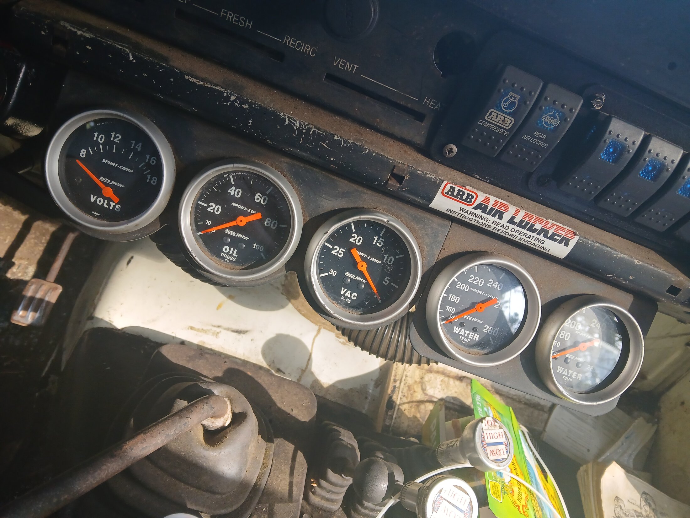

New waterpump, which I got WITH the oilcooler option. I don't run a oilcooler so I used that extra port to shove a watertemp sender into. So now, if it works, I'll have 2 mechanical watertemp gauges, measuring the head and now pump temps, and the stock gauge. Then I put in my new radiator.
