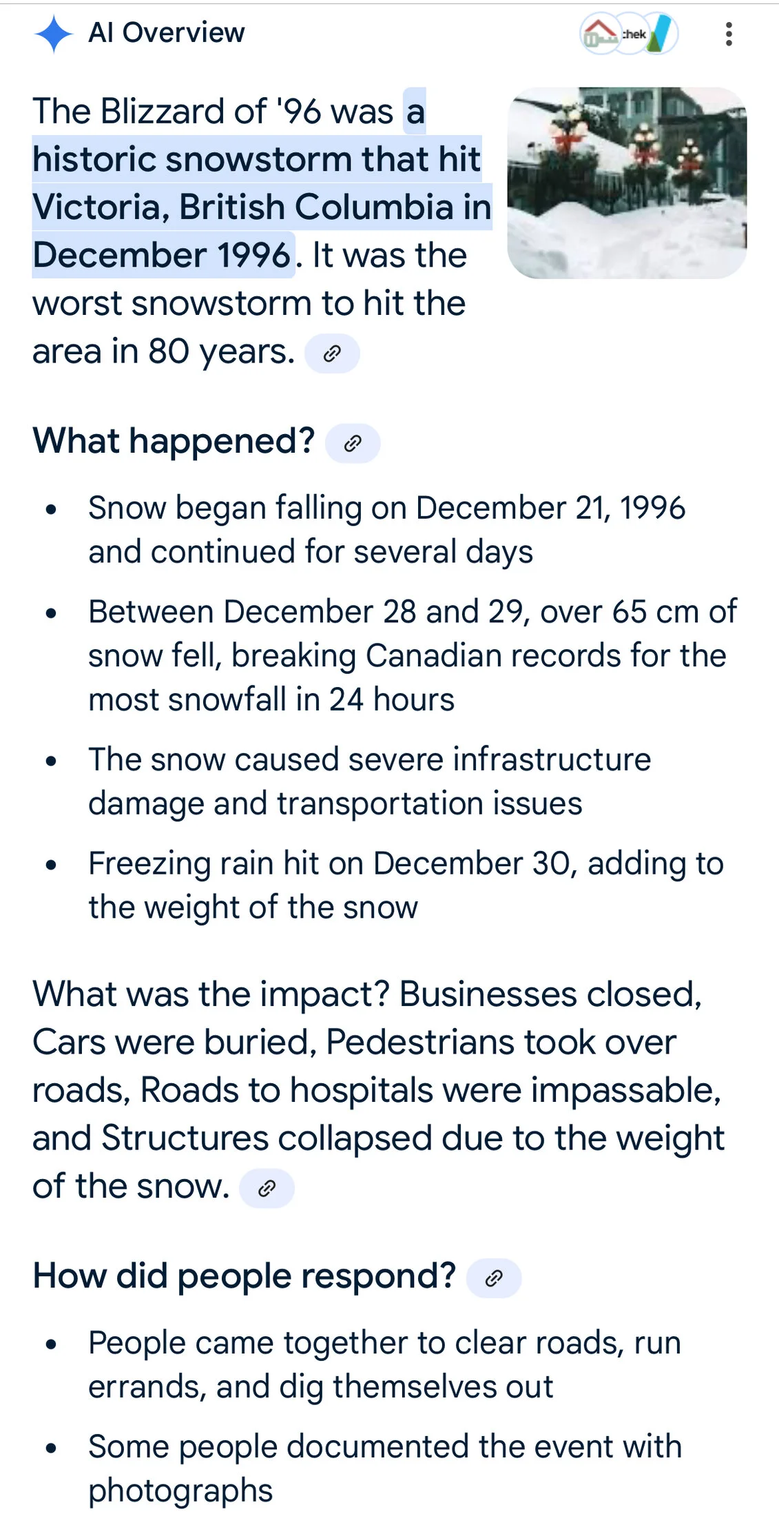

I’d have to disagree… I’ve driven home 20+ miles with roads covered in black ice everywhere. I’ve driven though 4’+ of fresh snow when the military were the only other vehicles on the road. Through slush, snow and ice to spread sand from a trailer when there was no salt to be found in 100 miles. It has been unstoppable and incredible for the 33+ years I’ve owned it. Tires make a huge difference… Mud terrains suck on ice.., you have to have the right tires.
The only thing I’ll agree with is that salt is evil… let it rot away your Honda Civic. But when the heaviest snowfall in 80 years hits, Civics will be dead in their tracks, just like the stock pathfinders, Chevy 4x4s with lifts and mud terrains, and 98% of the other vehicles on the road.
If you doubt how bad it was…

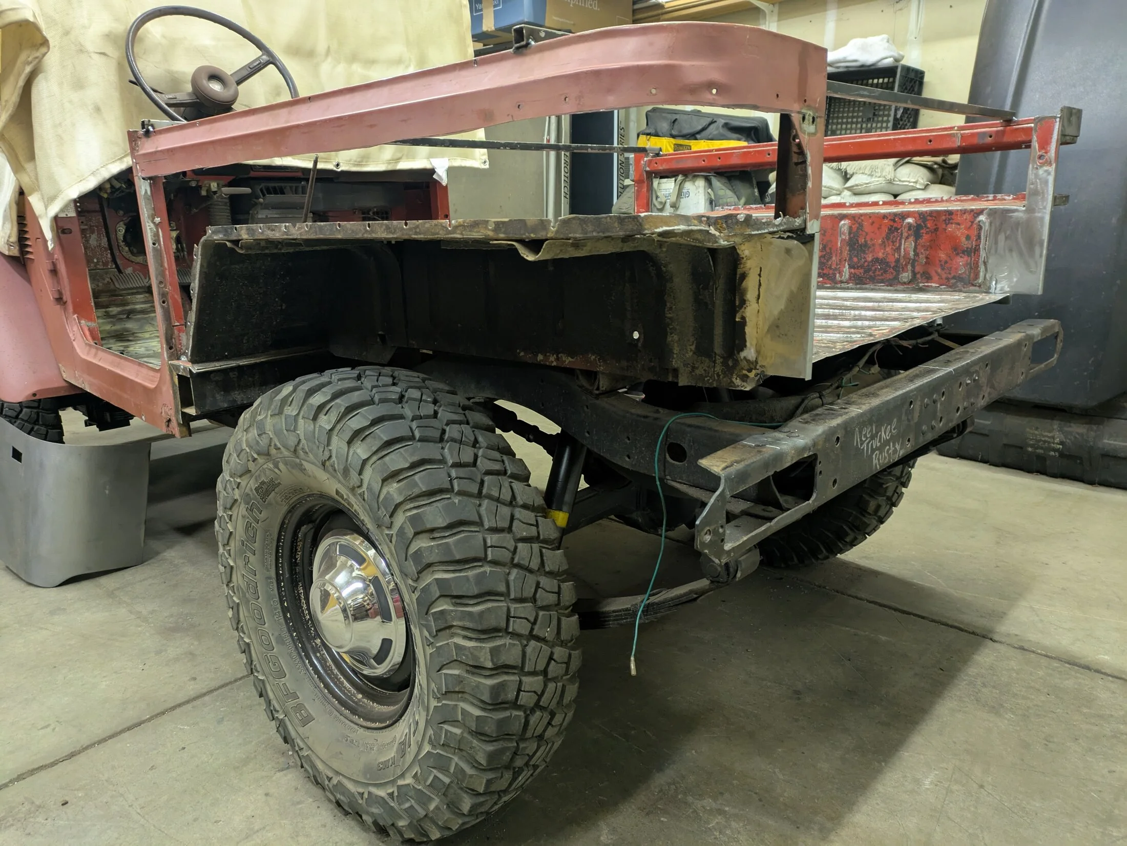

One thing that helps is the weight of my custom rear tub. 950 kg front axle weight and 1150 kg rear axle weight.

40s inherently are like in the rear end. Mine was especially light since someone put a thin layer of fibreglass over the rear floor. When I bought it, it should probably have been a parts truck. The cage was sitting on chunks of wood so it wouldn’t fall through the holes. The steel was so far gone that I was able to fold it up like origami to fit it into the garage truck when it came by.
The rear floor that I fabricated from 90ish% of a 4x8 sheet of 1/8” steel solved that issue. It rides and handles surprisingly well for a 90” wheel base 4x4. The V8 I swapped in was more of a sideways step as far as snow and ice are concerned. I later discovered 5 of the 16 cams on the camshaft were completely round and a few more weren’t much better. The flattop pistons helped some, but it was especially a 4-5 cylinder that by all rights shouldn’t have run much less ran reasonably well.

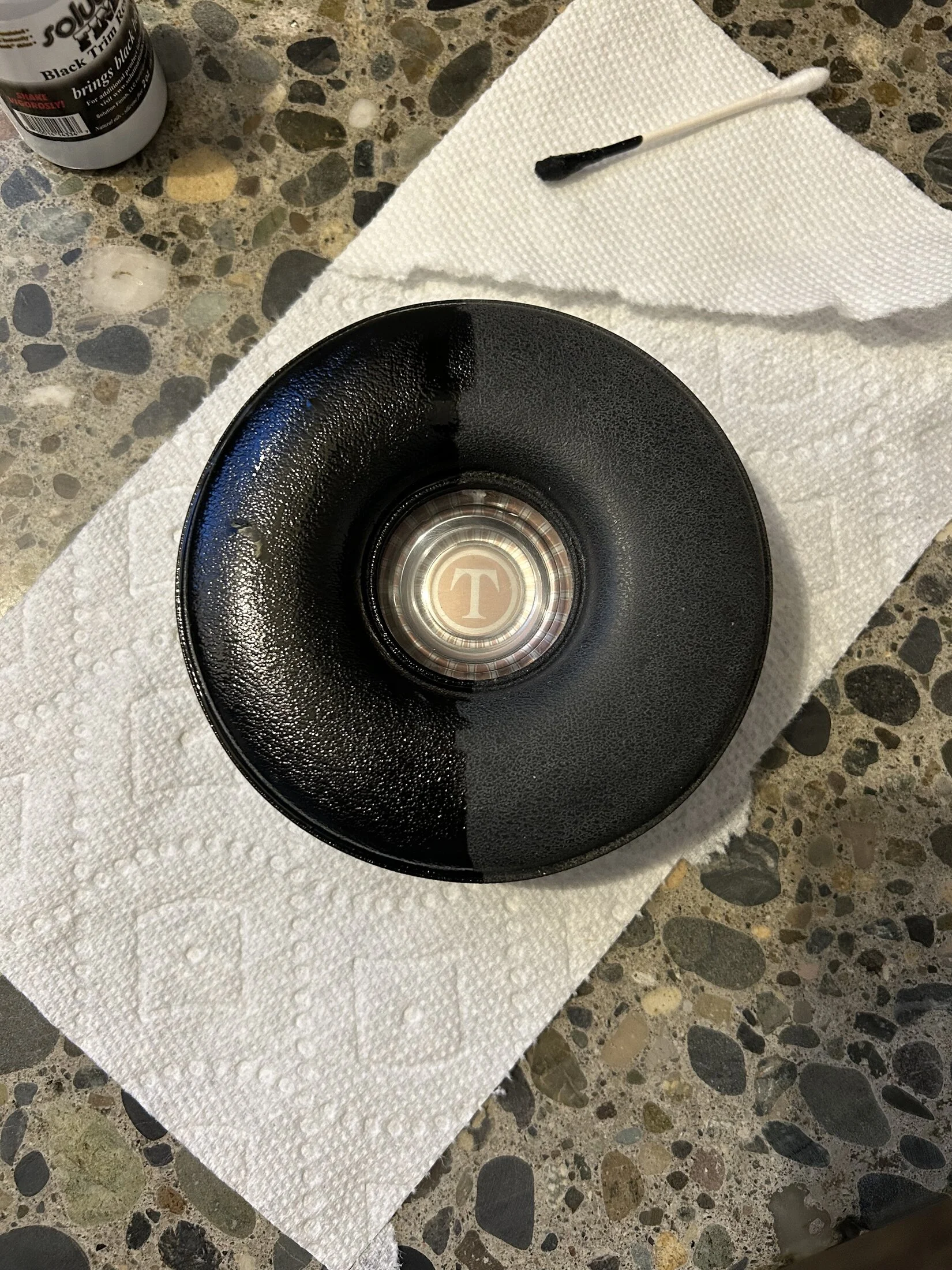

If anyone is looking for something to refresh the horn cushion and button trim this stuff works pretty well. Time will tell how it holds up. First picture shows the difference between the clean faded section and initial application before wiping up the excess. Second pic is with it applied and wiped off. Qtip works wonders with those ridges.
