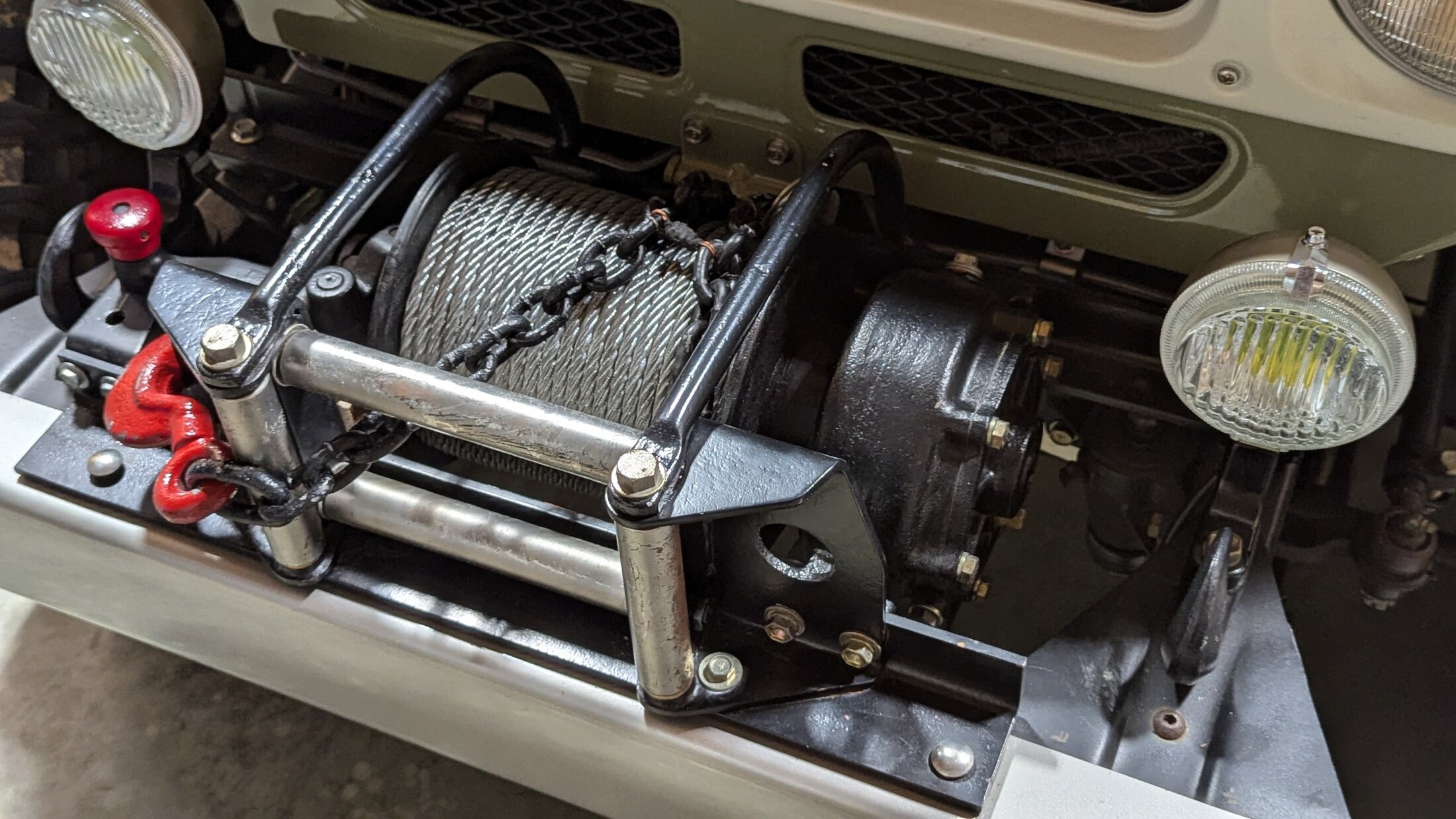

Had an old PTO winch from late 60's shipped up up to me and i started the tear down. replaced all the sills and bearings. blasted it and painted then added 160 ft of 5/16" cable with the original hook and chain. Had to lengthen the drive shaft as well as locate a radiator mount "horn" to mount the forward bearing pillow block to my 1980 Fj40 to the frame under the radiator and aligned with the original hole through frame to Winch. Works like a champ.
