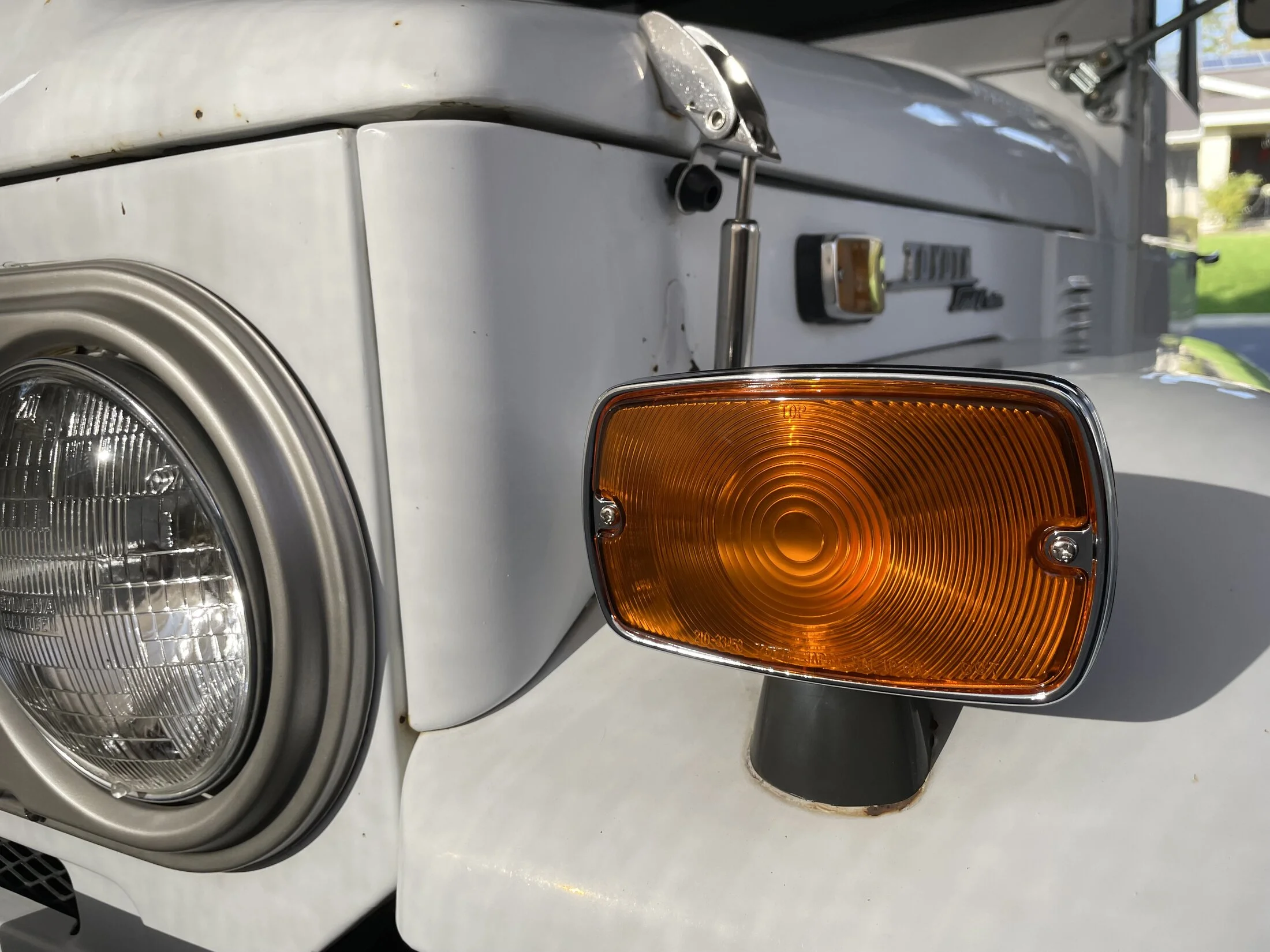

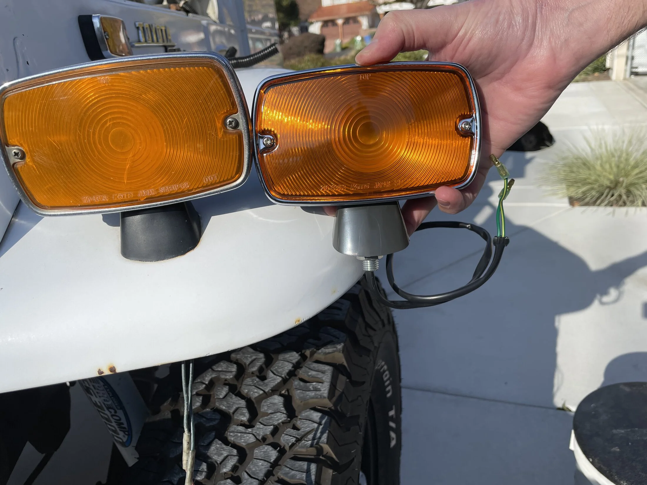

I installed some NOS Toyota goodness. Original units were cracked and hazy. If anyone wants my old ones shoot me a PM

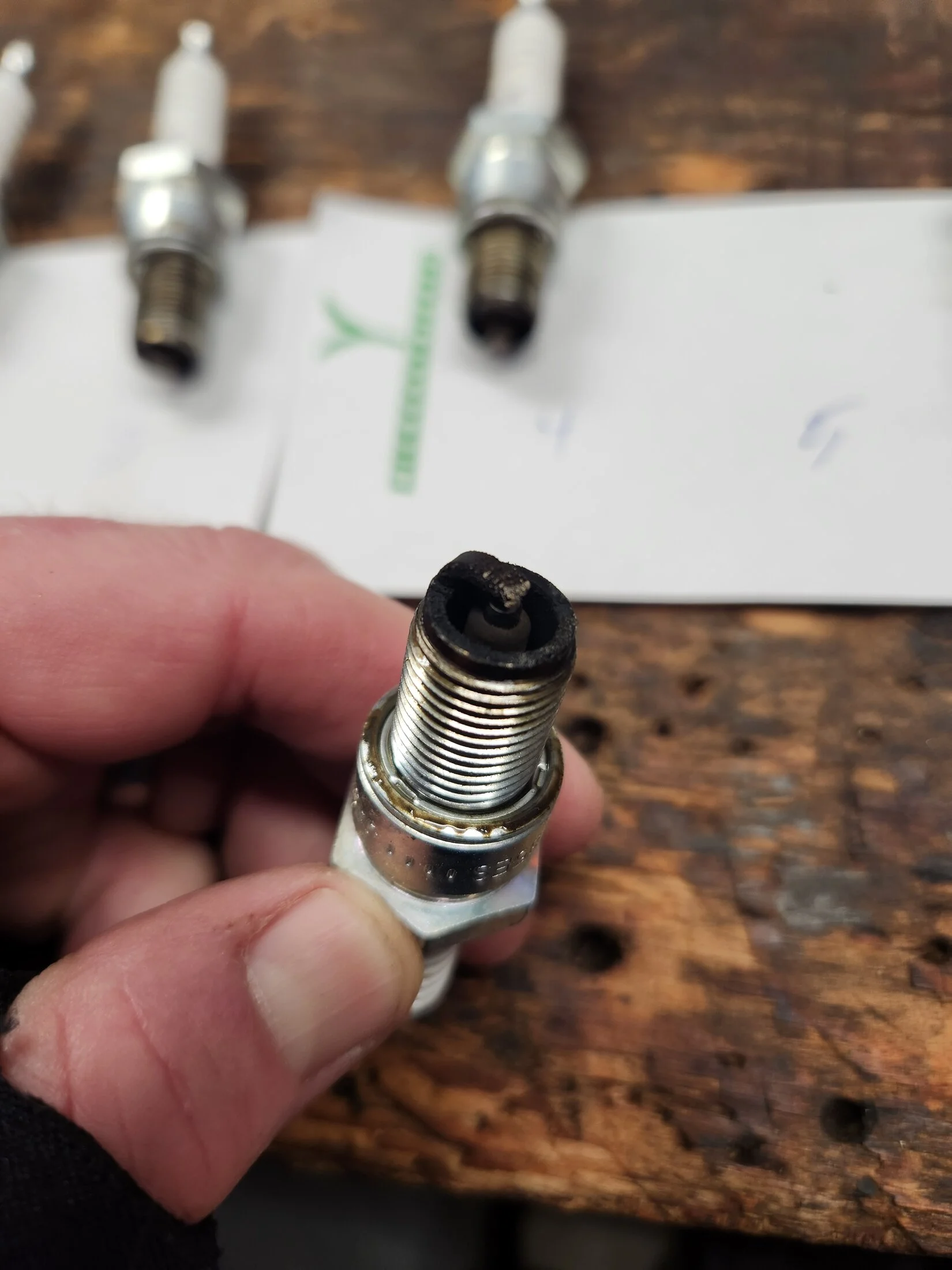

That was going to be my next question. Here is a photo of #4, which is pretty representative of #1-#4 and #6. #5 was a bit sooty in comparison. This rig is fairly new to me and I don't know how many miles are on these plugs. I did do a valve adjustment after my purchase and have put a few hundred miles on since. I was wondering if I need to check #5 again. I cleaned the plugs and re-installed them.
Looks like oil and suit, suit alone is flat-black. It could be the valves leaking oil, or the oil getting past the piston rings, and a 'wet-compression-test' will tell you where it might be. What grade oil is in the crankcase?
I had the shop put in 10 W-30 and planned to do more research and change it out in the spring. I am not sure what the prior owner was running in it.
