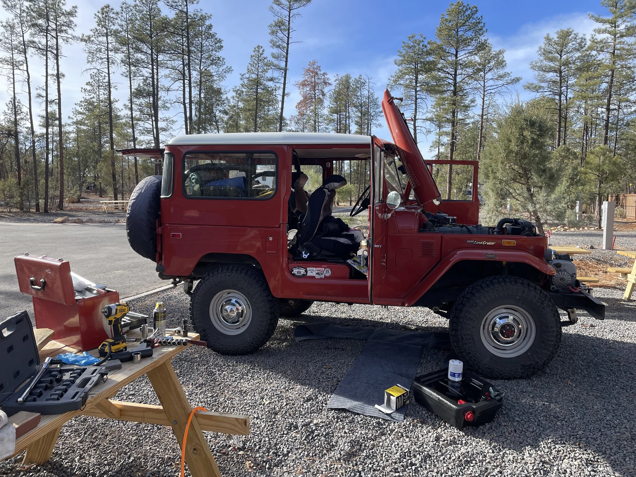

First ever Valve adjustment! Drove it around, got it hot...
Decided to try it running, keep it hot, feel it up, adjust.
I used an old alignment plate to keep the oil from squirting all over my exhaust...
Some oiling ports are pumping it out... some not so much eg cyl #1...
I had one or two loose and pretty much all the intake valves were too tight. I had one that the lock nut was about to spin completely off!!!
EIIEEIIE E=.014 I=.008
Shut it off and tightened all down.
I think I did a decent job... it is running so much smoother and has noticeably more power. Scoured the Mud forum for specs and vids... Thanks to all!!
