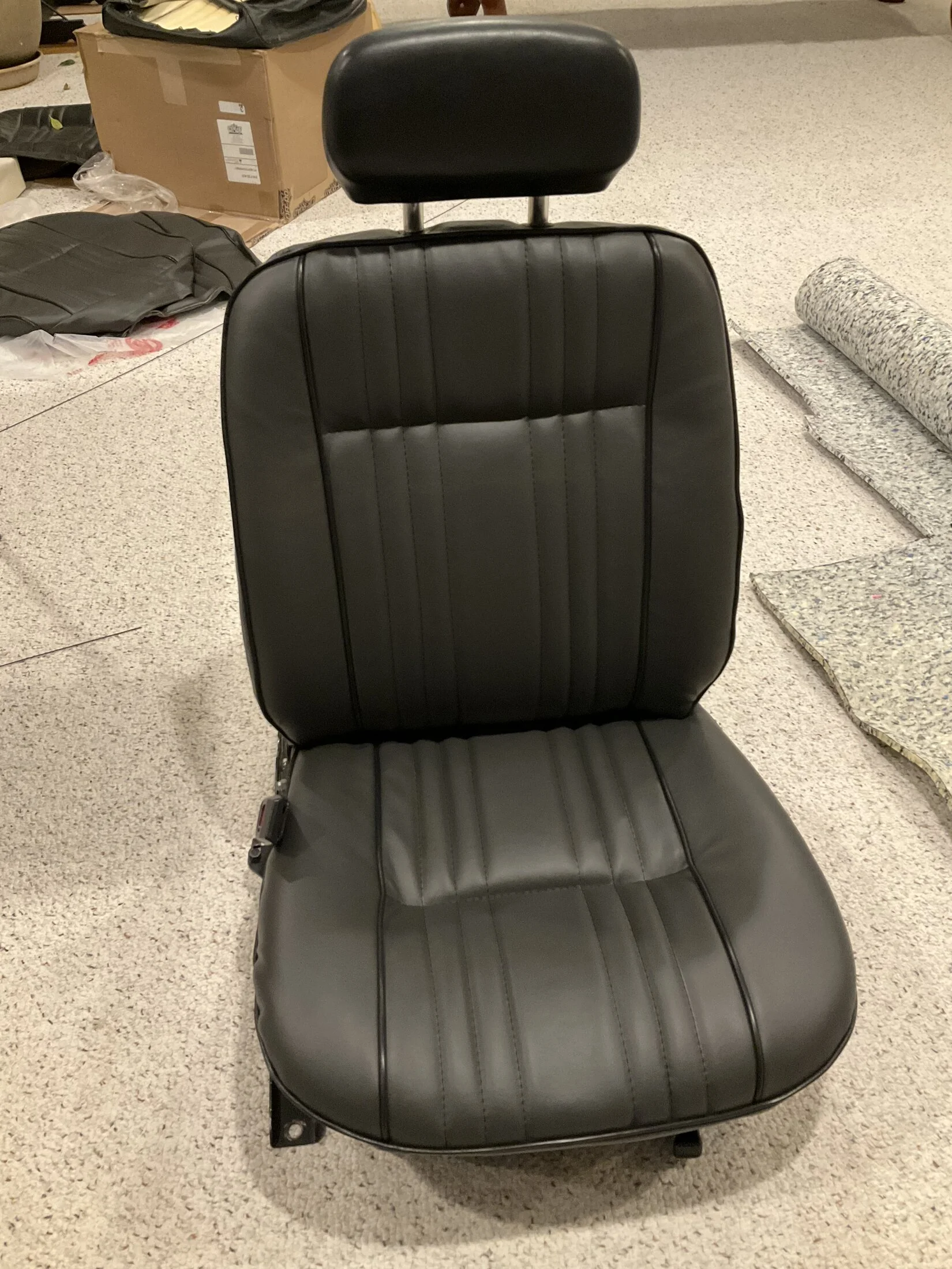

Finished up the driver seat… passenger still to go.
Went with the Spector. Very pricey, but the quality of construction is top-notch (even with my amateur upholstery skills). Bought the replacement headrest covers, but haven’t decided if I will use them as my current headrests are in fairly decent condition and match the new seats better than I expected

Down right sexy!
