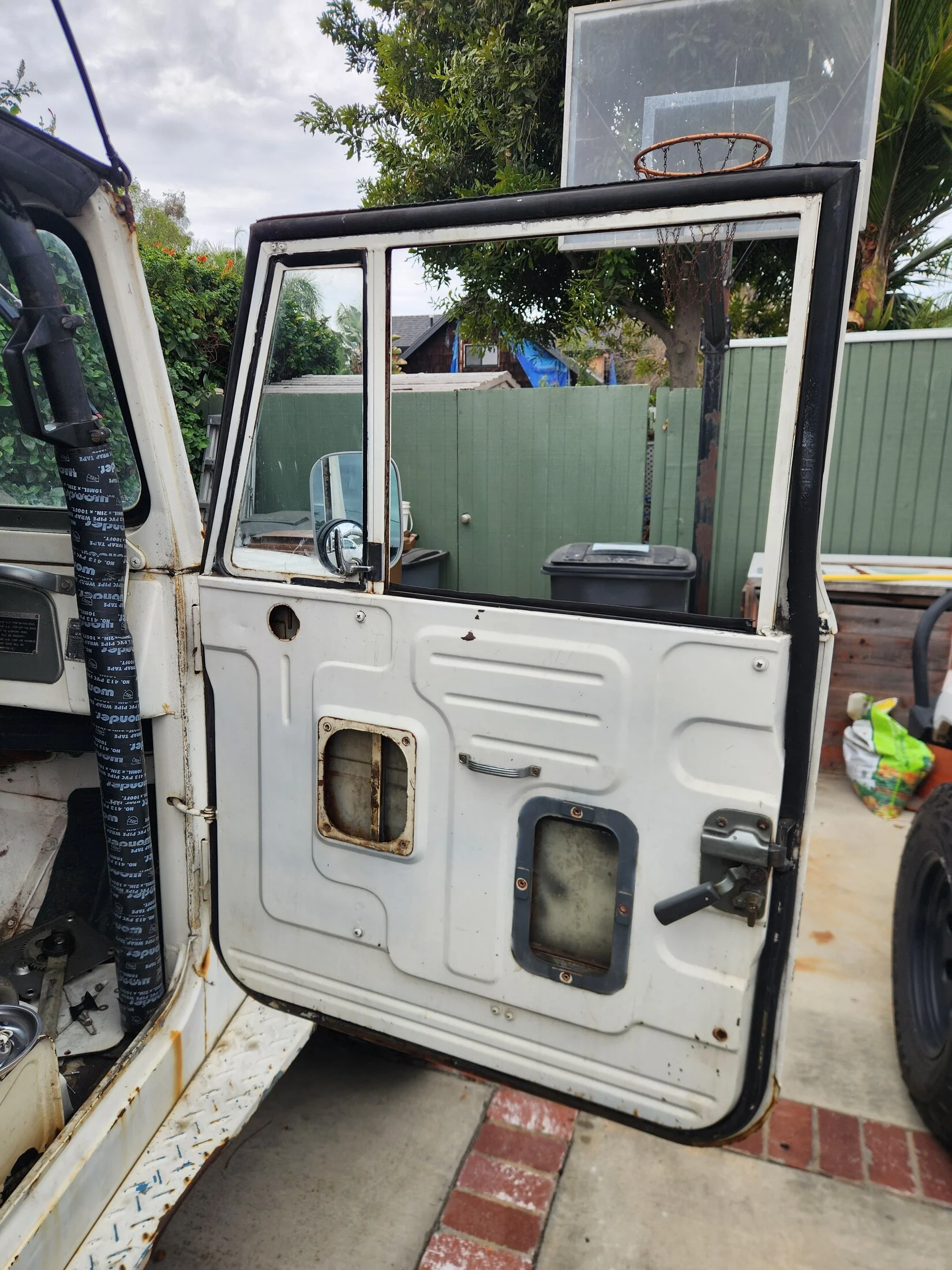

I just completed replacing the rubber/felt window guides. In my head, it was a daunting task, I had been dreading doing this for a long time. But after a bit of MUD research and convincing the lazy side of me to do it right, it was really not that hard!
The first window took a bit longer and once I broke loose all the screws it was smooth sailing. The first window is always a bit harder as you learn what to do.
The second window work took about half an hour from start to finish. And now my windows no longer rattle and they roll up and down like they were new!!!
