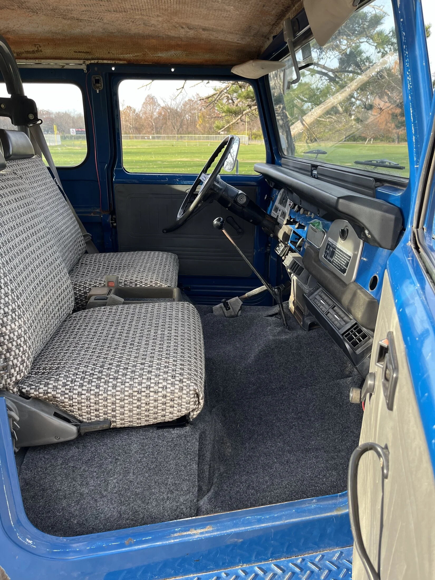

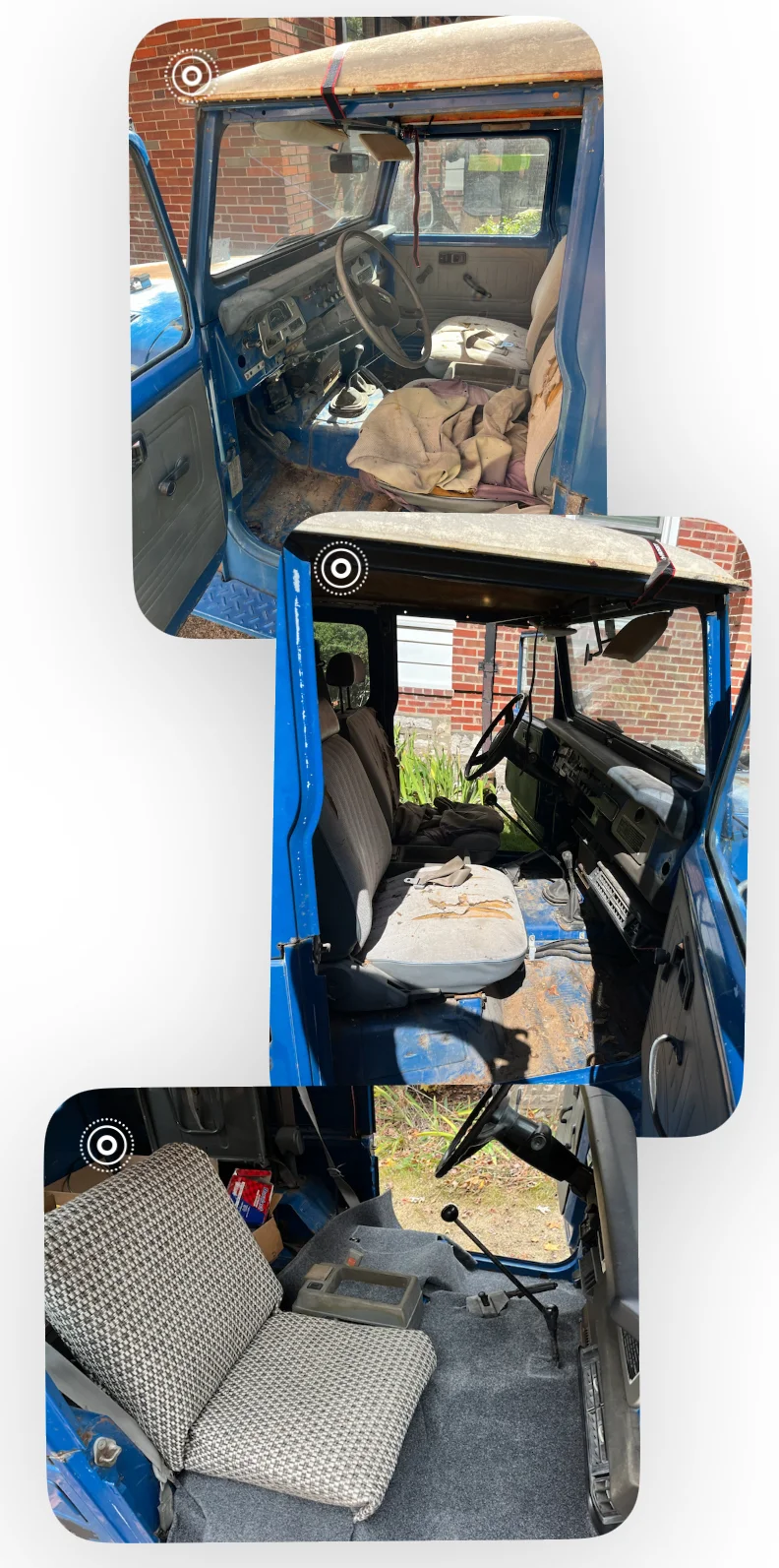

Ok, so my seats were recovered many years ago with a fabric that didn’t appear to like the sun! The passenger seat below is nothing compared to the drivers seat. My son’s GF asked if it was attacked by a bear… lol
I thought I could just cover them with an outdoor carpet with some waterproofing. Below are the results. Kinda looks like my grandmas old couch now… or like I covered them in carpet (which I did) lol. better than a bear attack I guess.
Passenger seat before:
Test fit:
Update:
Before:
After(ish):

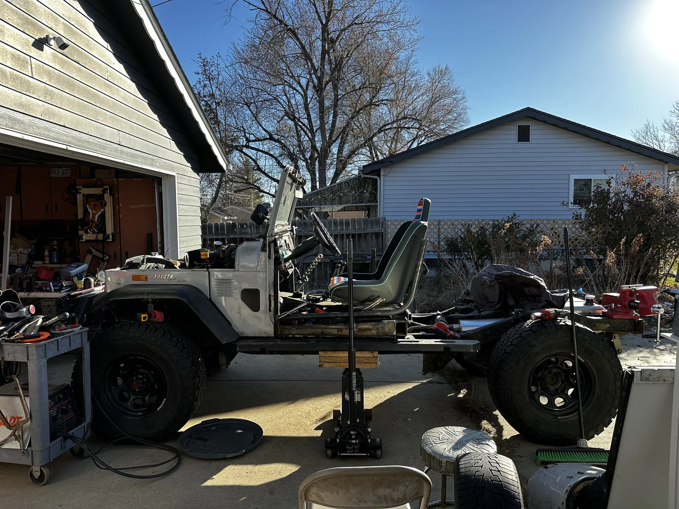

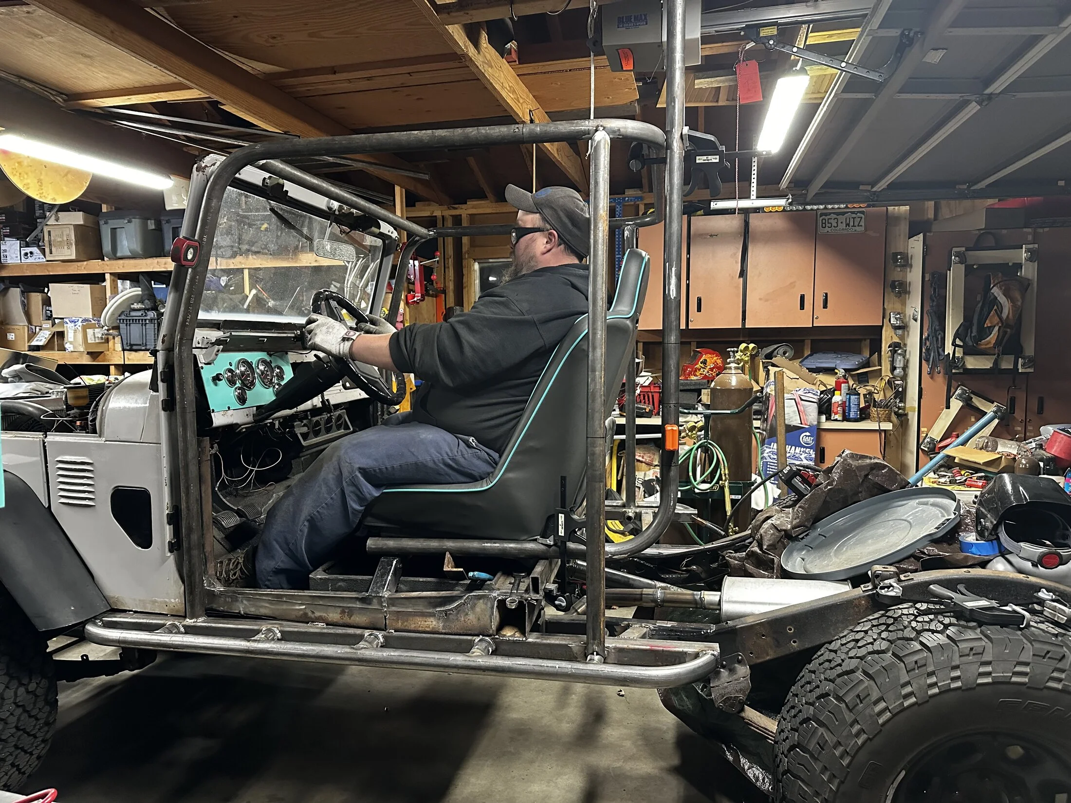

3” setback for 6’4” driver using unistrut method (still fully adjustable). Auto/marine carpet floors and seats…

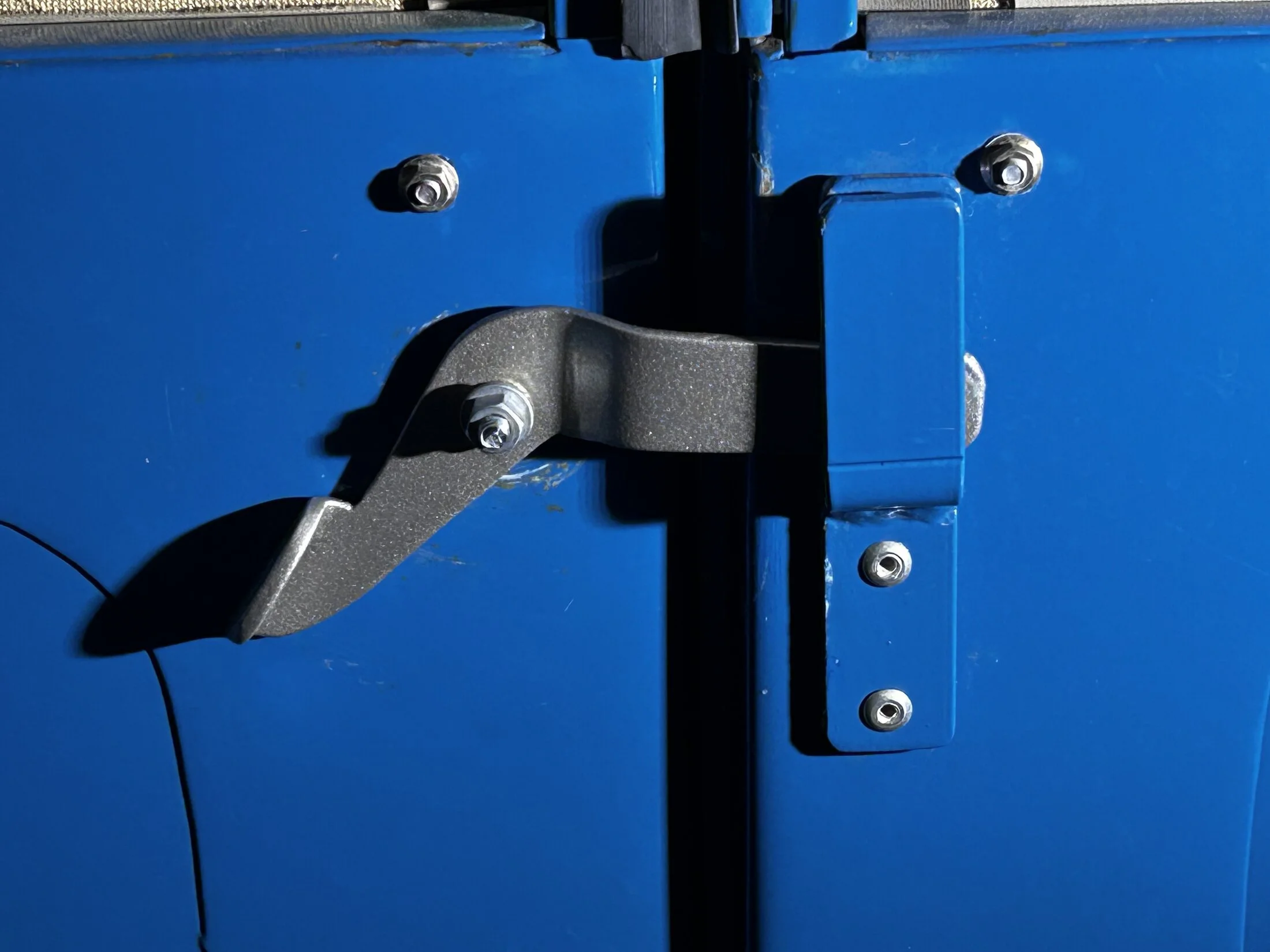

There is something really gratifying making old parts like new. This small project required welding (filling in as it was stripped out) the interior ambulance rear soft top lever 69385-90801 square hole. Then pressing a broach to cut the new hole to receive the exterior door handle 69201-60010 . The exterior handle required a machinist to weld a new m6x1.0 post.
Then used JB weld to fill imperfections on the latch as it’s material that withstands heat for powder coating.

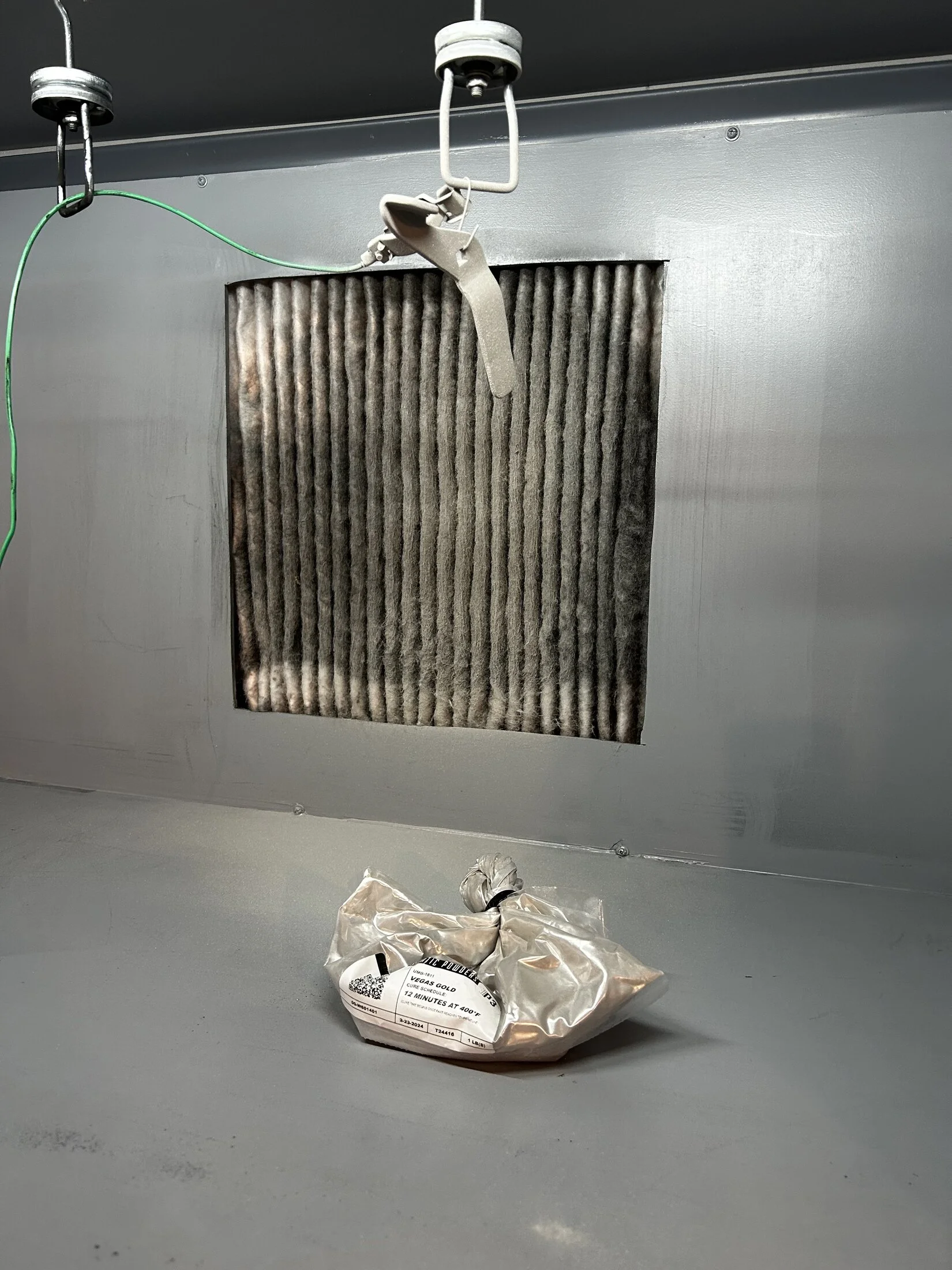

Applied Vegas Gold by Prismatic Powder. It’s close enough to factory for this application.

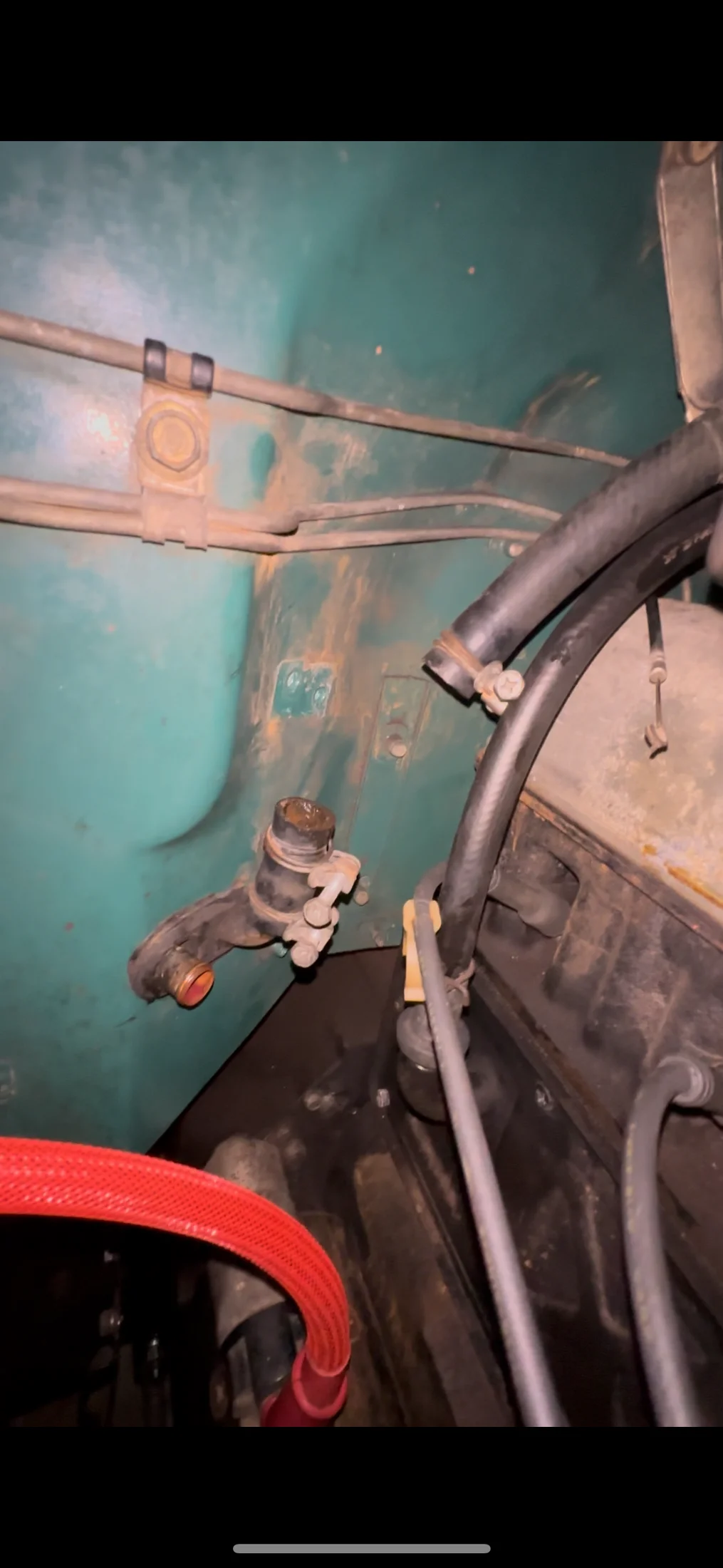

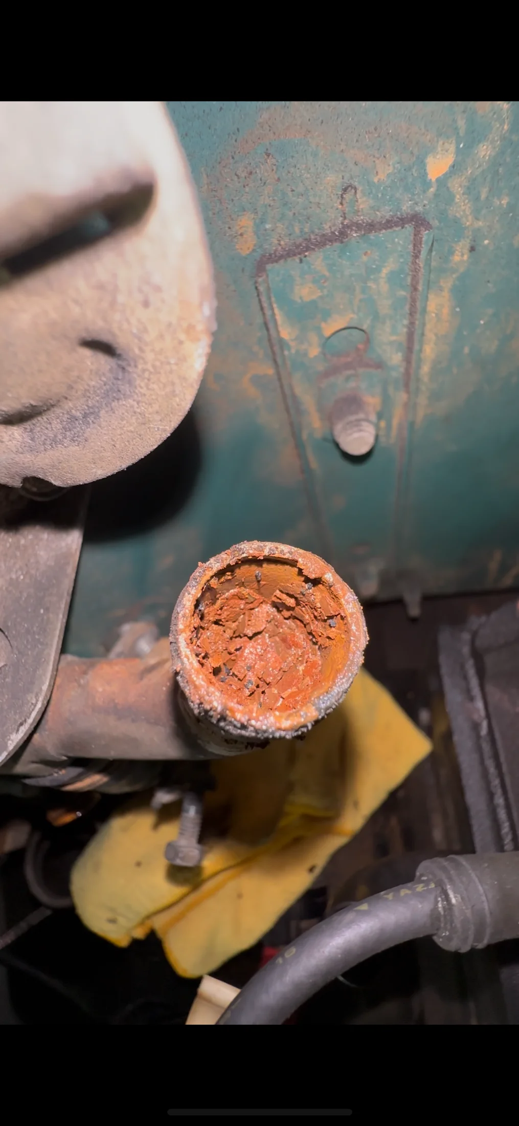

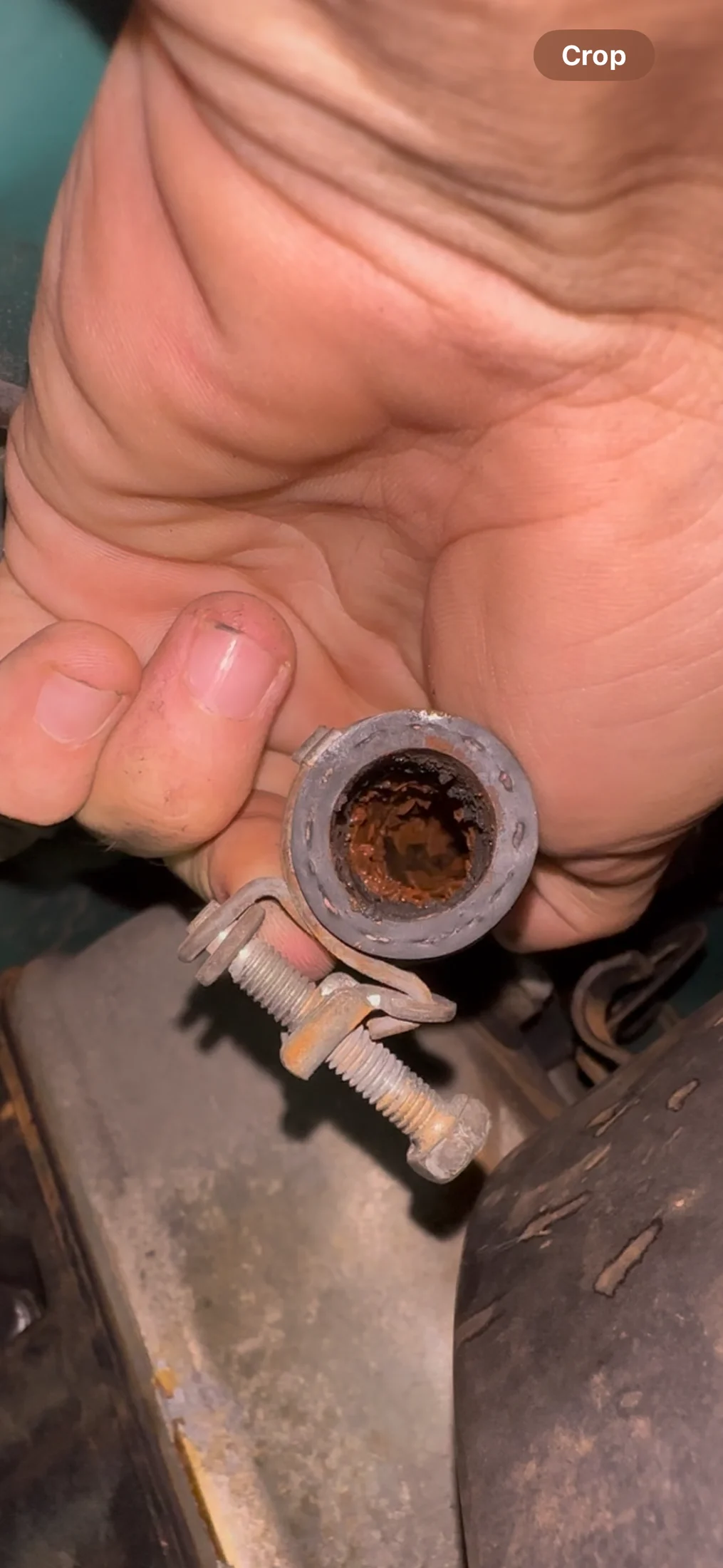

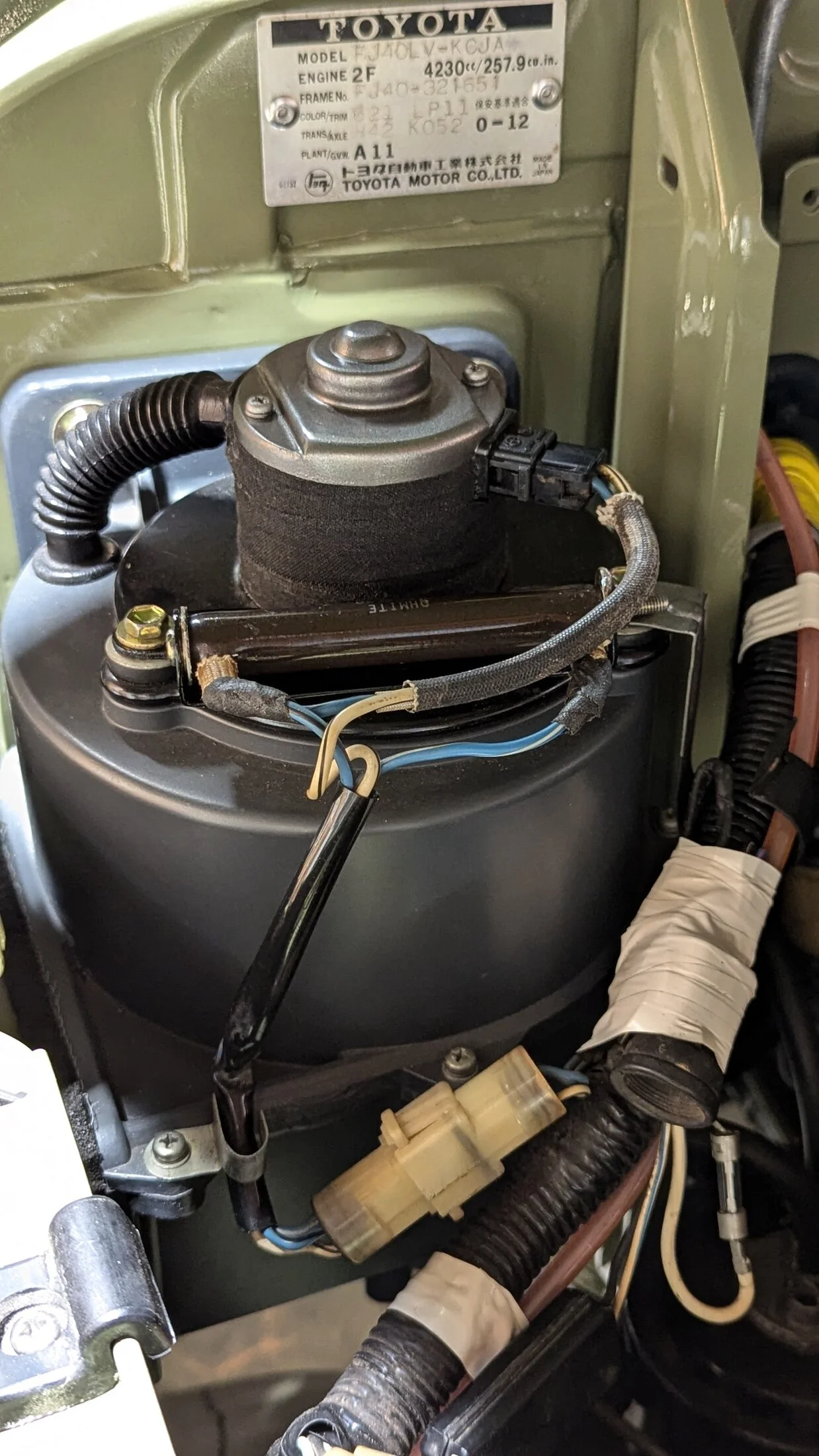

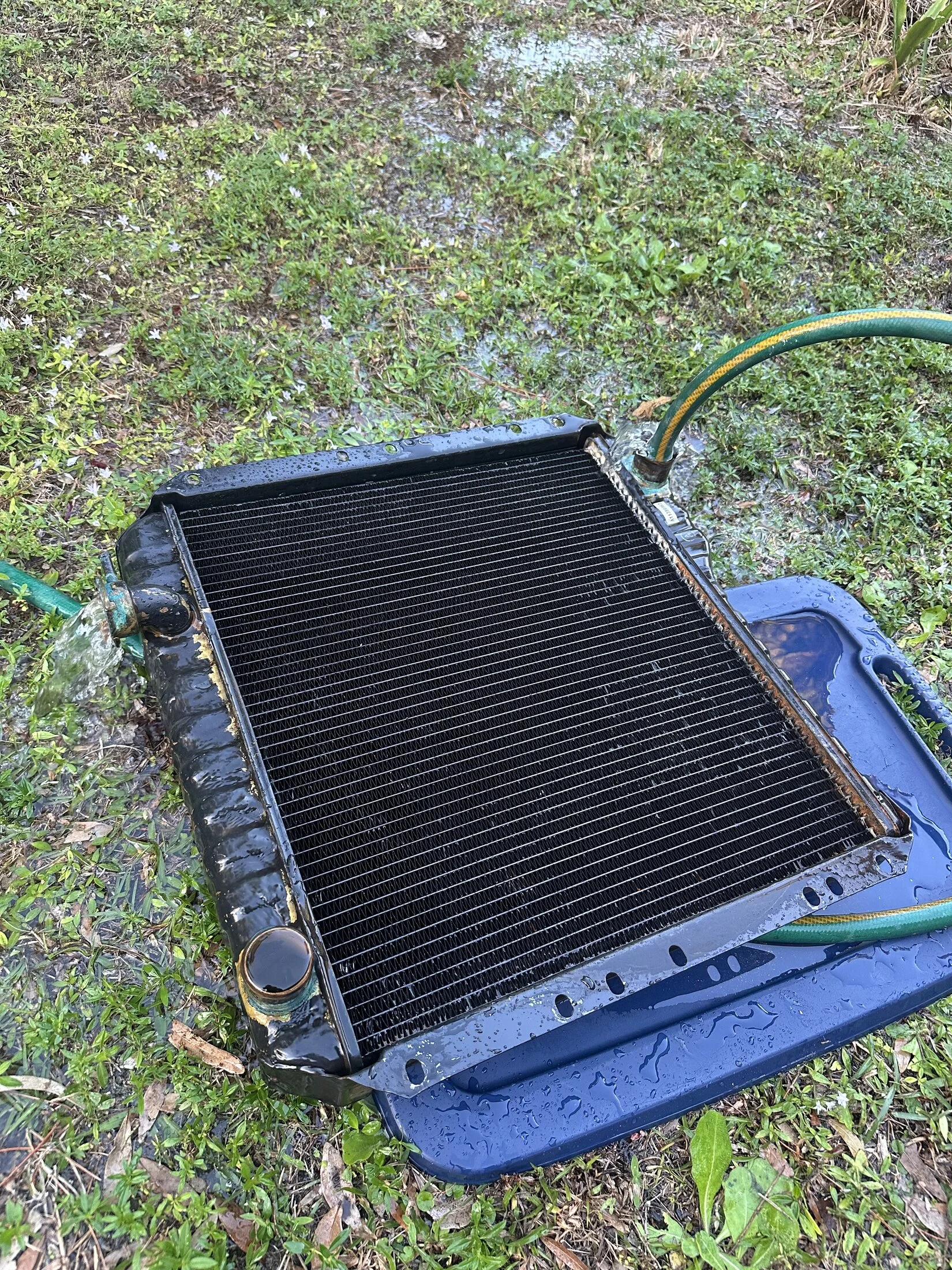

Made some more progress on going through the cooling system. Got the heater core lines and heater valve off.The heater valve was filled with rust/gunk. Got the radiator support bracket out and the lower splash shield as well. Going to be addressing some minor rust and repainting the support bracket and splash shield. If you haven’t serviced your cooling system or never replaced your heater valve you should look into it. I had no overheating issues somehow. 😅

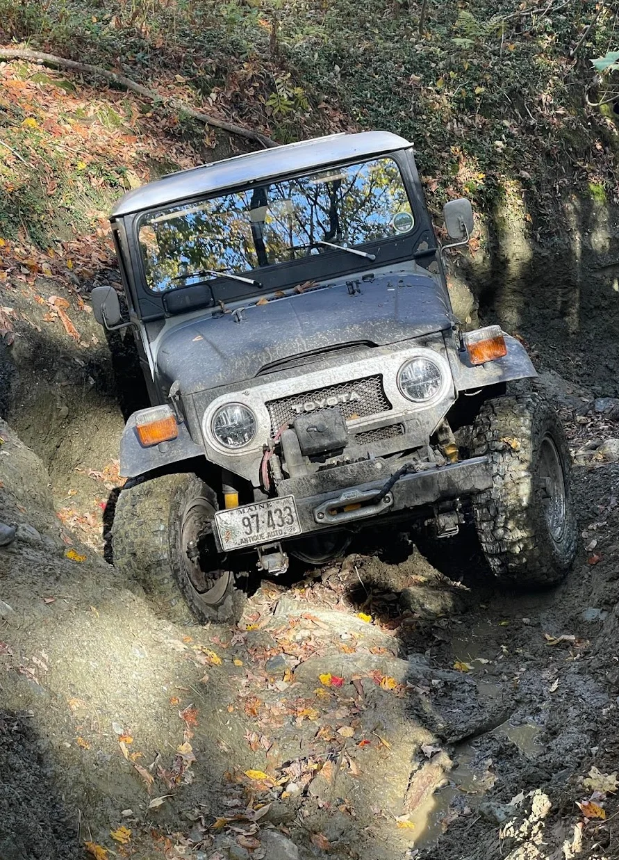

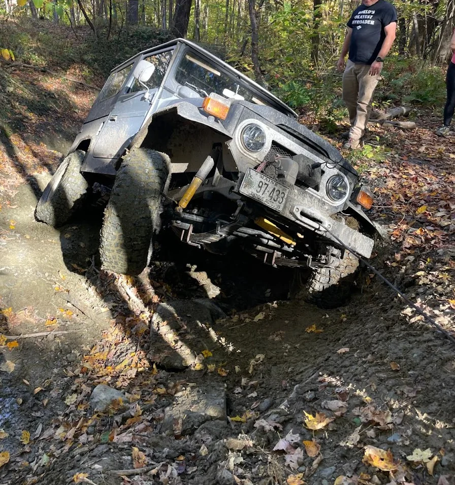

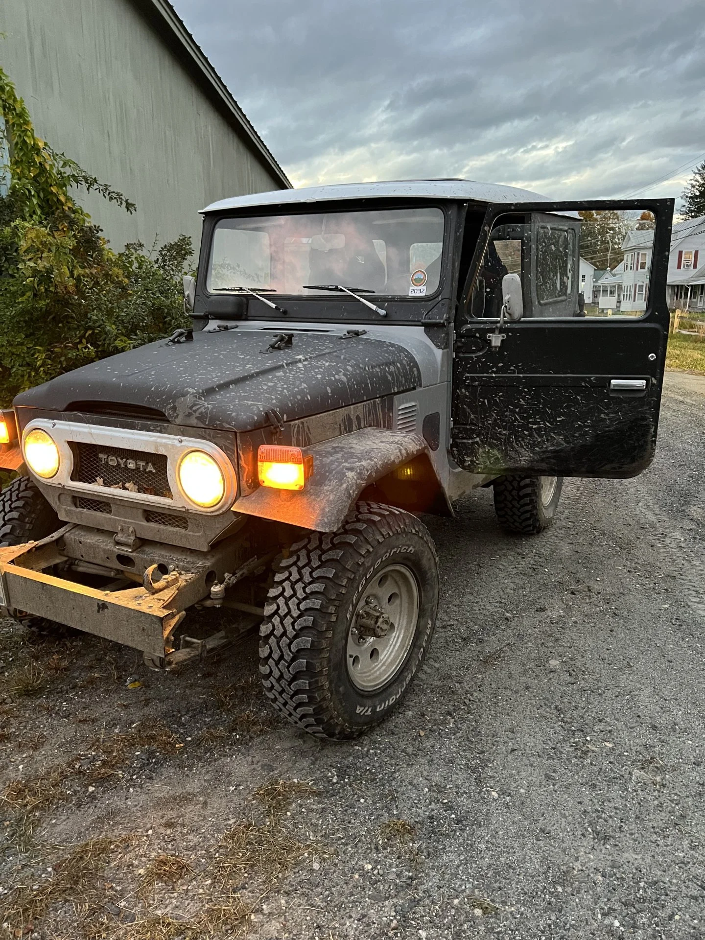

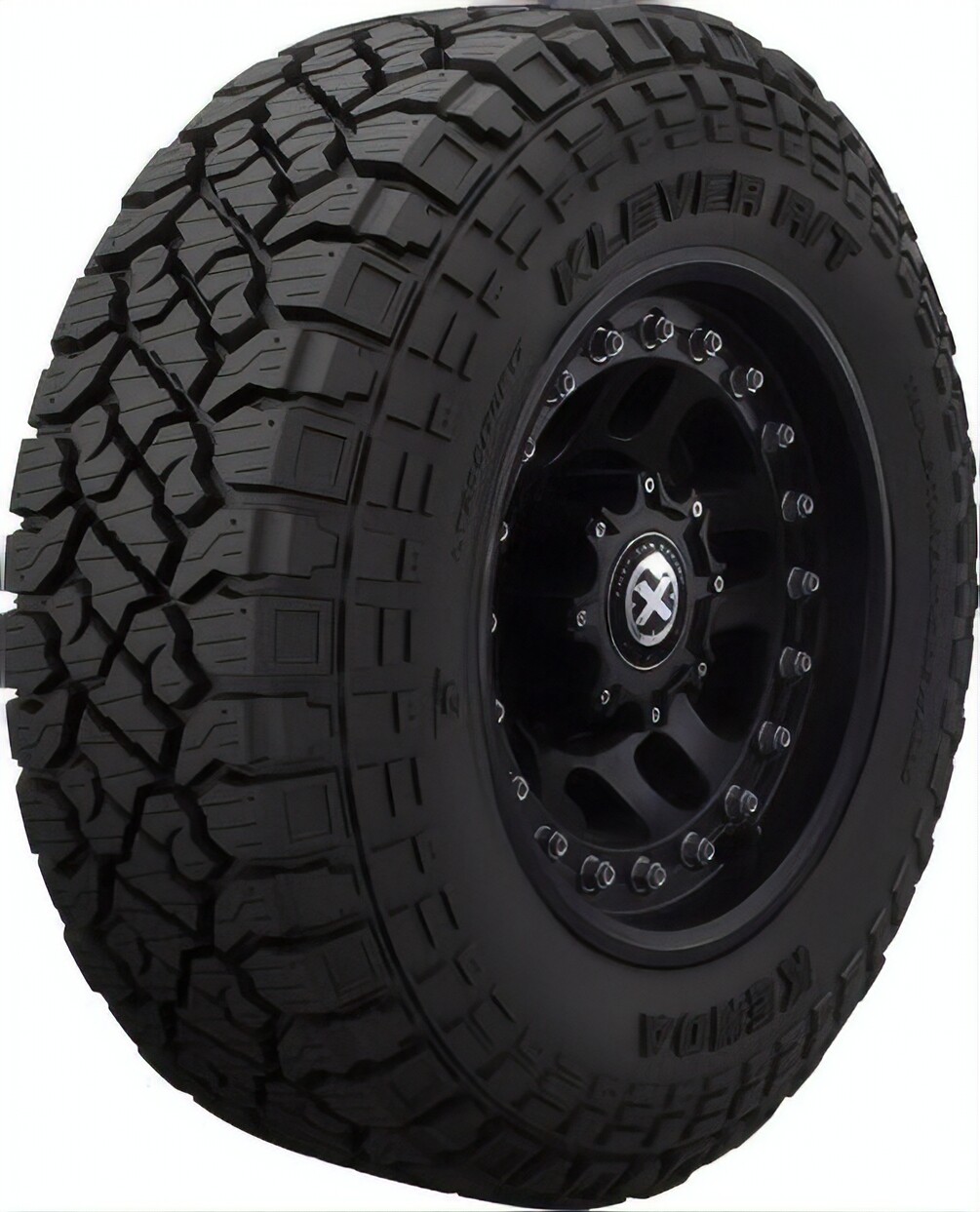

How have the Kenda MT been? I have a set back ordered for mine..
They have been great. I put them on in late September and took it on an adventure in October. No issues. Only got stuck once. First time using the 8274.
Was that in VT? I want to do that some year.
Yes. Weren't you there a couple years ago? Maybe not for the event, but in the neighborhood.

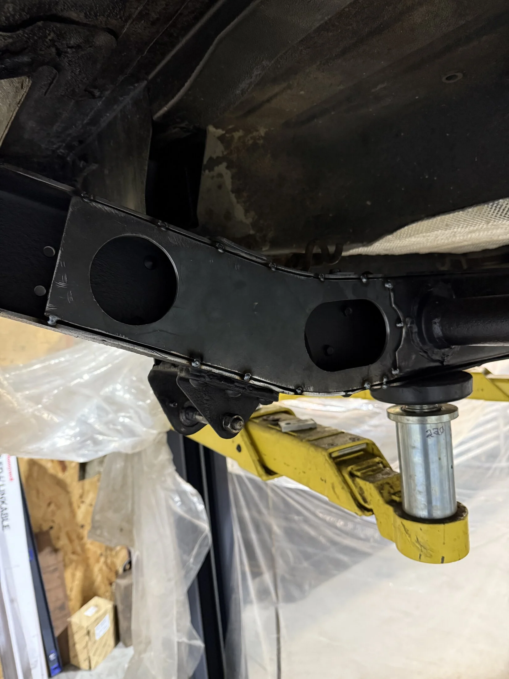

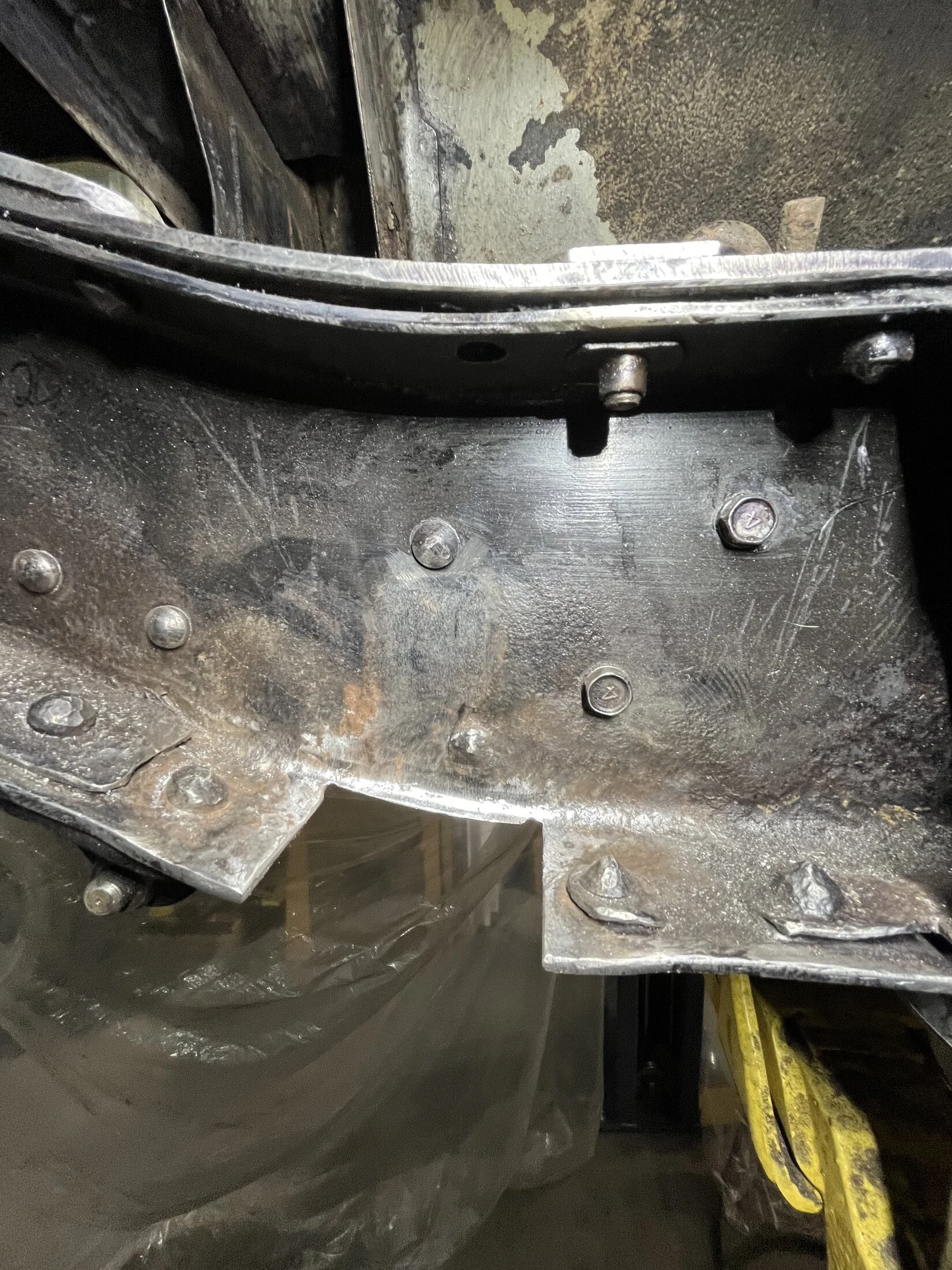

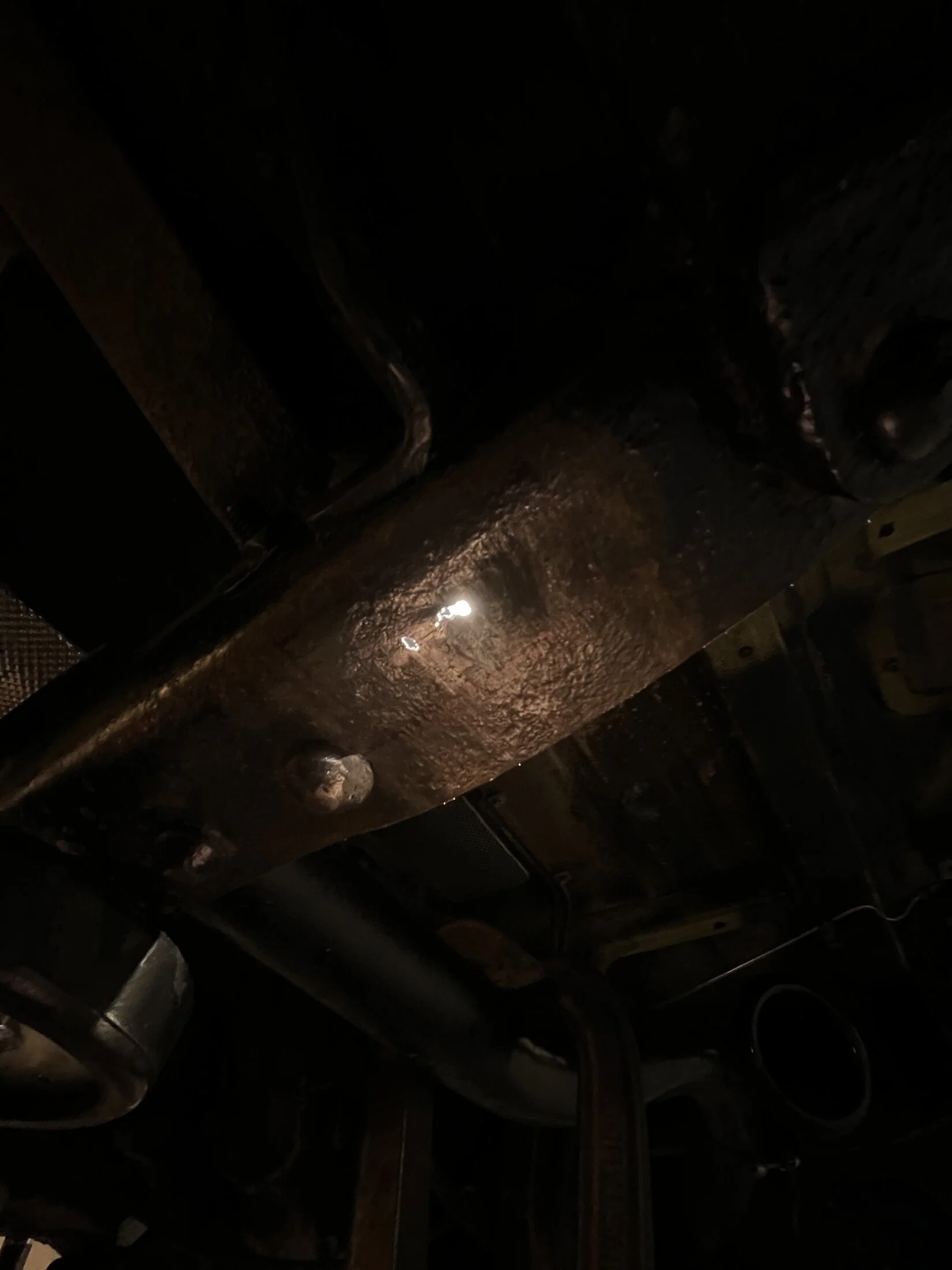

Move to driver side to reinforce the rear hangers for preventative measures. Cut out inner c-channel - cleaned out debris & found holes in frame with light. Thought about fix, drilled out, then thought might be better way, cut out frame part, make patch, braced patch to frame - then got the new reinforcement tacked in.
Light in the frame - picture below looking up from bottom of frame.
Cut out
Welded on with brace
new patch to shore up stress around hanger with more lateral strength.

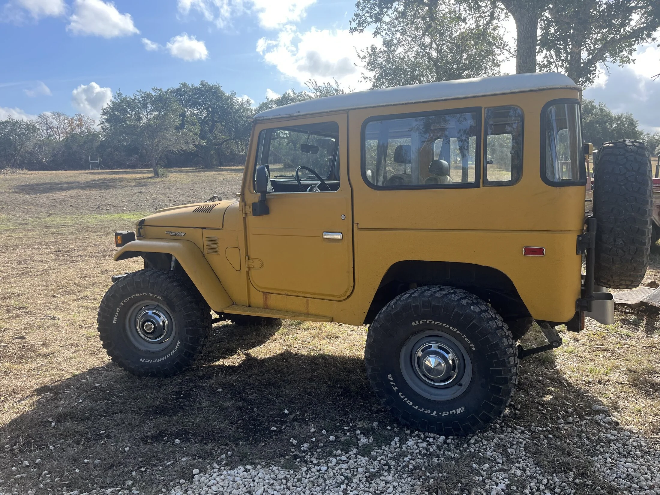

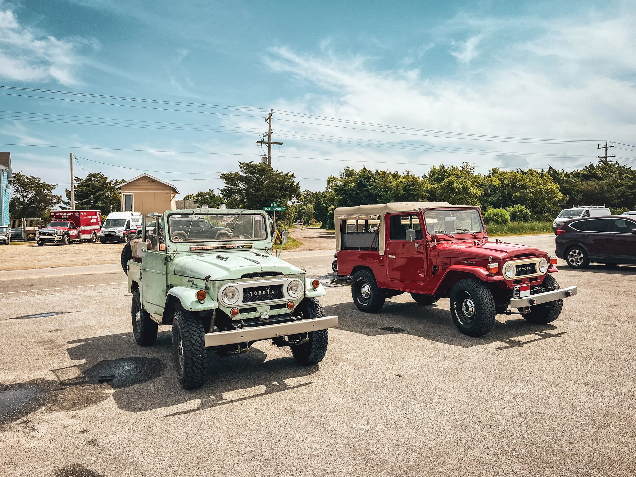

Found this photo below from summer and it made me think that a OBX beach meet up needs to happen. This guy drove his fj43 from the middle of the state to here on Ocracoke.
What are those tires you’re running?
