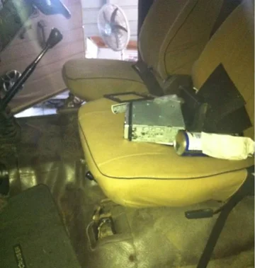

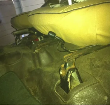

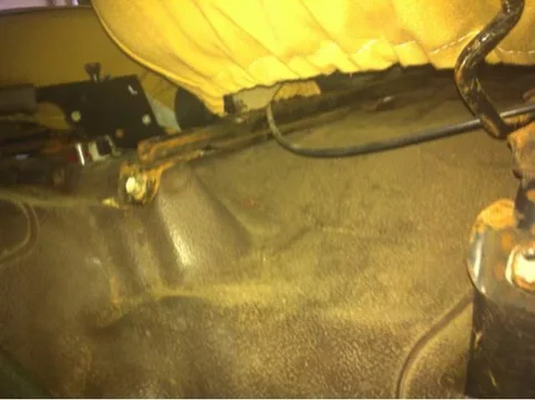

Here is a few pics, as soon as I find my MIA tape measure, I'll measure.
Bucket on pass side
Brackets off the BJ 70 seat
You can see the bolt hole for the 3/4 bench way over on the left.
Bucket on pass side

Do you perhaps have a picture showing the rear part of that inner passenger rail, please ? Did you swap your bench for a bucket seat or was your bucket stock OEM ?
