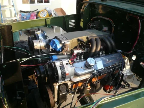

If you get a normally aspirated engine the Powerjection III may be an option too. Not really cheap but has worked very well on mine so far. That way you can use any intake that fits a square bore Holley. IF for some reason it dies putting a carb on to get home is pretty easy. Just need a pressure regulator.
2F :)
