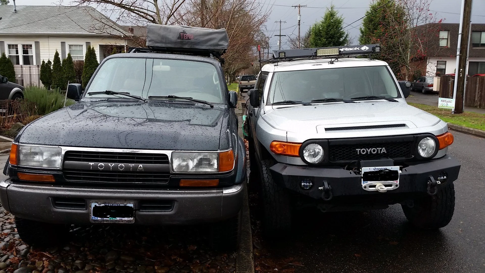

A lot! Replaced the drive belts and installed a new radiator. Transferred my RTT from the FJ Cruiser (should be sold on Tuesday) to the 80. CDL (hazard) switch installed along with Scan Gauge II. I'm tired!
