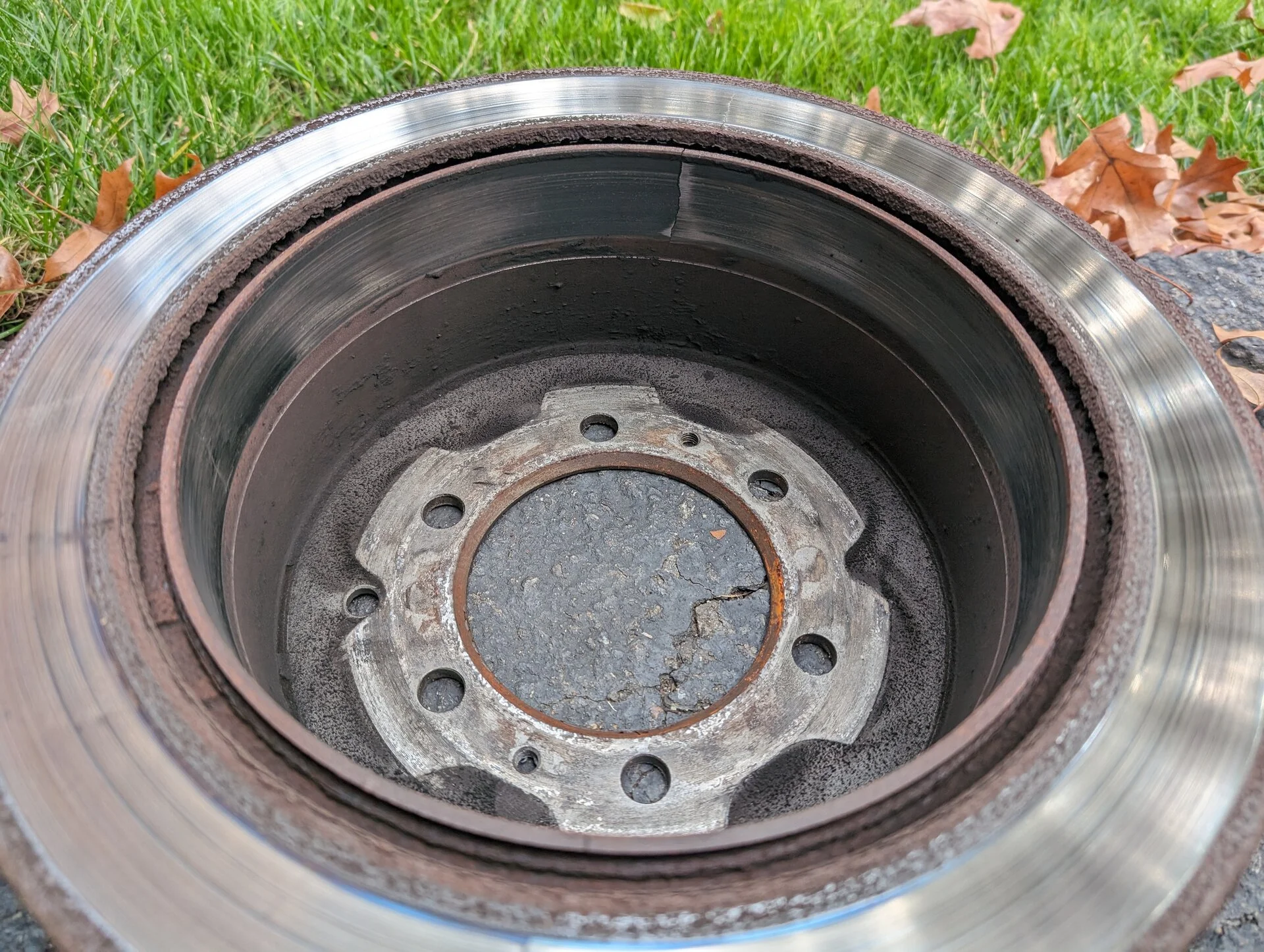

Wrapped up replacing rotors on all four corners, and all new parking brake shoes and hardware. Strangely, the parking brake hardware kit only includes two of the actuator springs, when you need two PER SIDE. even OTRAMM mentions this in his video. i just re-used the old ones as only two bright green springs would bother me 😃. I did not use OE parts so hopefully no dead nuns in my future, but instead Napa front rotors, and Centric rears, Bosch parking brake shoes, Carlson parking brake hardware kit all from Rockauto.
These are the old ones. Rotors were jacked; cracked on both braking surfaces; 180* apart. Shoes and hardware actually looked recently replaced, but figured why not "while i'm in there" in case the material was contaminated or something. replaced all four calipers two years ago but skimped on the rotors...oops!

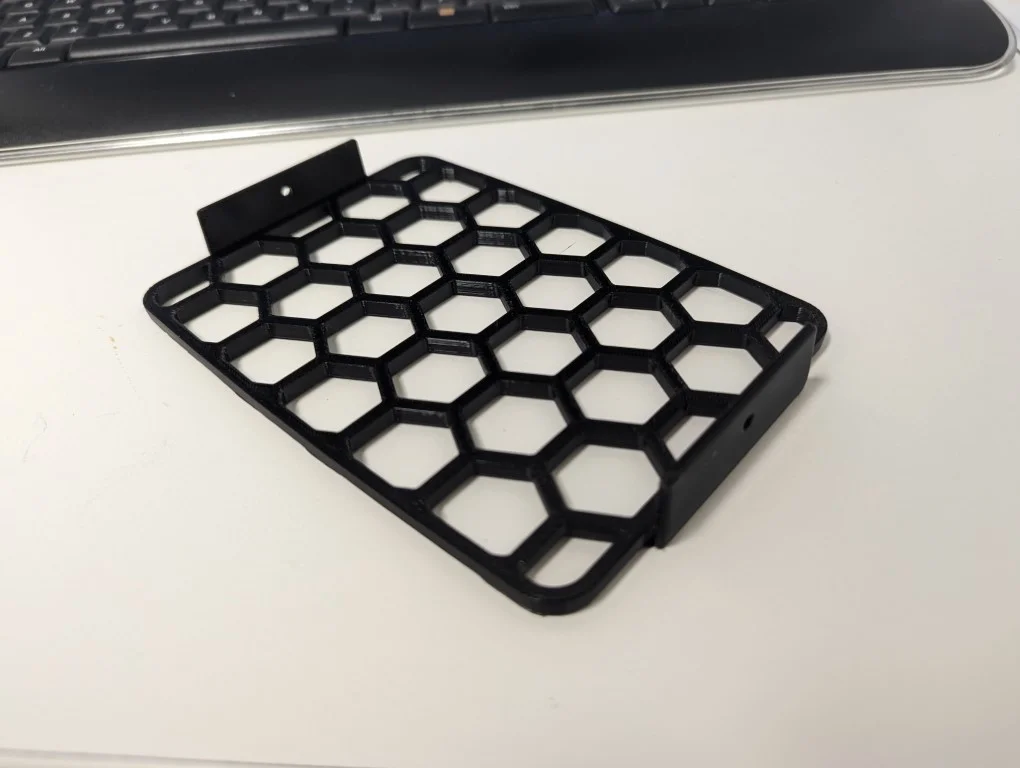

While camping an aggressive Joshua Tree attacked the snorkel head - or shall we admit going too fast down a track :)
Looked and found lots of 'expensive' metal alternatives etc, but part of me says it's good to have a weak link that is easy to replace.
Searched the web and the infinite number of monkeys had a solution - 3d model that just needed 3d printing. There's actually lots out there, but I went for a reasonably simple shape. 3D printed in petg.
Installed, maybe it'll attract bees :)

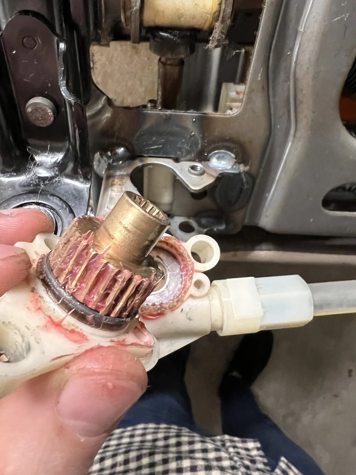

Fixed passenger seat back/forward. I dug into the system to find aftermarket brass gears locked up due to being slightly too larger in diameter to rotate, old gluey grease, and shards of old nylon catching in the gears... There's no shot this ever worked right... After sanding the gear shafts down just enough to rotate, and cleaning everything, the seat is moving back and forward again!

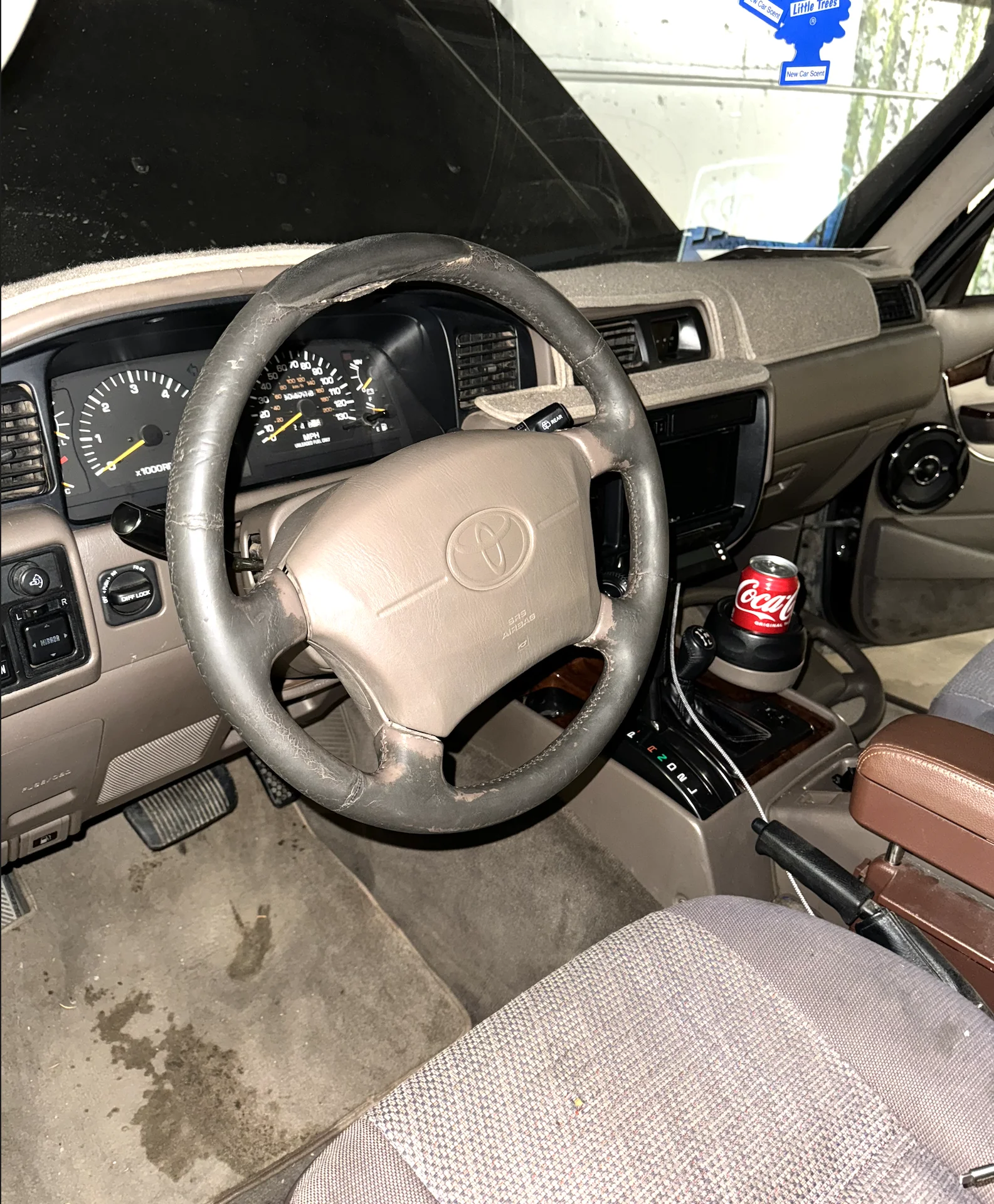

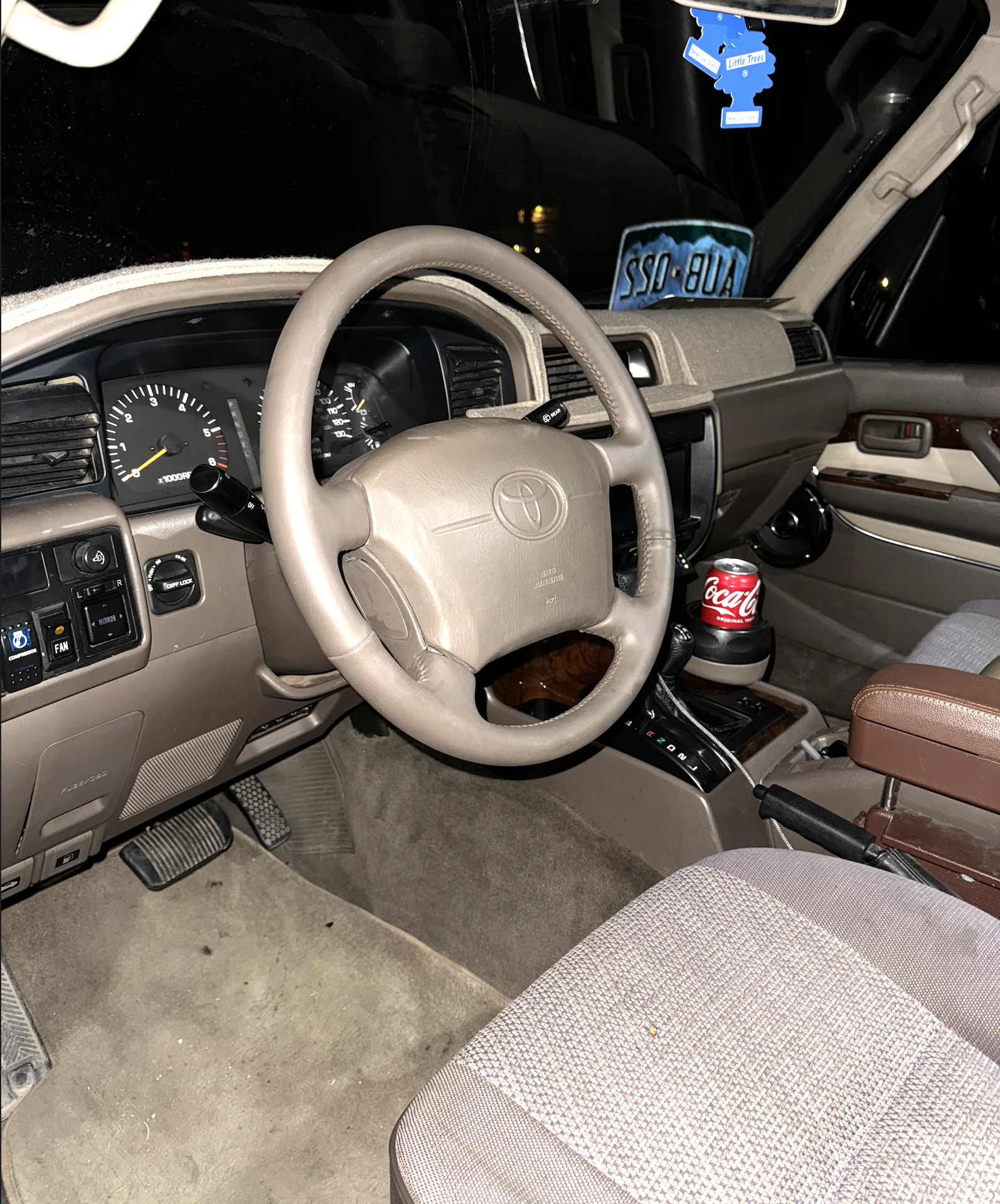

Nice!! Did you stitch it yourself? I have always thought it would be cool to put a newer steering wheel with volume controls, etc on the 80. Has anyone done this?
I did not. I knew I did not have the patience or time to rewrap my wheel. My 80 is my daily. I bought this one off Ebay. 20 min swap.

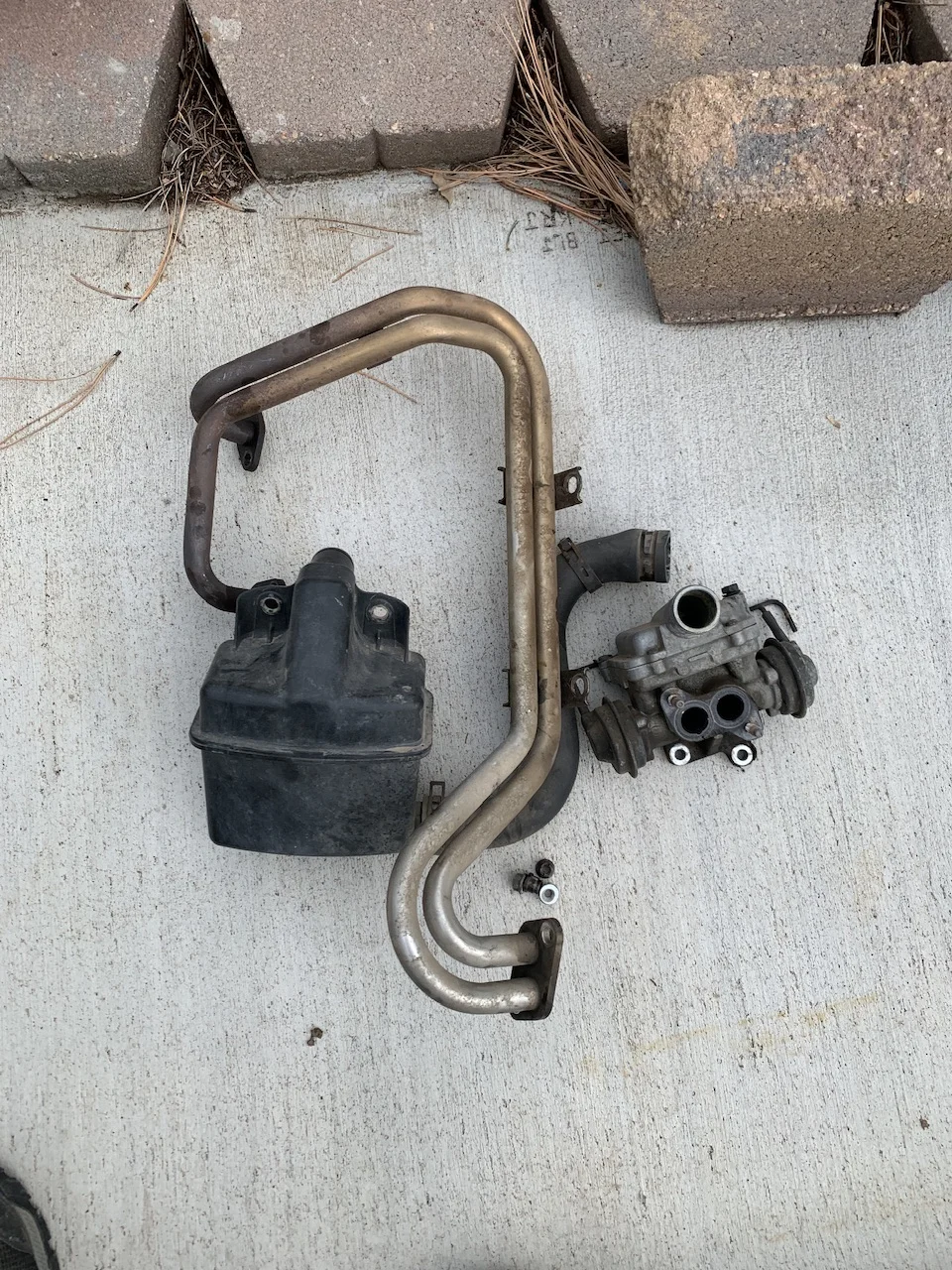

Why delete it? Been always curious but not enough to consider it.
Some people do it to add on board air. Some say it fails. I just did it because it’s in the way it doesn’t need it.
