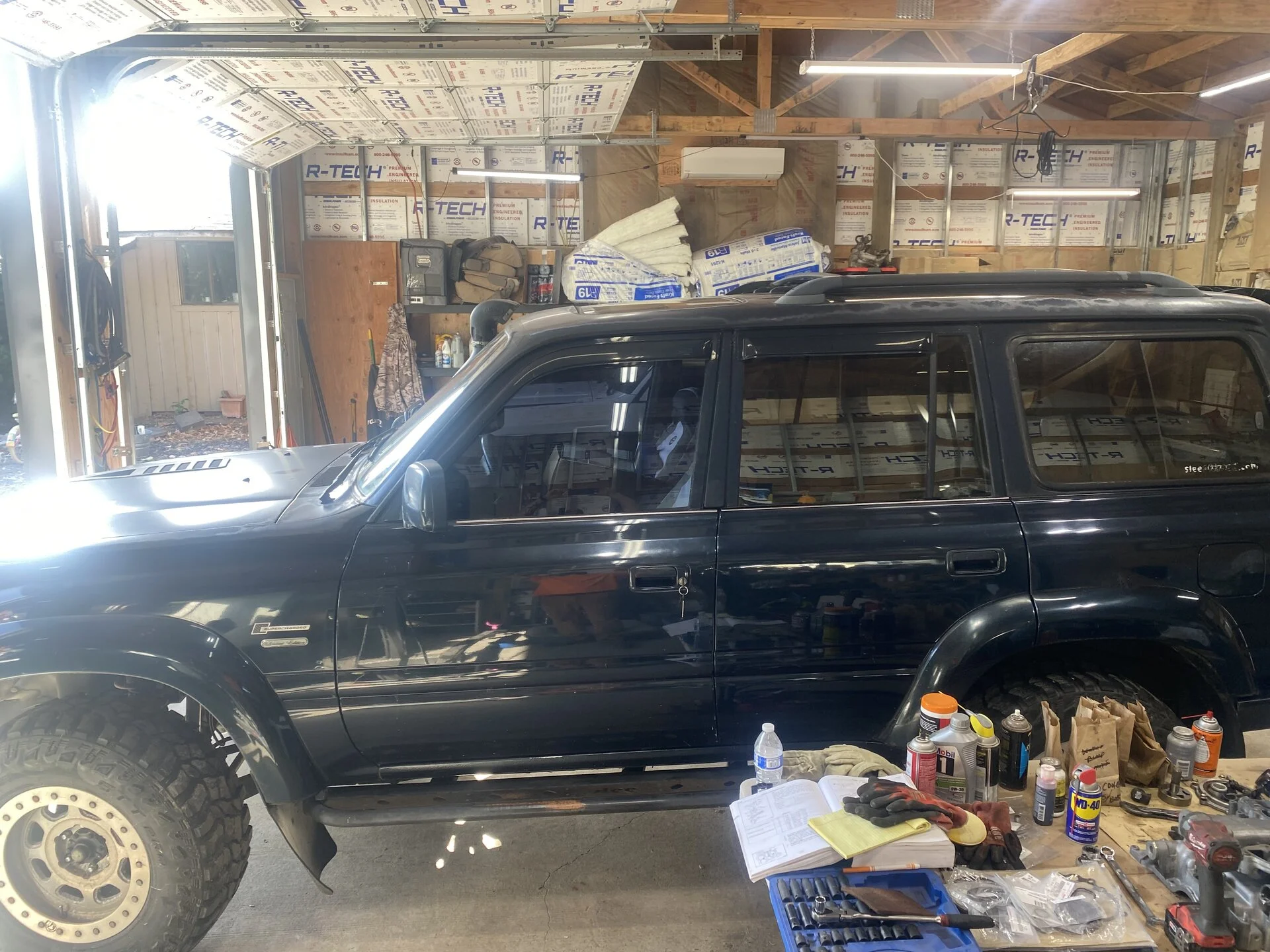

Front end rebuild, little brake refresh, rear window rust fix and seal replacement.
Brake components and knuckle kit from @cruiseroutfit
High strength knuckle studs and hardware from @landtank
Accidentally bought the wrong window seal, this one has a cutout for a chrome trim piece. Oh well

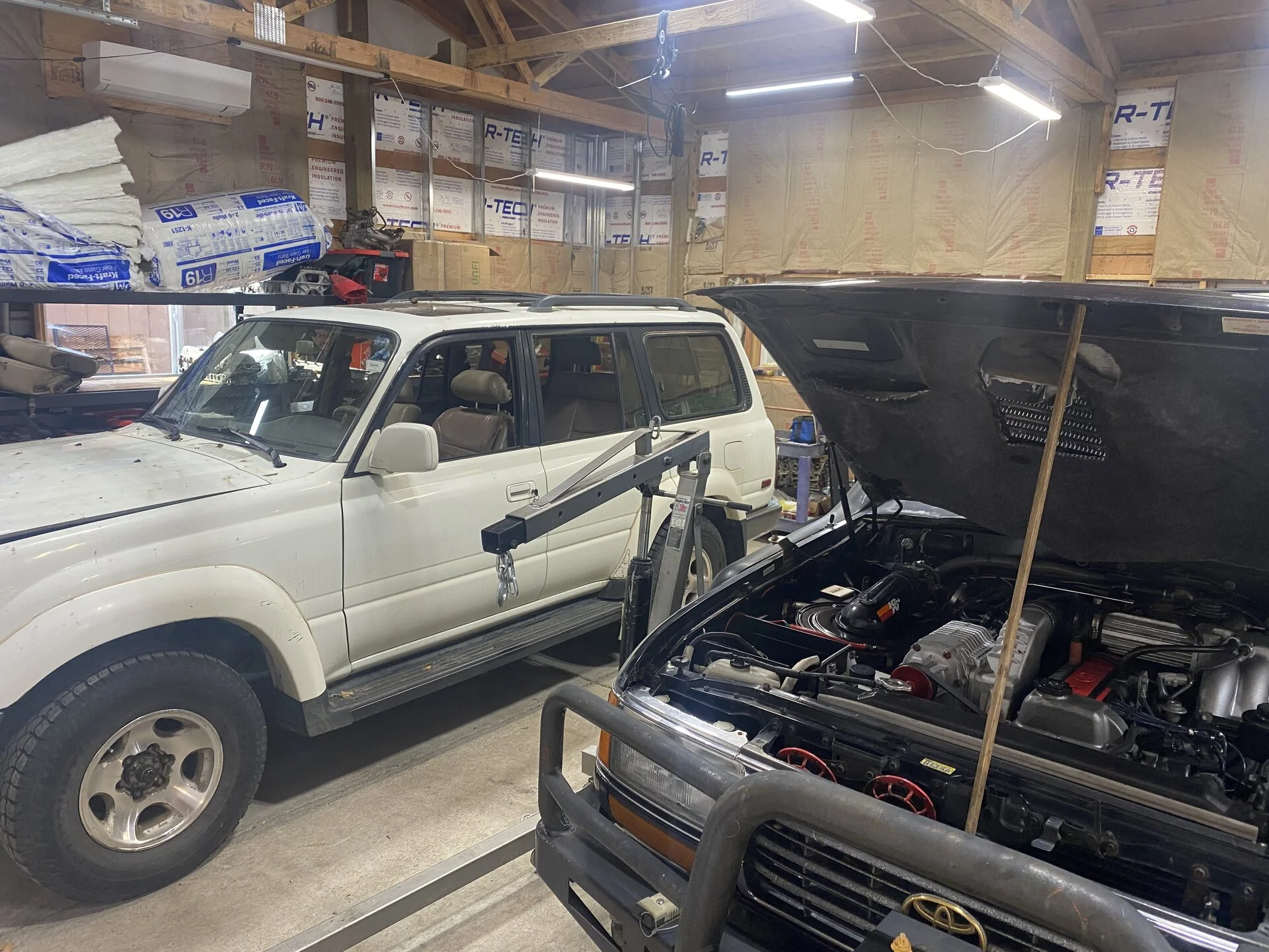

Useful for an electric winch too, since the alternator doesn't make crap for power at idle
Let me know if the supercharger needs a new home 😎
I’m keeping this one gonna sell my locked collectors edition unfortunately. Can’t keep two cruisers like some people! ⬆️

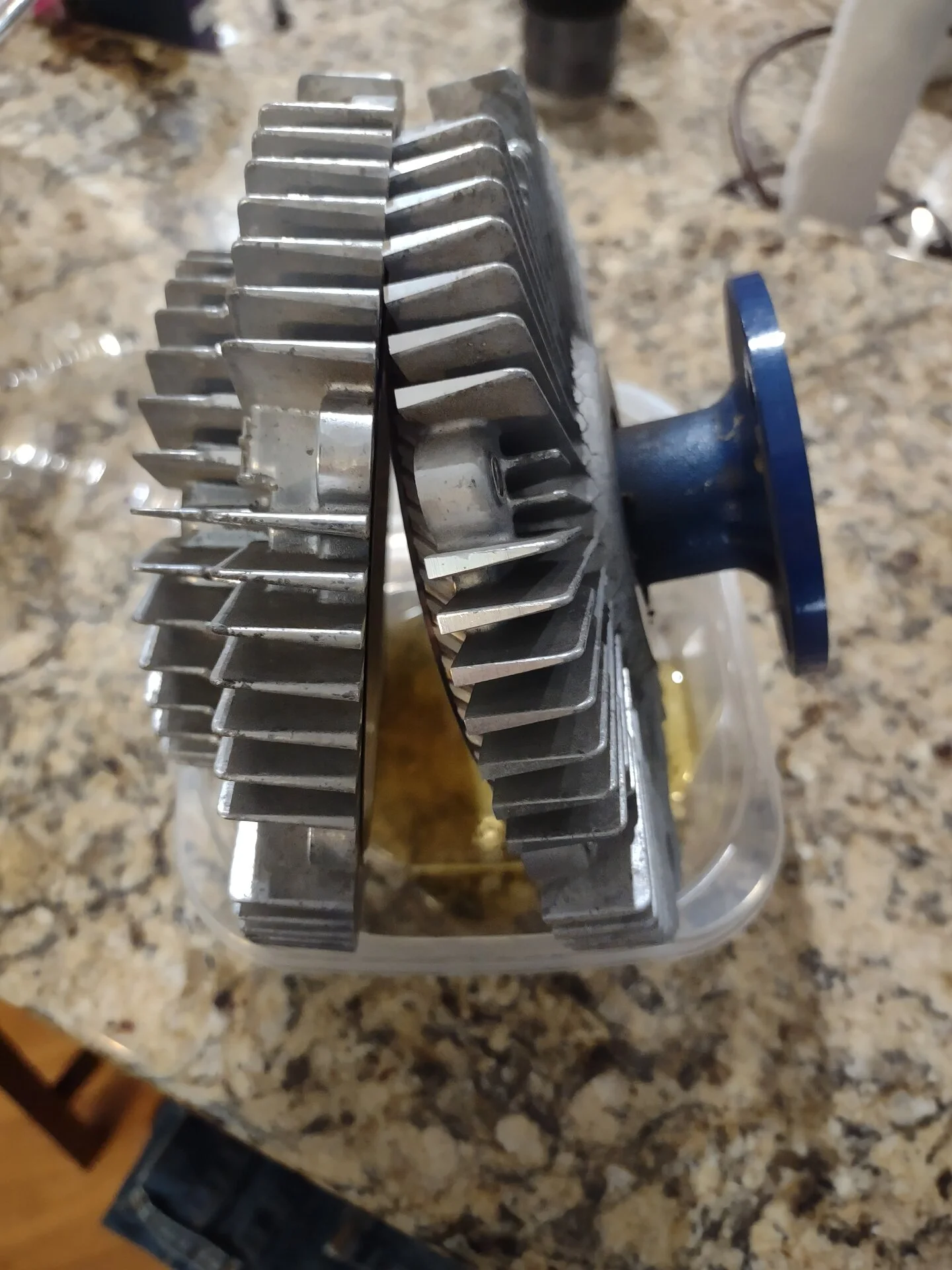

2) Modded my Aisin blue hub fan clutch I bought from Amazon and installed two years ago and it wasn't doing its job. Set it up to open earlier and added 55 ml of 15 K CST oil to it. Works better so far. Will give it a 3 hour tour tomorrow.

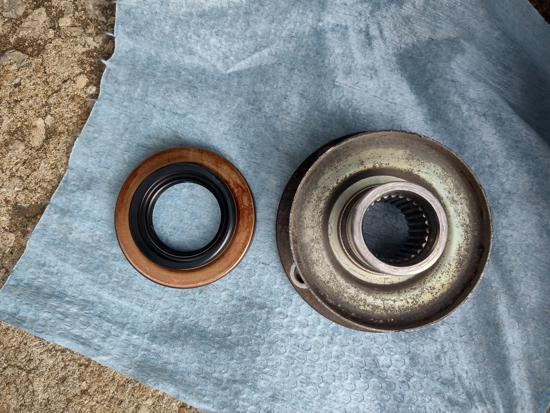

3) Replaced the front pinion seal with Toyota seal. I discovered the seal that came out was an NGK seal so the PO has something done there previously. This had been leaking for a long while. I finally got tired of it drooling everywhere and having to add oil every week.

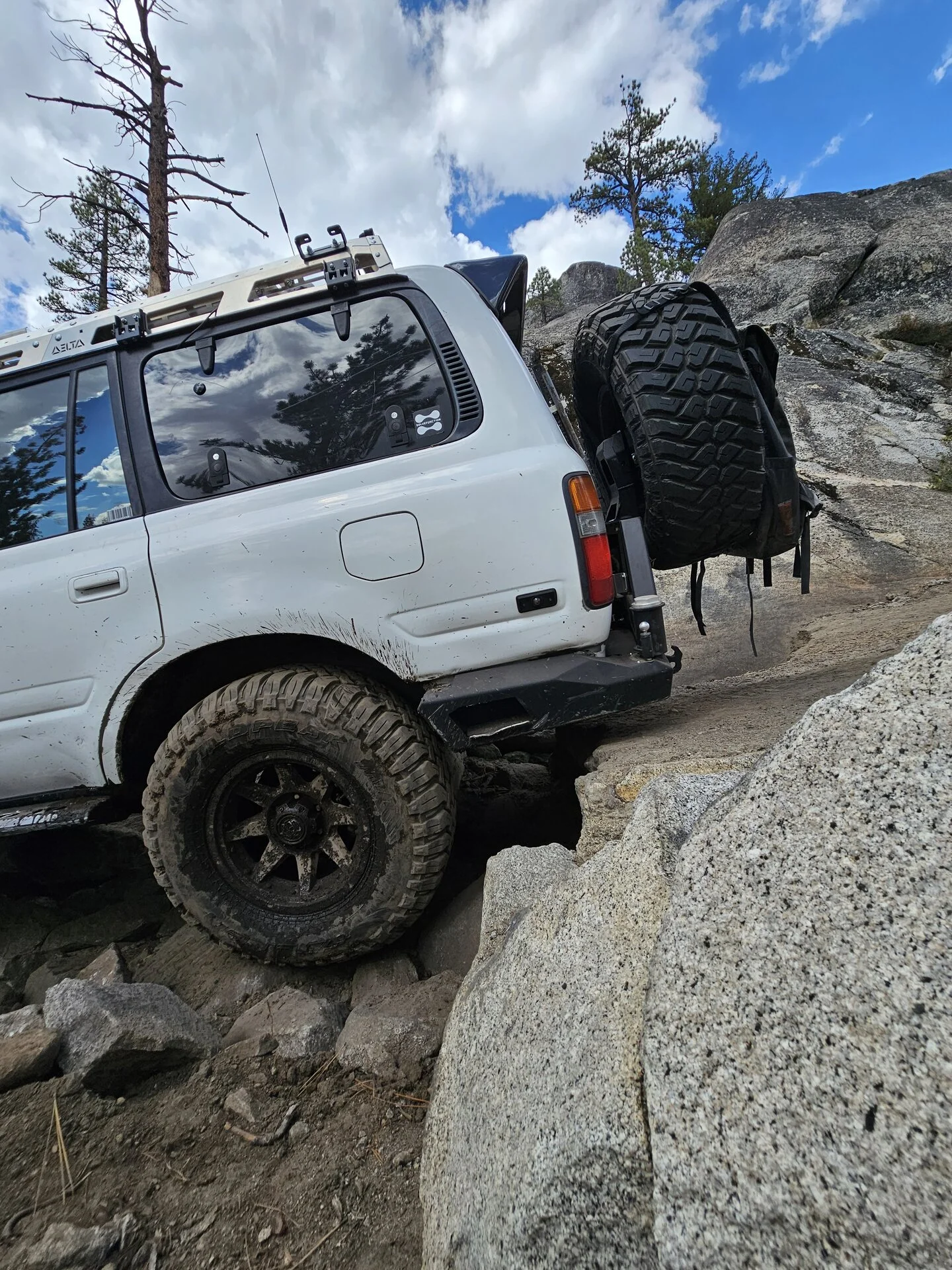

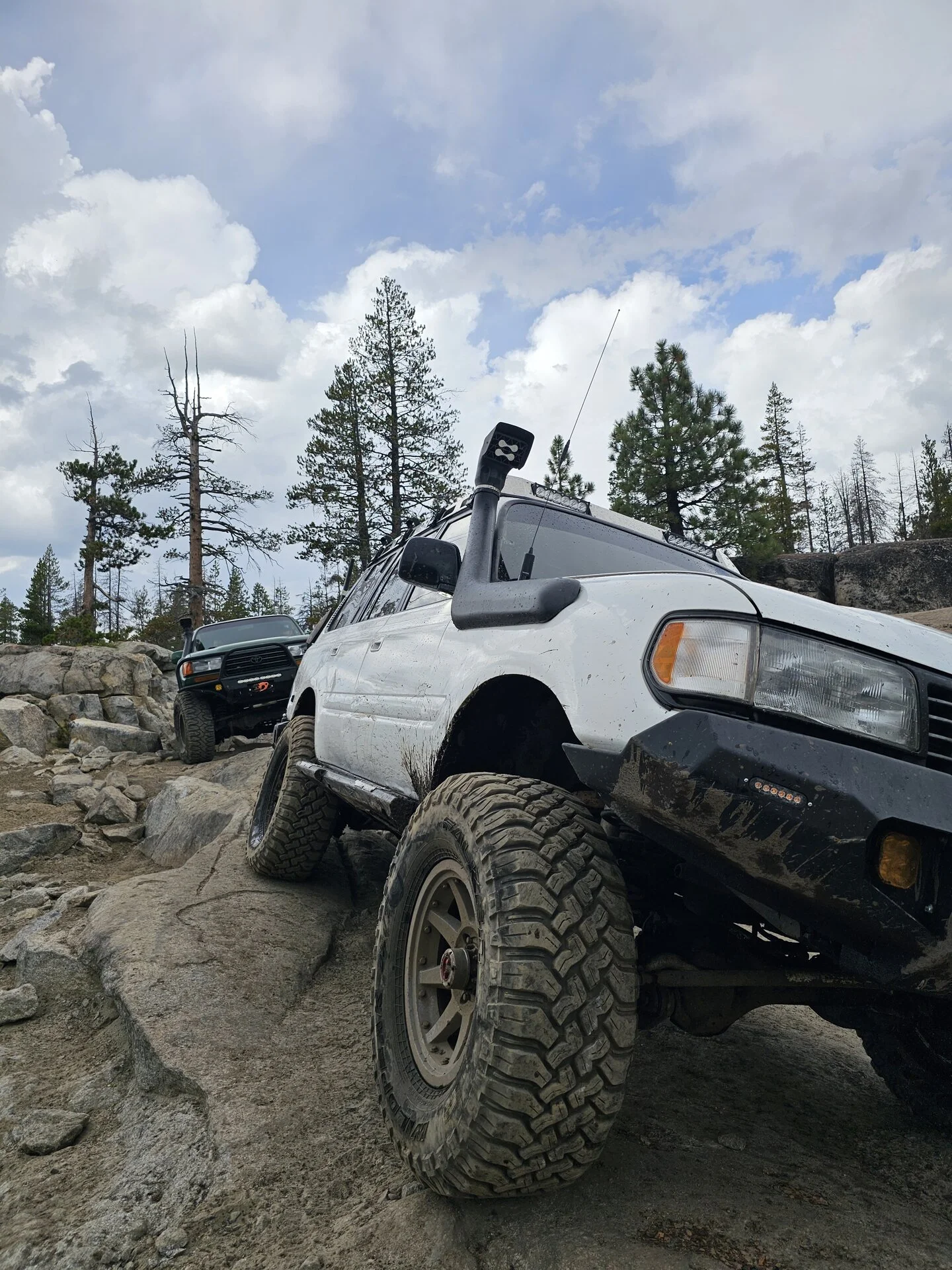

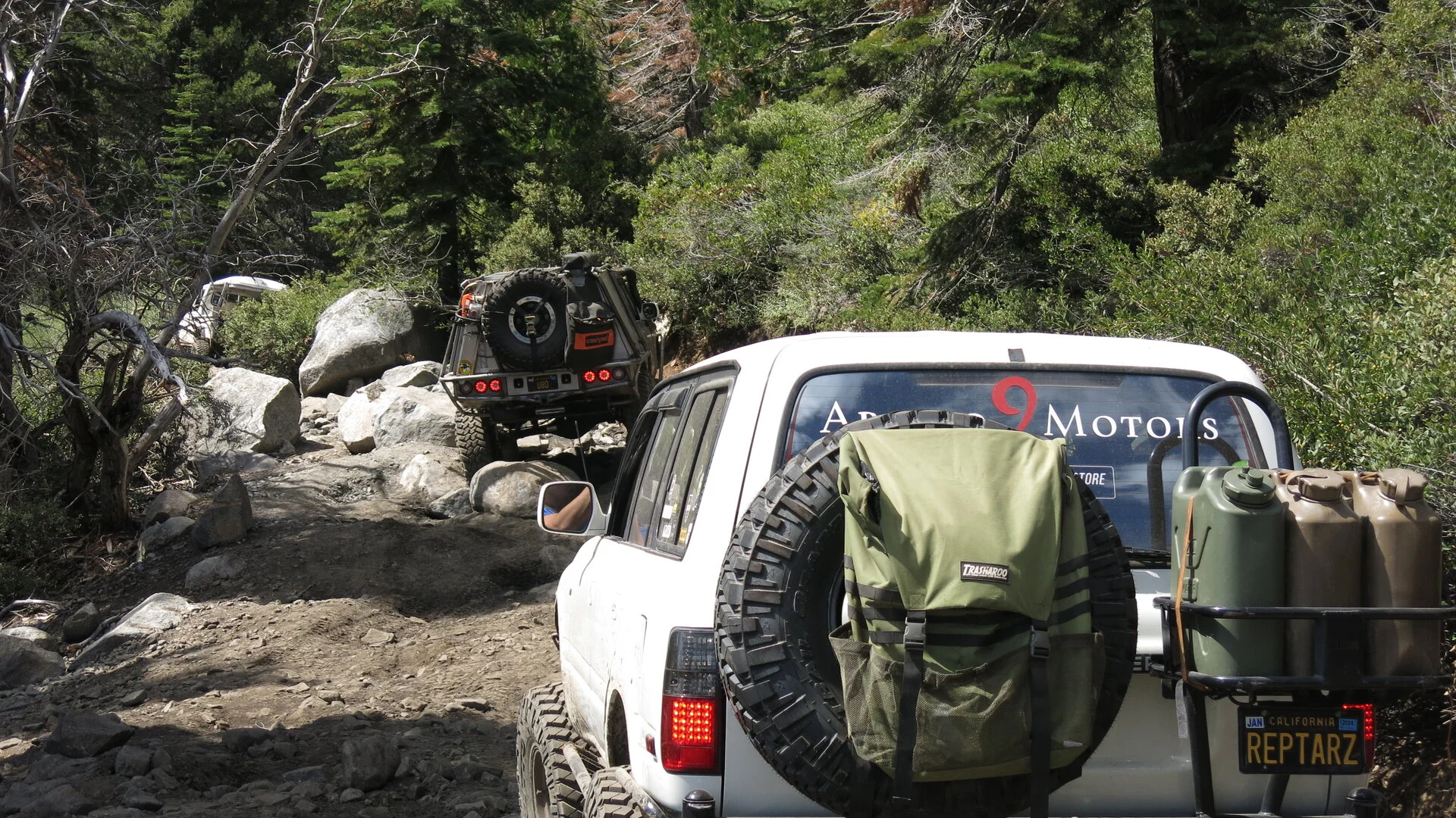

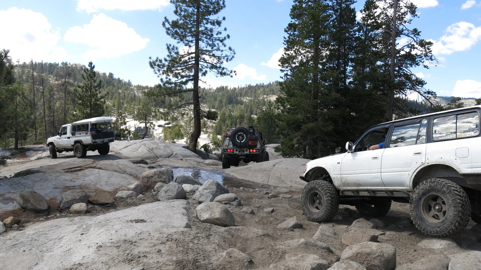

Went and did a little exploring and camping with some friends. Summer is almost over here in the PNW and this was probably my last camping trip for the year.
Nice.
I'm in Vancouver and some bussies and I are heading out this upcoming weekend for "the last" long weekend before the rain and cold sets in.
I think I wouldn't mind cold camping but I need to get a little heater for my tent.

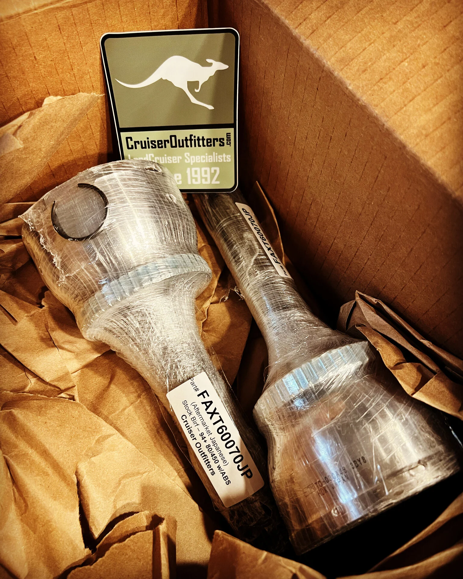

Got new Birfs.
Ordered them from @cruiseroutfit on Thursday, and they were on my doorstep Saturday evening.
Mine aren’t “clicking” but since I have a front end rebuild that I want to do (the knuckles are seeping), and I’ll be in there already, I might as well swap them out.

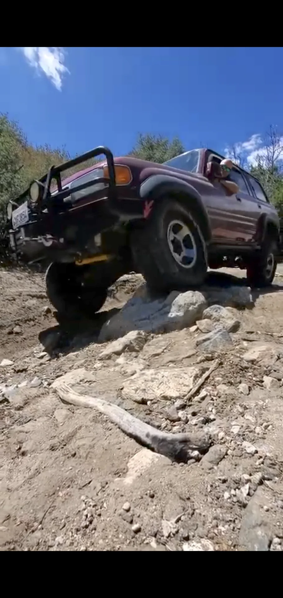

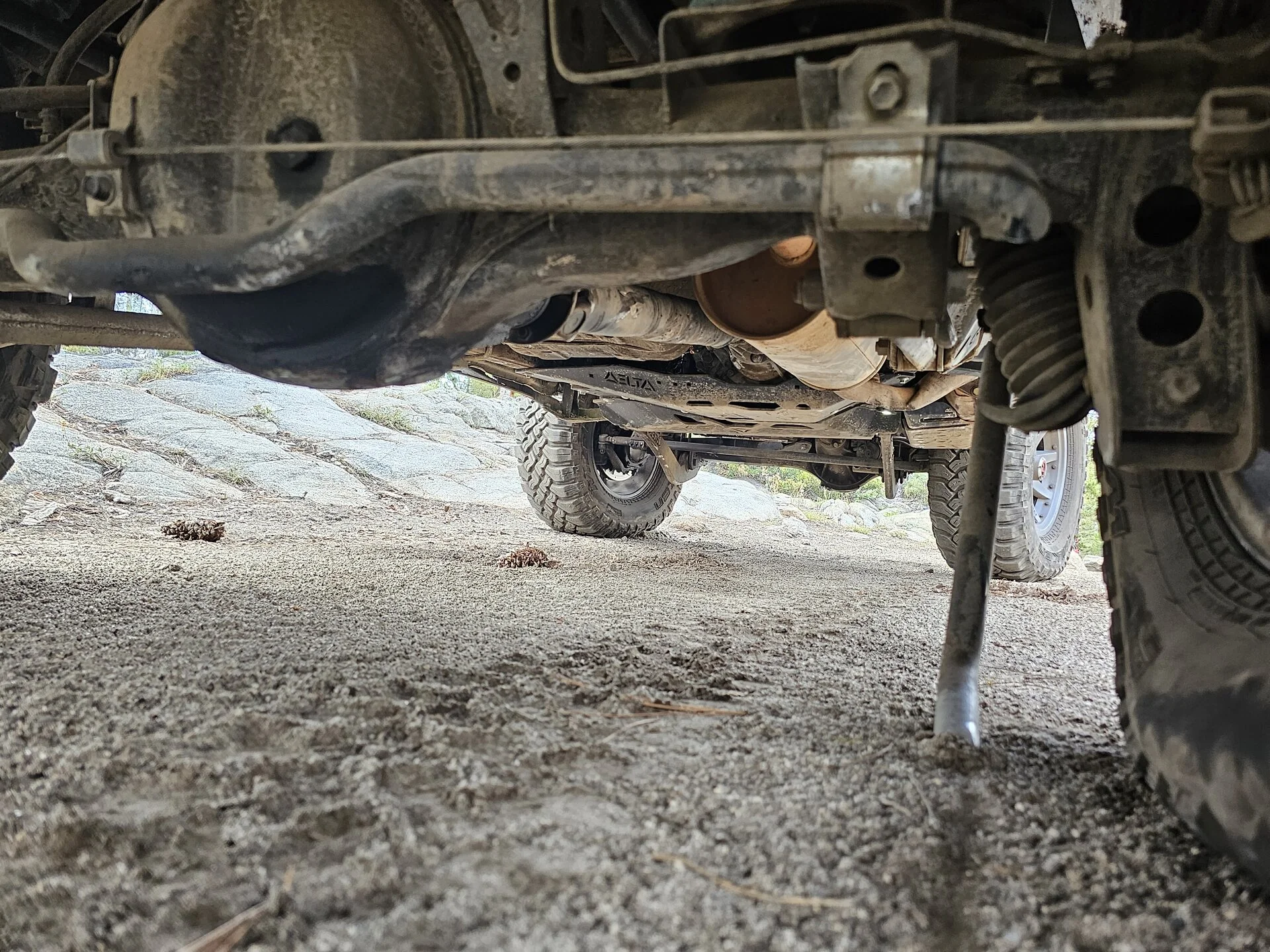

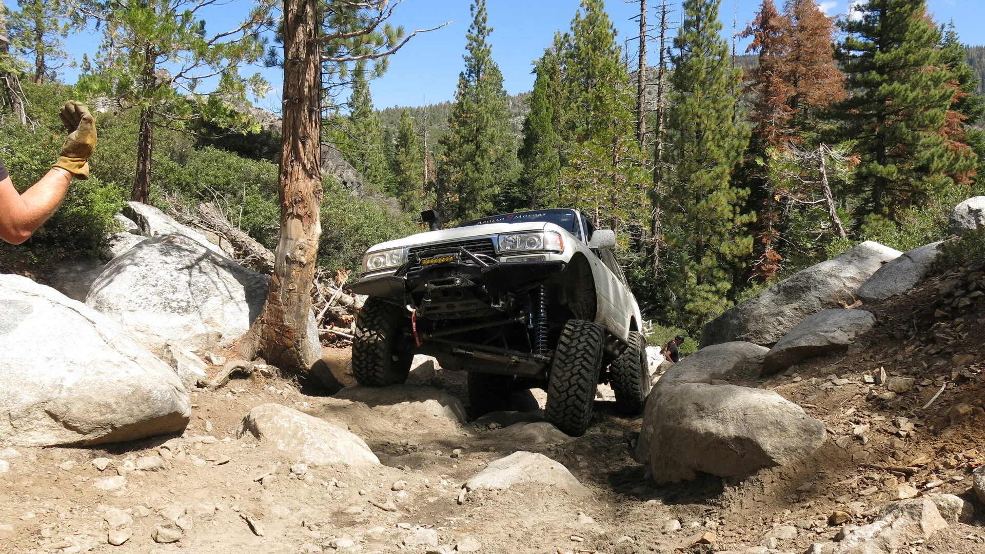

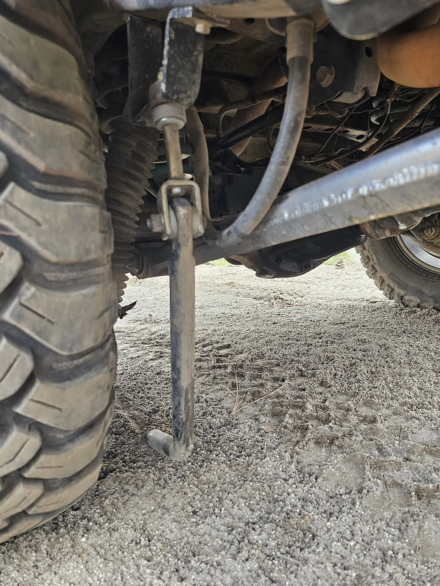

Took my half-built 80 (work in progress) out on some steep stuff this weekend, found a flex-induced sound that sounds like it's coming from the front end. I've got about a 3" lift with an ARB front bumper and 12k winch with steel cable. PFA:
Here is what I've done to the front so far:
2850 coils (new)
30 mm spacers
60070L shocks (new)
Slee caster plates (new) *
Toyota radius arm bushings (new)
Rotors and pads (new)
I also rebuilt the knuckles and seals and verified everything was torqued to spec, and checked after 500 miles.
I am considering replacing the 4 tie rods, and panhard bushings, otherwise the front end is almost all new.
*The tie rod is very close to the radius arms and looks like it contacts it on droop - need to address this, too.
The sound does not happen on the street/highway and seems to come and go off-road. Mostly when there is lateral movement, sounds like a loose shock (they are not loose) or spring, but neither are... motor and trans mounts look good, too.
I have yet to throw the truck on a rack and let the suspension hang/shake it down, and I've not replaced the front panhard bushings.
Any thoughts/advice?

Springs can definitely flex, pop, and make some noise when your flexing. If that's what your hearing than don't sweat it.

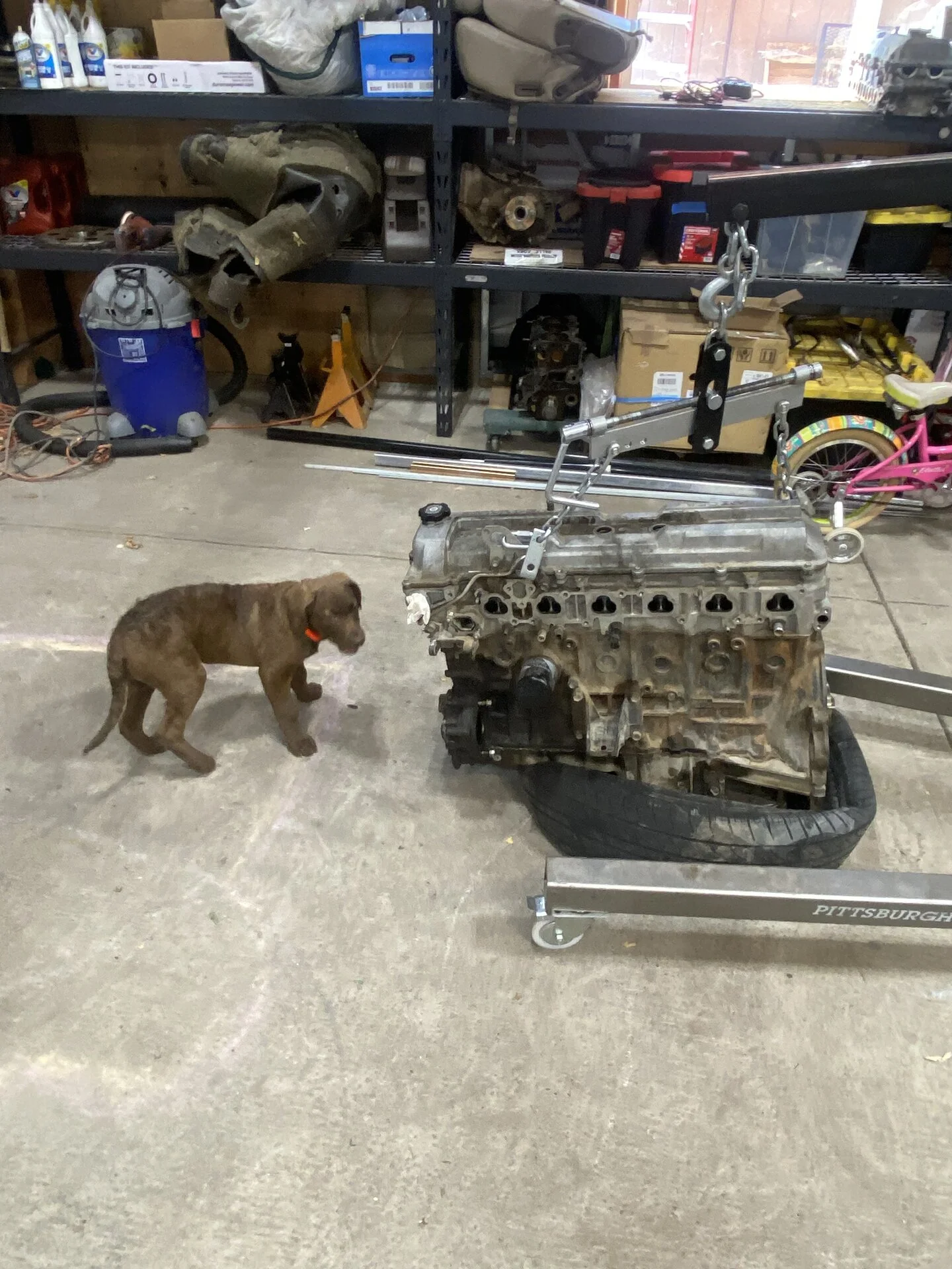

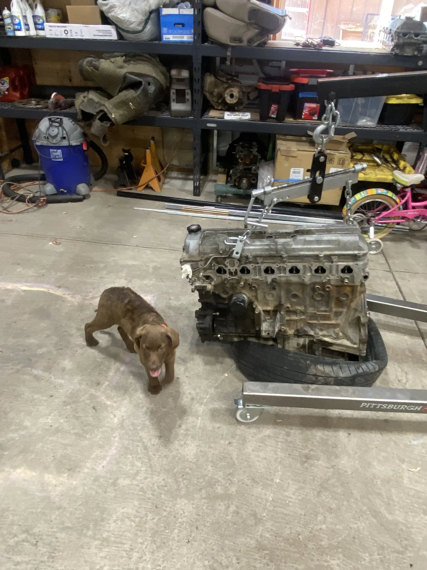

Chesapeake bay retriever
Bad a** dog. Definitely tough as they come, greasy too 🤣.
My first dog was a chessie, dad brought him home when I was 8. He would sit in his corner of the family room and thump his tail on the wall until it was bleeding.

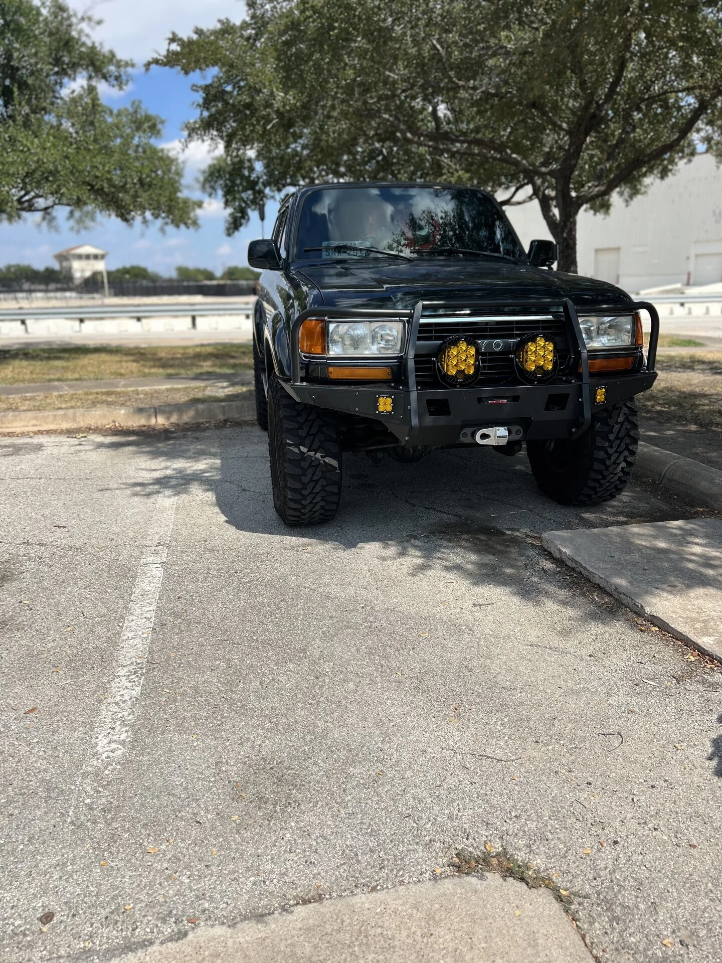

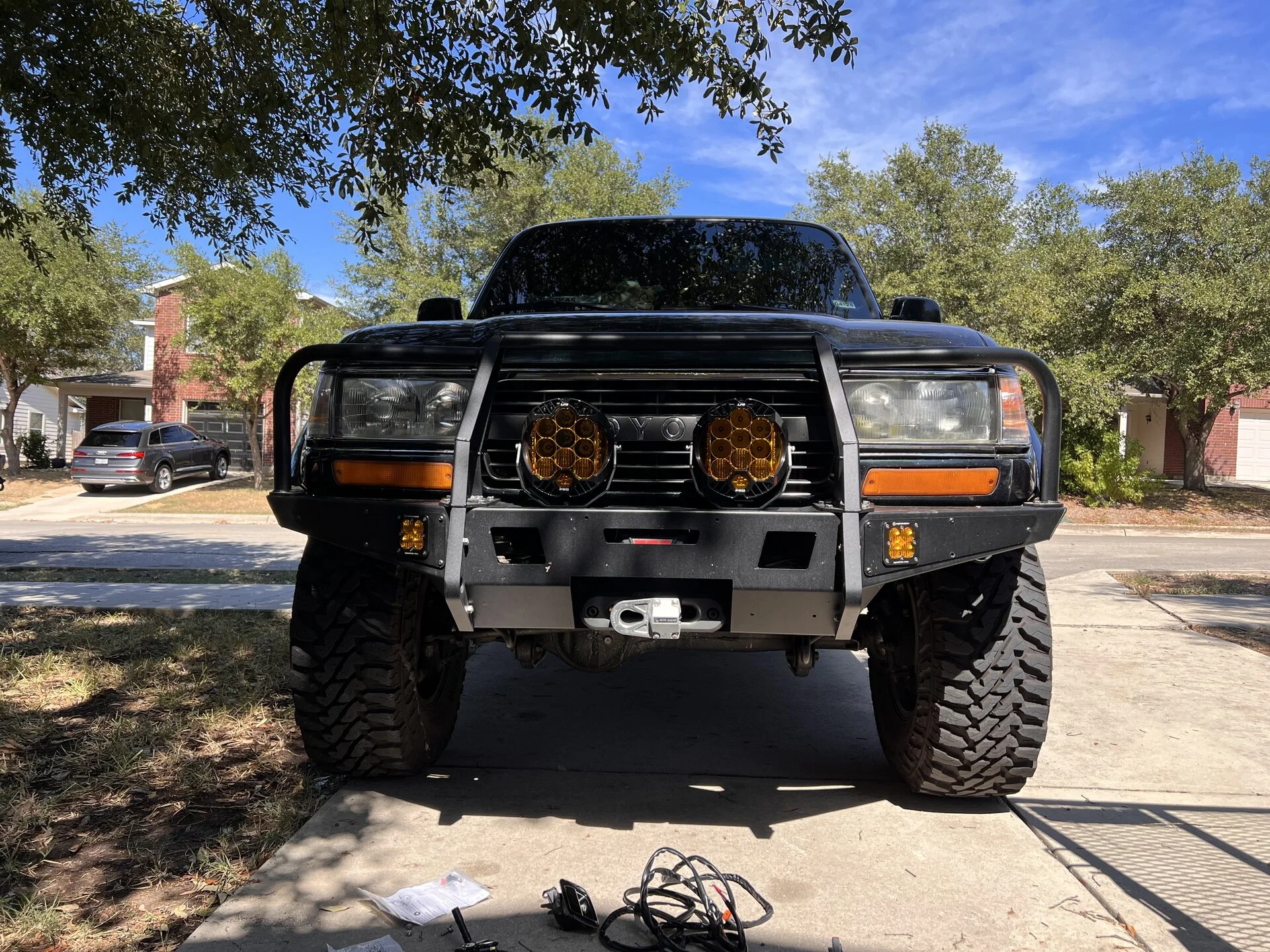

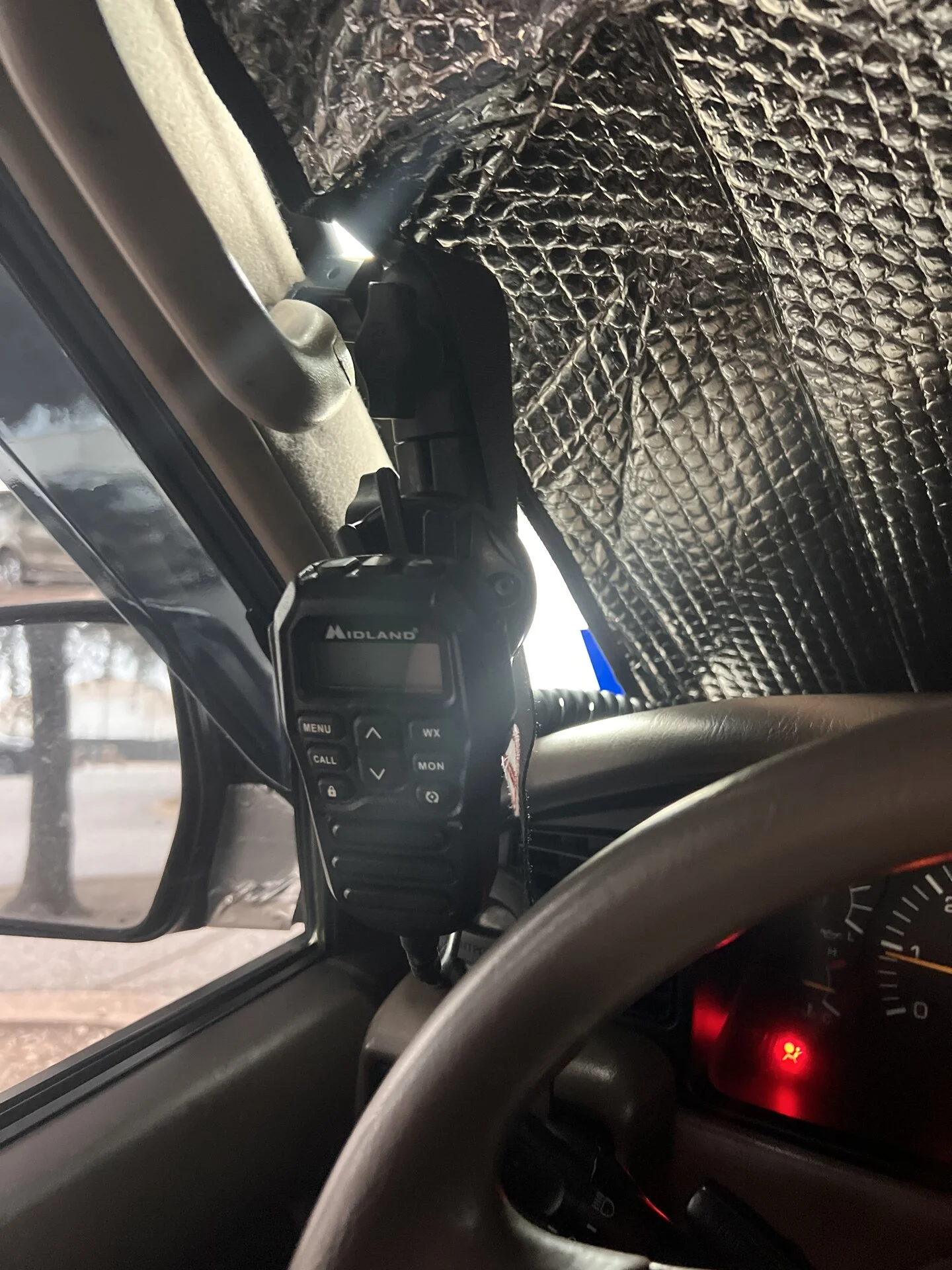

Busy weekend…
Baja squadron pros
LP9s
Switch pro and DELTA mount
GMRS antennae mounted
Rear hatch mount with the Wii boost ant
New turn signal housings
Rosen visors and visor plugs
Amber corners
DS floppy mirror fixed with Whitts end FMF
Replaced the vapor canister which finally cleared my p401 code
And next weekend is the big project…
