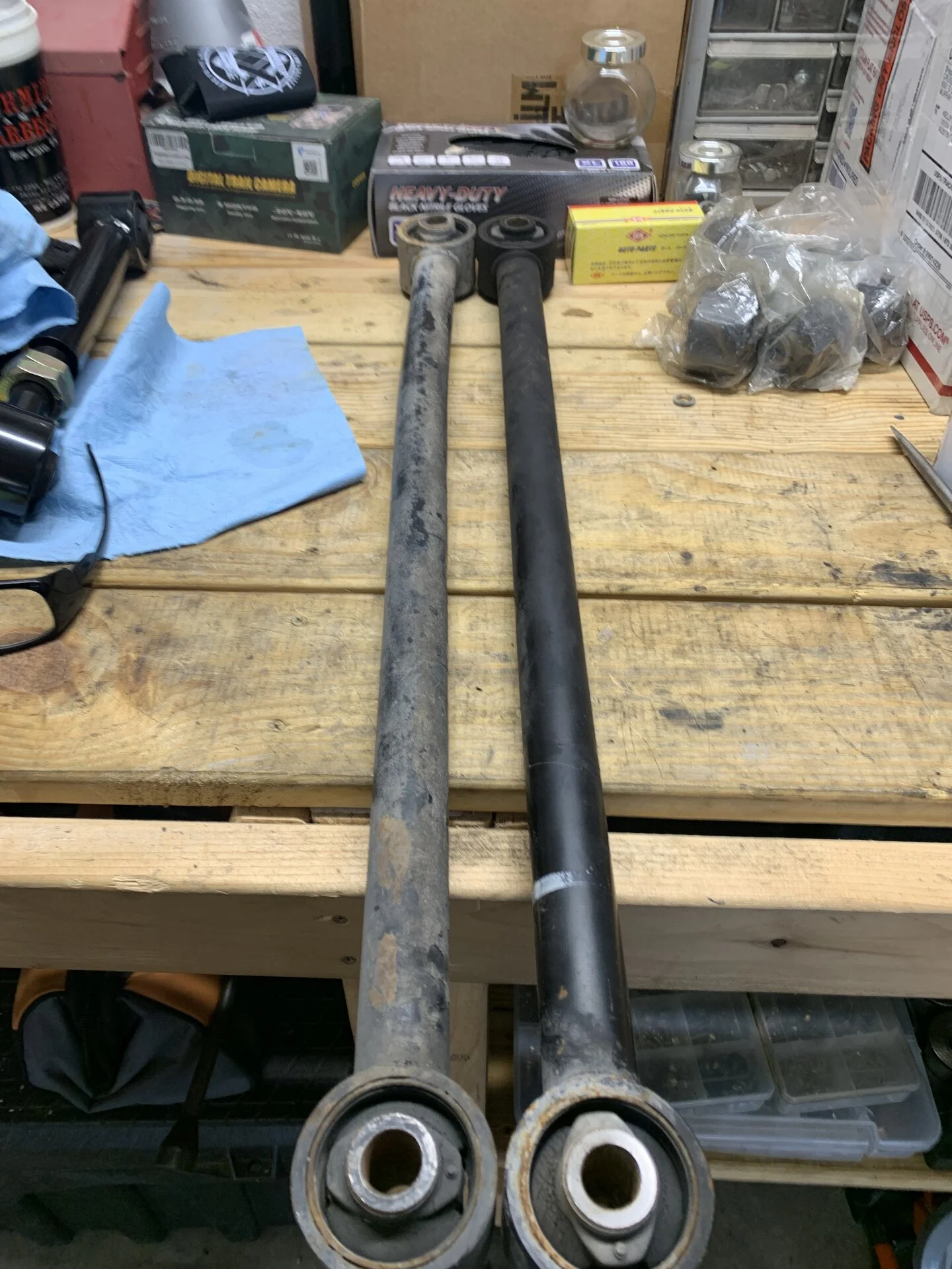

Looks great man. Are the factory knuckle studs known to be weak? I am curious why you used Landtank ones. I am about to rebuild my front axle so thought I'd ask.Front end rebuild, little brake refresh, rear window rust fix and seal replacement.
Brake components and knuckle kit from @cruiseroutfit
High strength knuckle studs and hardware from @landtank
Accidentally bought the wrong window seal, this one has a cutout for a chrome trim piece. Oh well
It's a little bit of a rabbit hole. It's worth reading some of the past threads on it. No I don't think factory is weak per se.Looks great man. Are the factory knuckle studs known to be weak? I am curious why you used Landtank ones. I am about to rebuild my front axle so thought I'd ask.

Im so glad I asked you. I really appreciate you taking the time with all those links and info man!It's a little bit of a rabbit hole. It's worth reading some of the past threads on it. No I don't think factory is weak per se.

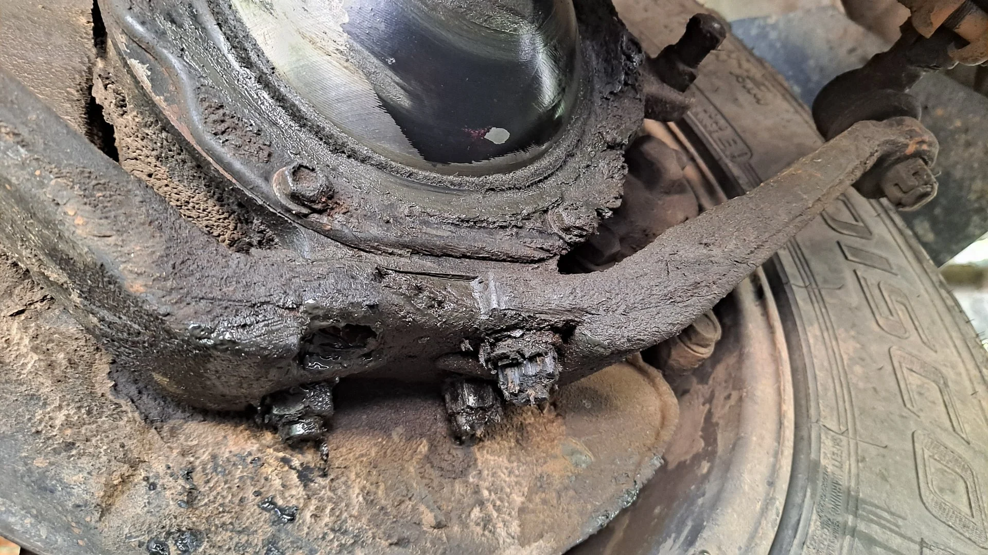

Broken knuckle stud - getting set to rebuild knuckles
I have a knuckle rebuild kit, and planning on doing this job next week. I was just under the truck wiping off grease from the knuckles and relocating my (clogged) diff breather. While wiping grease I found that the passenger side forward inner knuckle stud was sheared off! The nut was...forum.ih8mud.com

It happened to me...Loose then broken knuckle studs.

Again: Check your Knuckle-Nuts ;-)

I'm not an expert by any means but from what I've read, you can go OEM or you can upgrade to Landtank or ARP.
My 80 by all appearances lived a pretty tame life for the first 150K miles in Japan on stock tires. I added 35s and within a few months I had sheared off one of the stock studs in the knuckle, not even wheeling that hard.
Lots of opinions of course but to me it seemed that being very careful to clean out the knuckle threads, install the studs and nuts with proper torque, and check it periodically, you should be fine. Landtank claims that on his studs they're higher strength and have more of a shoulder for the cone washer to engage on.. figured I'd give it a try.

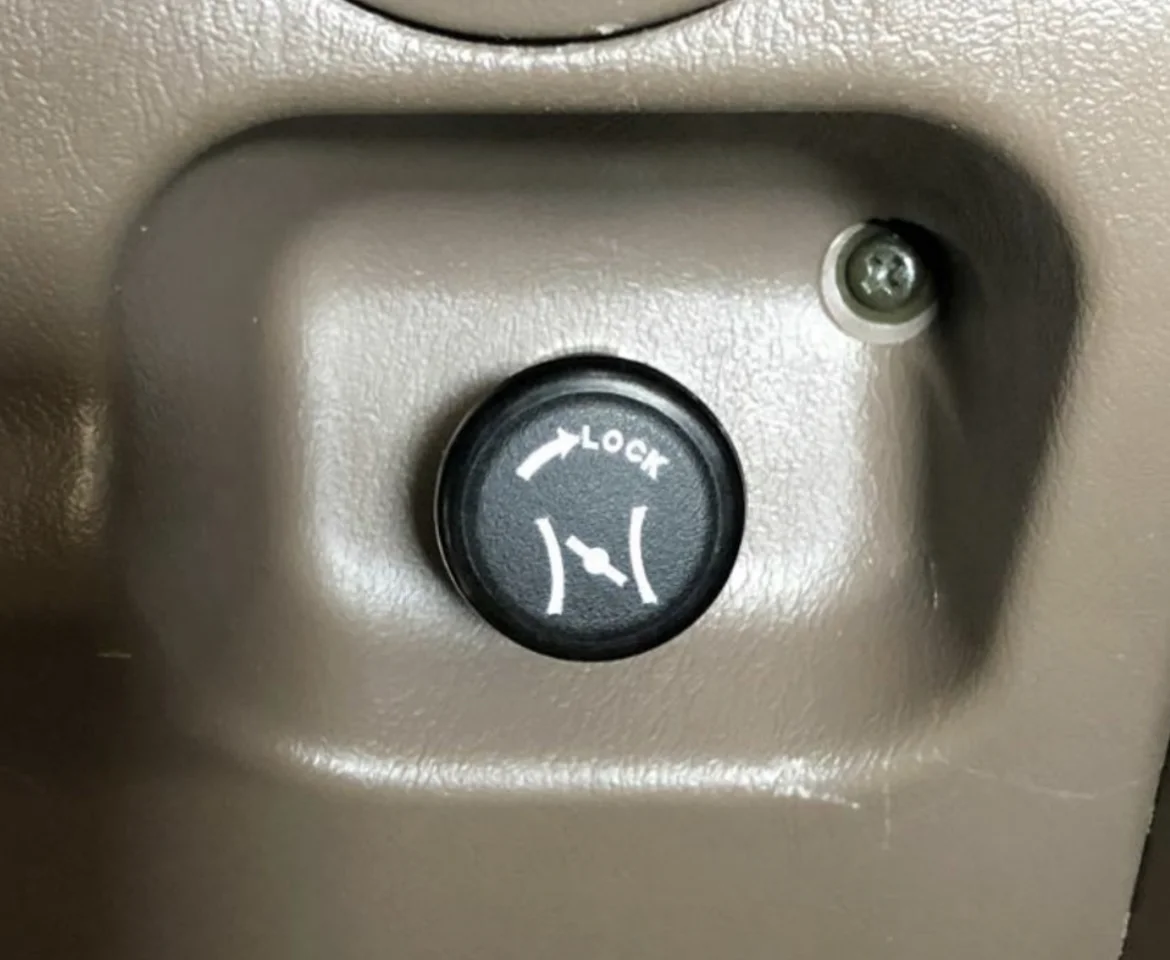

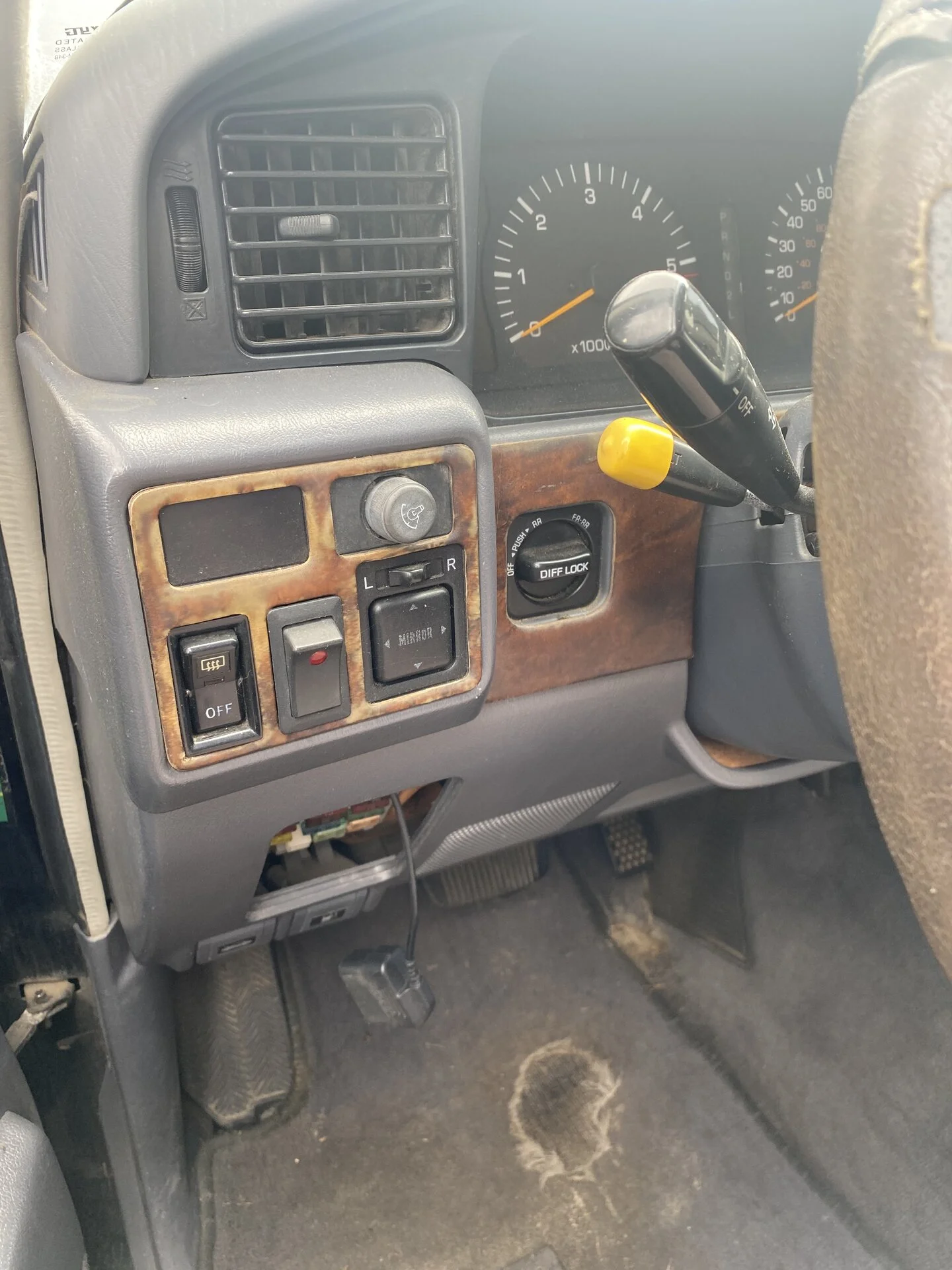

I don’t have one. Didn’t start the throttle talk eitherwhat’s it for if u 1. Have an auto 2. No pto winch 3. Have cruise control
Useful for an electric winch too, since the alternator doesn't make crap for power at idleI don’t have one. Didn’t start the throttle talk either![]()

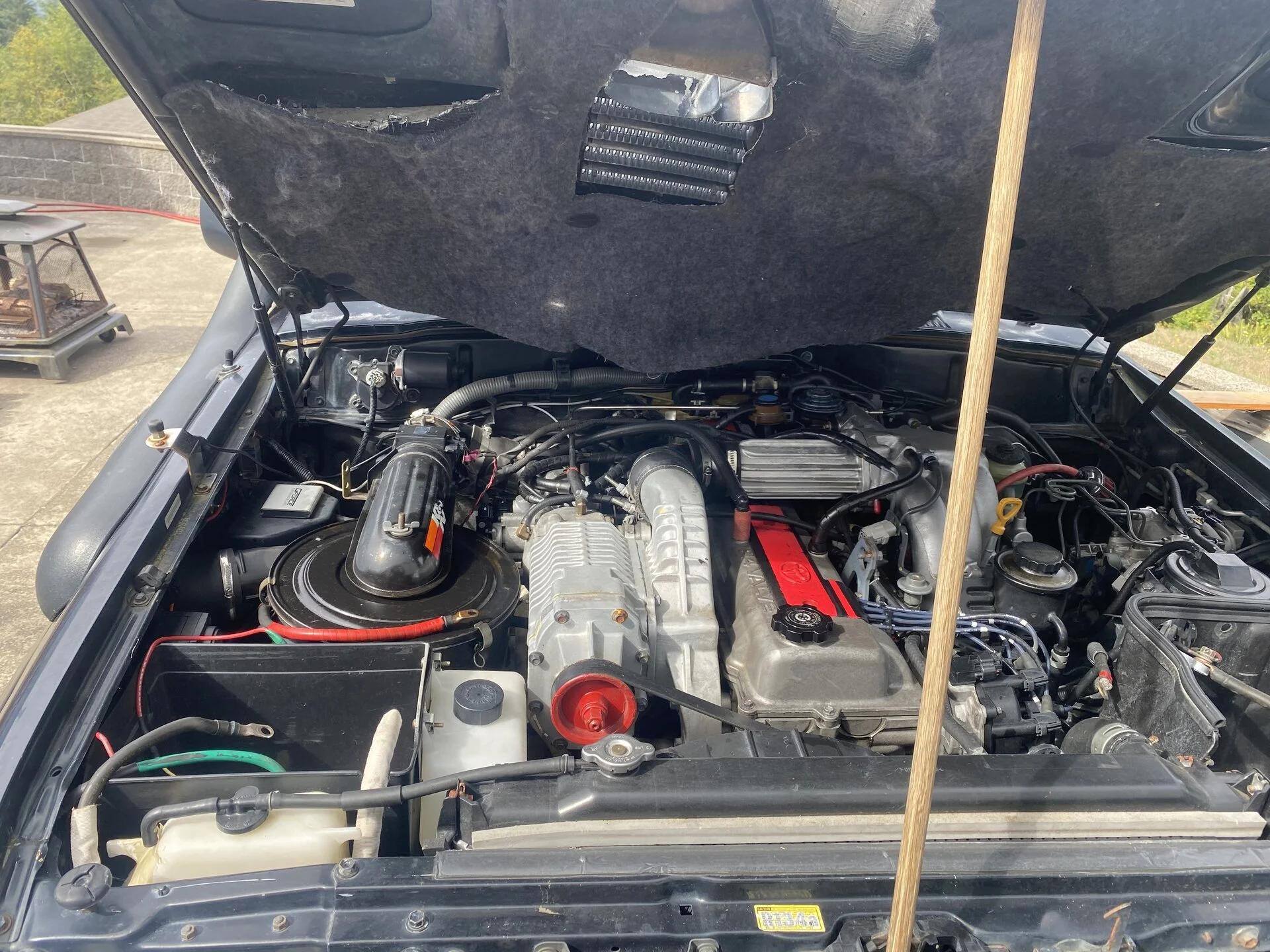

Let me know if the supercharger needs a new homeMan I am so pumped today!!! Picked up a 2nd owner since 95 factory locked. super charged since 150k. Currently has 469xxx miles not running but it will be!. This might be the highest mileage 80 series mud has seen?
Idle up the motor while running an electric winch or even charging your neighbors battery.what’s it for if u 1. Have an auto 2. No pto winch 3. Have cruise control

To what torque did you tighten the Landtank knuckle studs?Front end rebuild, little brake refresh, rear window rust fix and seal replacement.
