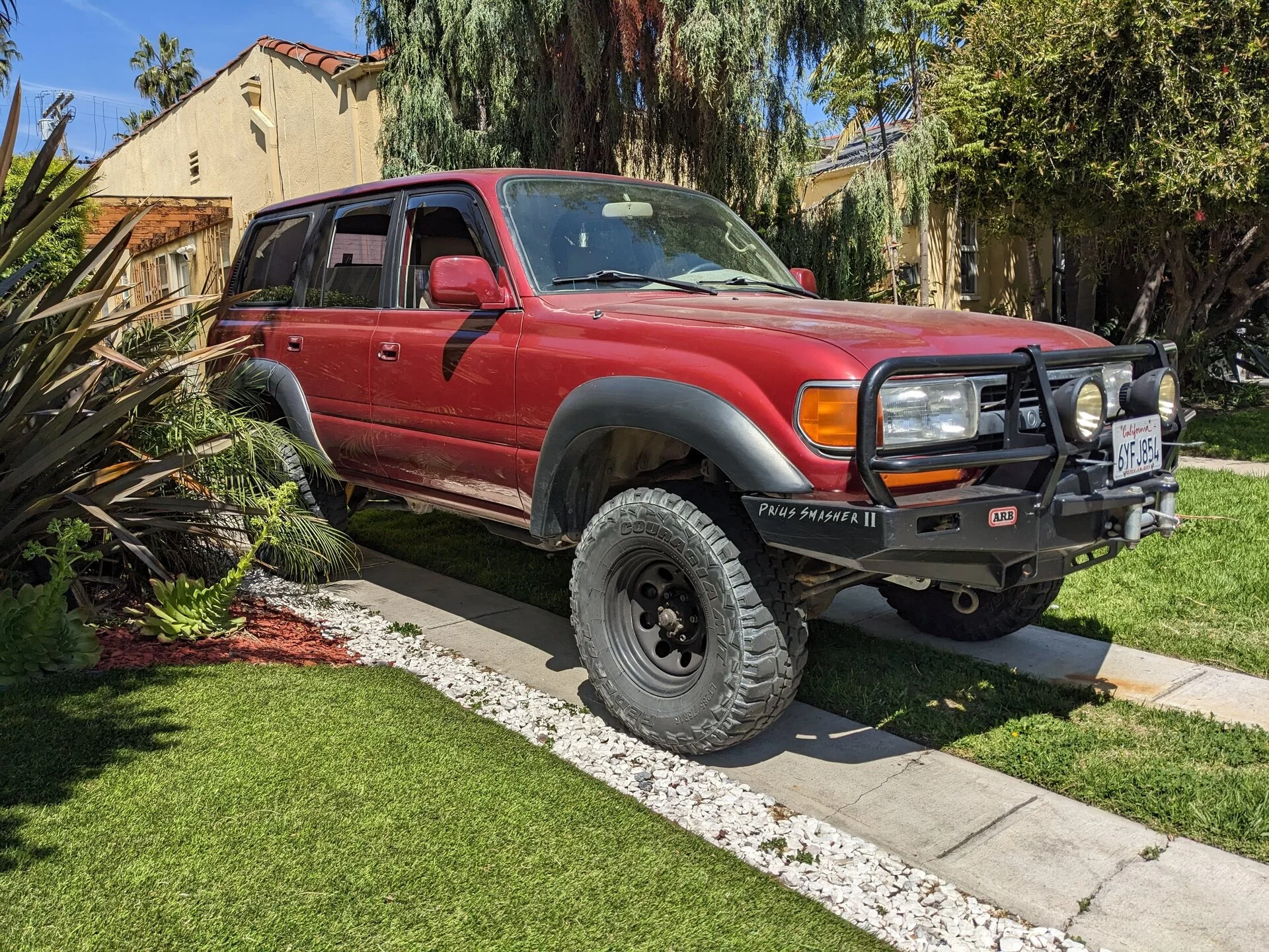

I bought this truck off a fellow (he might still be here) back in Feb of this year, he called her "Ginger" and since she is red, why not keep the name. Compared to other 80s I looked at he had done some great work to her (new head, top-end rebuild, new cooling system, hoses and radiator, baby suspension) so I knew I had some good bones to work with, and NO rust. Ginger was center lock diff from the factory, the PO added a Spartan locker to the rear diff, it's great off-road but eh on the street - maybe she will become triple locked one day.
Here are a few early pics:
(those are 285 MTs on 80 rims I use on the 4runner)

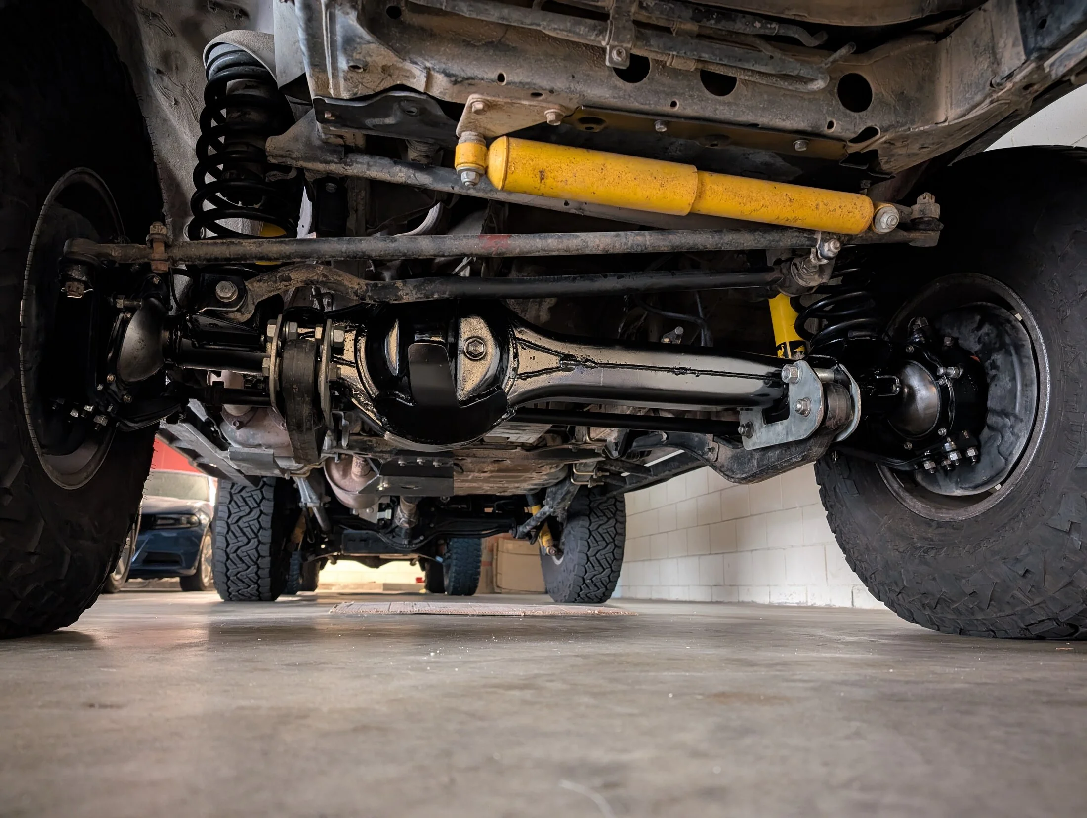

Here is how she sits today, September 2023, on Miller Heep Trail

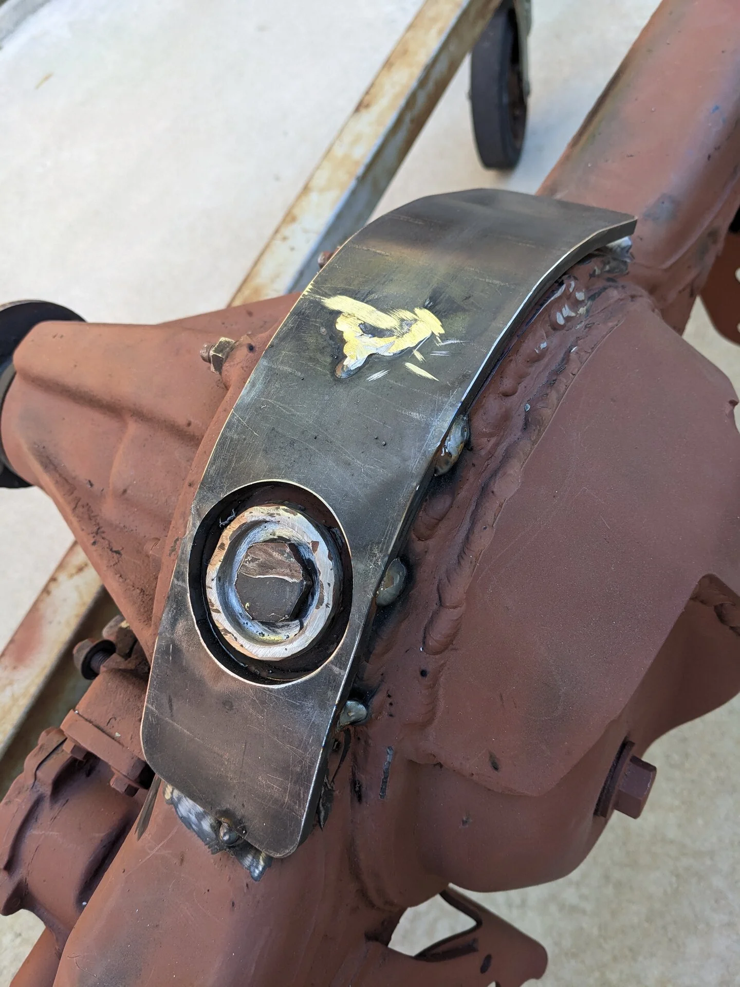

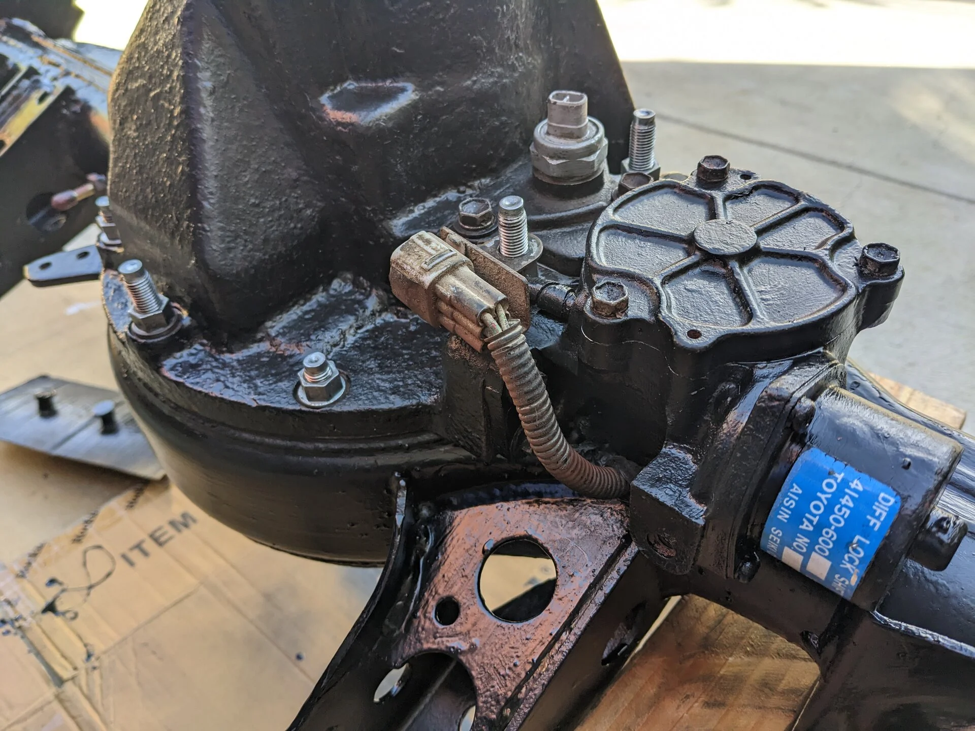

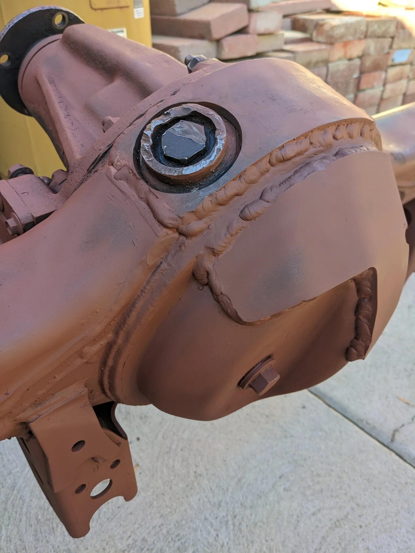

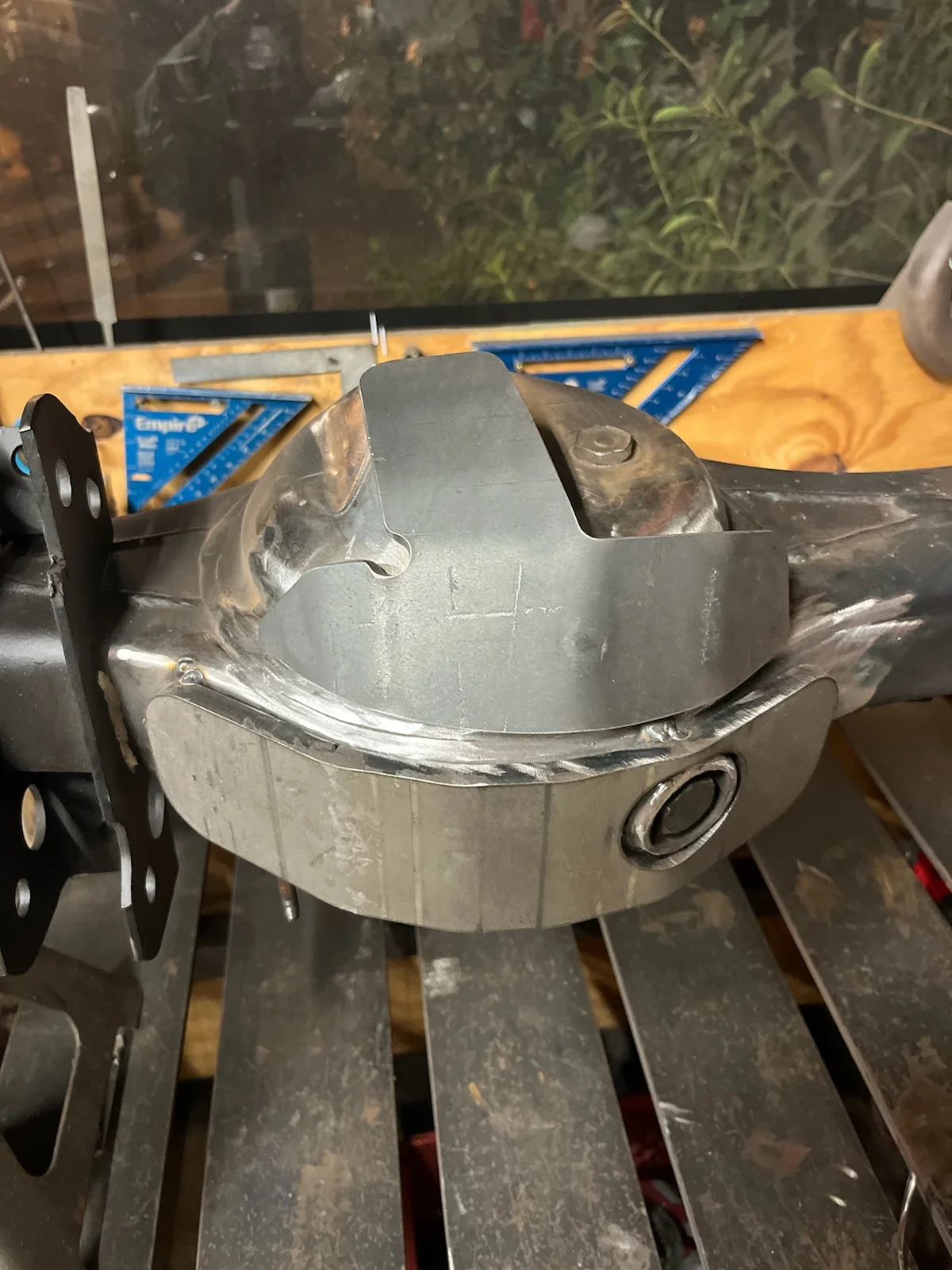

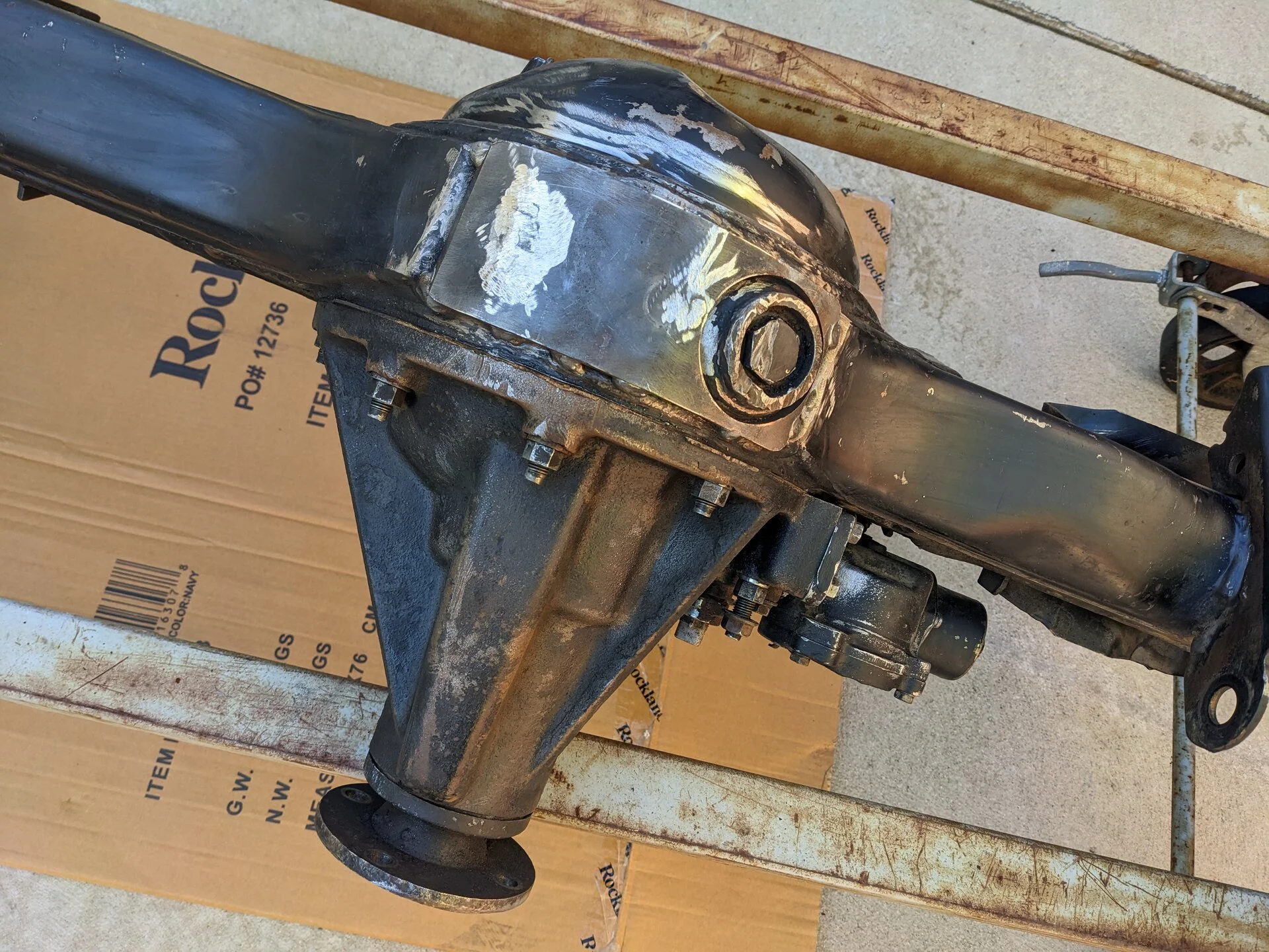

The bottom of the housing was recessed somewhat so I layered two rear plates and flushed the drain plug "dam" with the face of the second bottom strap
Then welded it slowly together and capped the gap, and painted

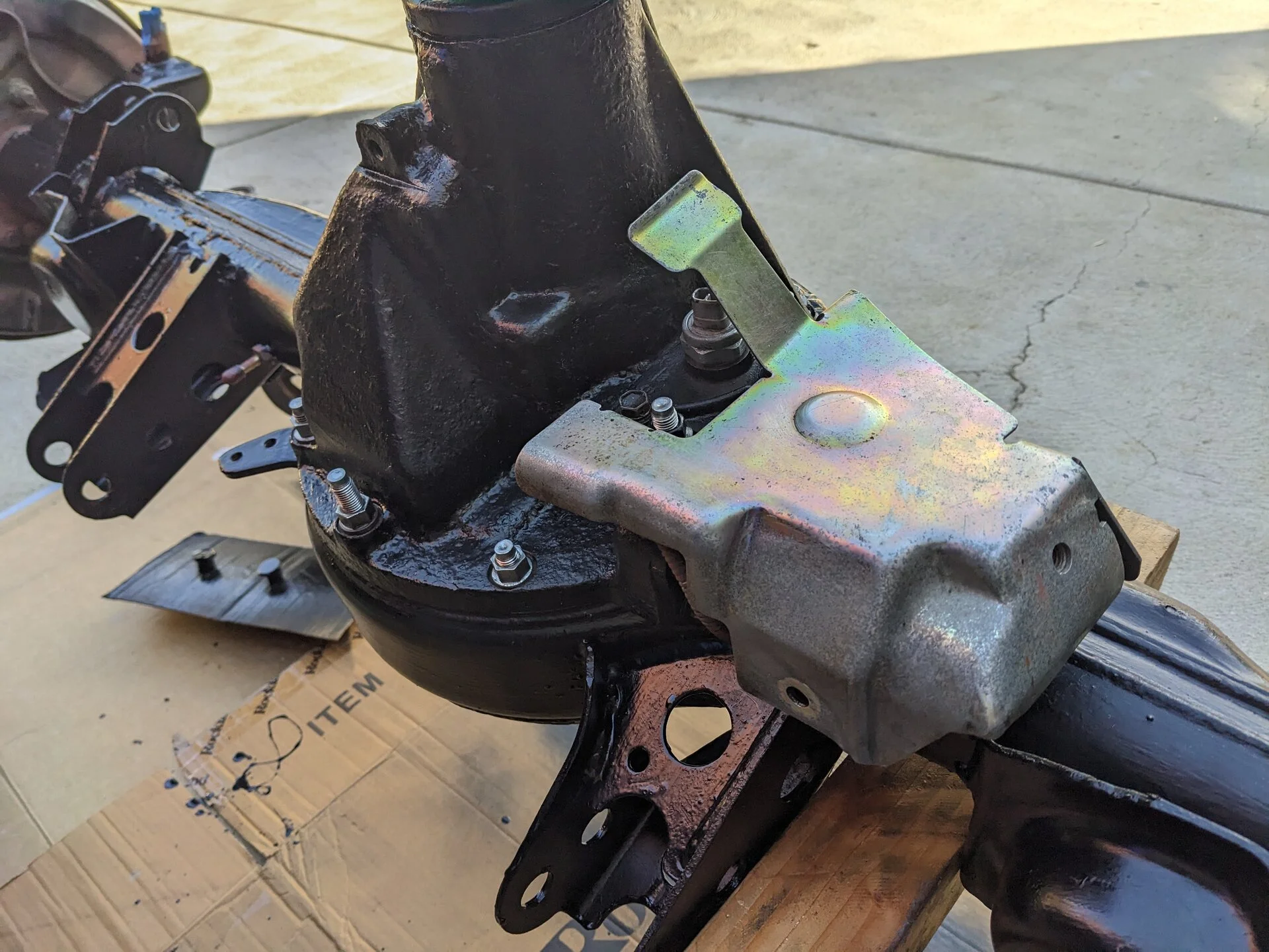

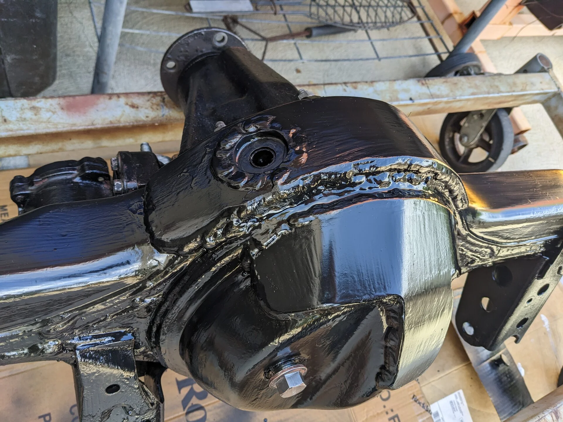

I pulled and resealed the 3rd member after everything and cleaned both mating surfaces, studs and fasteners. Inspected welds from the inside. Inspected gears, seals and locker actuator and reassembled.
E-locker gasket PN 42181-60070

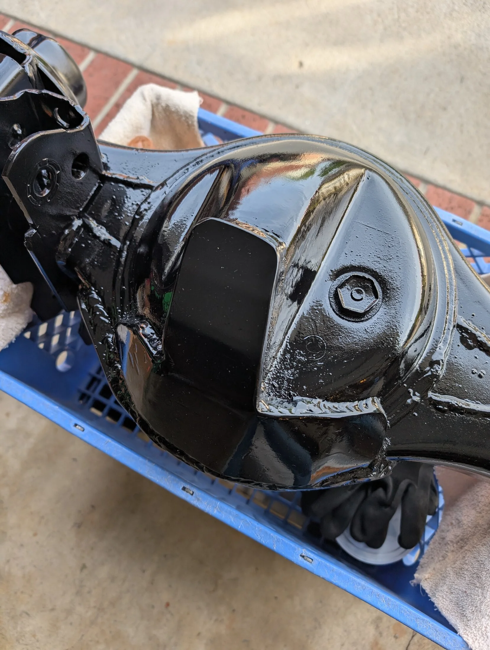

I used Rust-Oleum Farm & Tractor Paint, Low Gloss Black, it's available in cans and as a spray, it is pretty glossy and almost lays on like tar.
I prepped the housing removing all rush I could and using a rusty metal primer before top coating. The painting happened over a few weeks due.to.work schedule and ambient temperatures. It came out pretty good, and very glossy lol
Even the factory cover cleaned up pretty well!

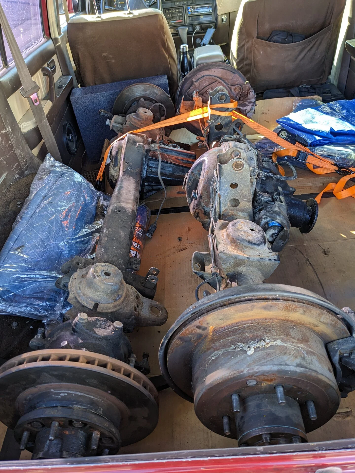

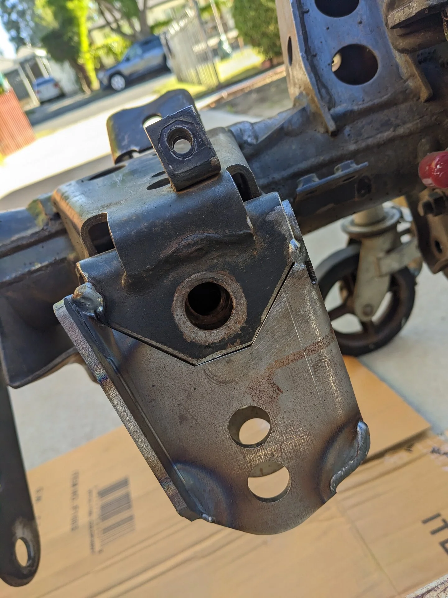

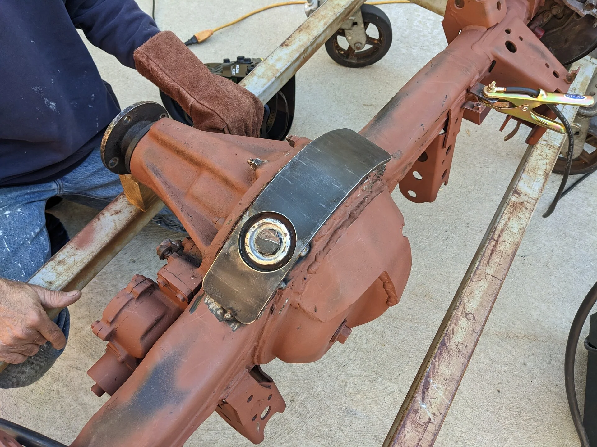

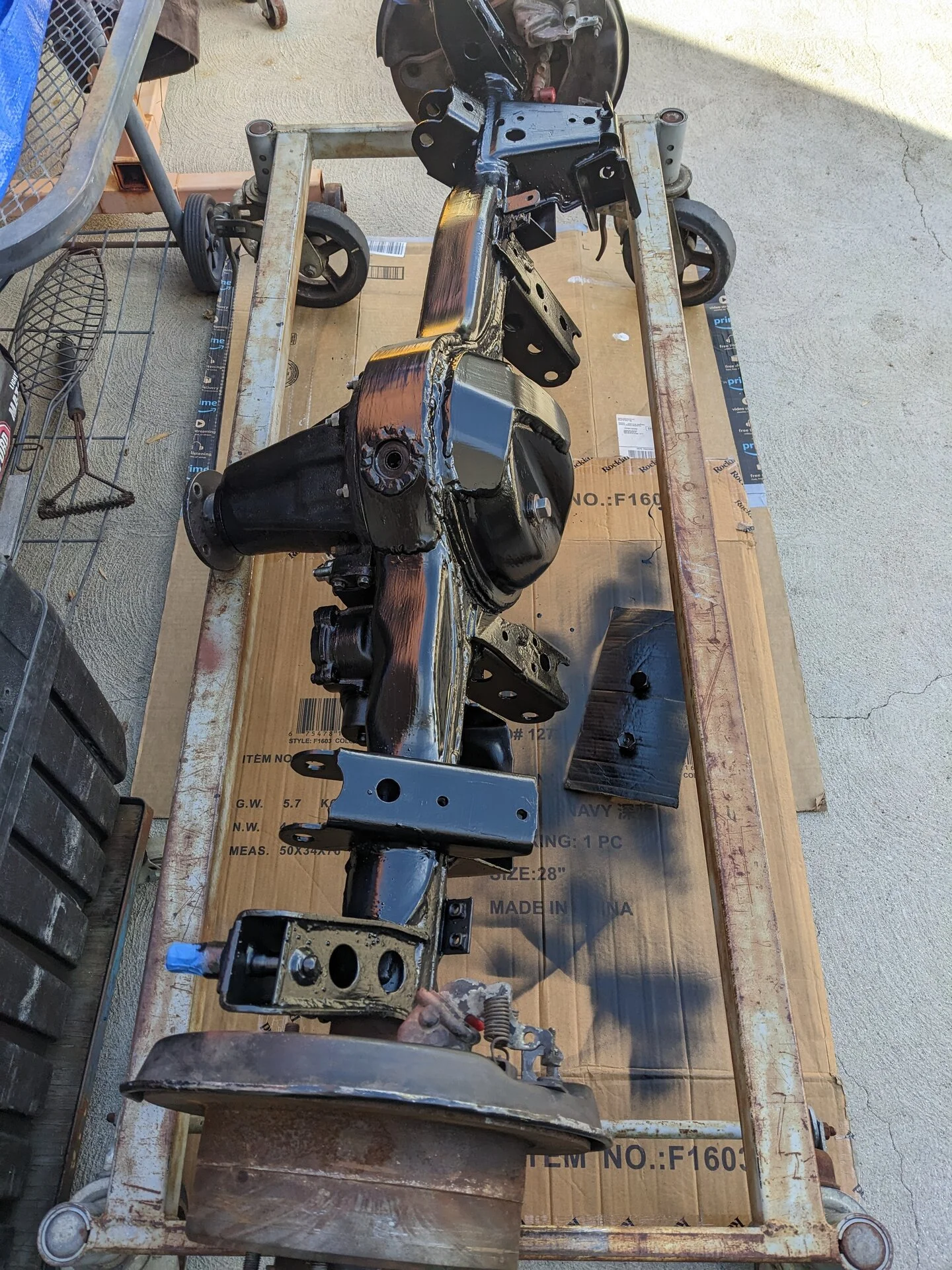

Finally made my way to the front axle. Similar process except i completely disassembled and stripped every part then cleaned and repainted.
The bears looked good and the axles appear to have been swapped not too long ago, barely any witness mark from the inner seals. I cleaned them up with some 600 grit in no time.

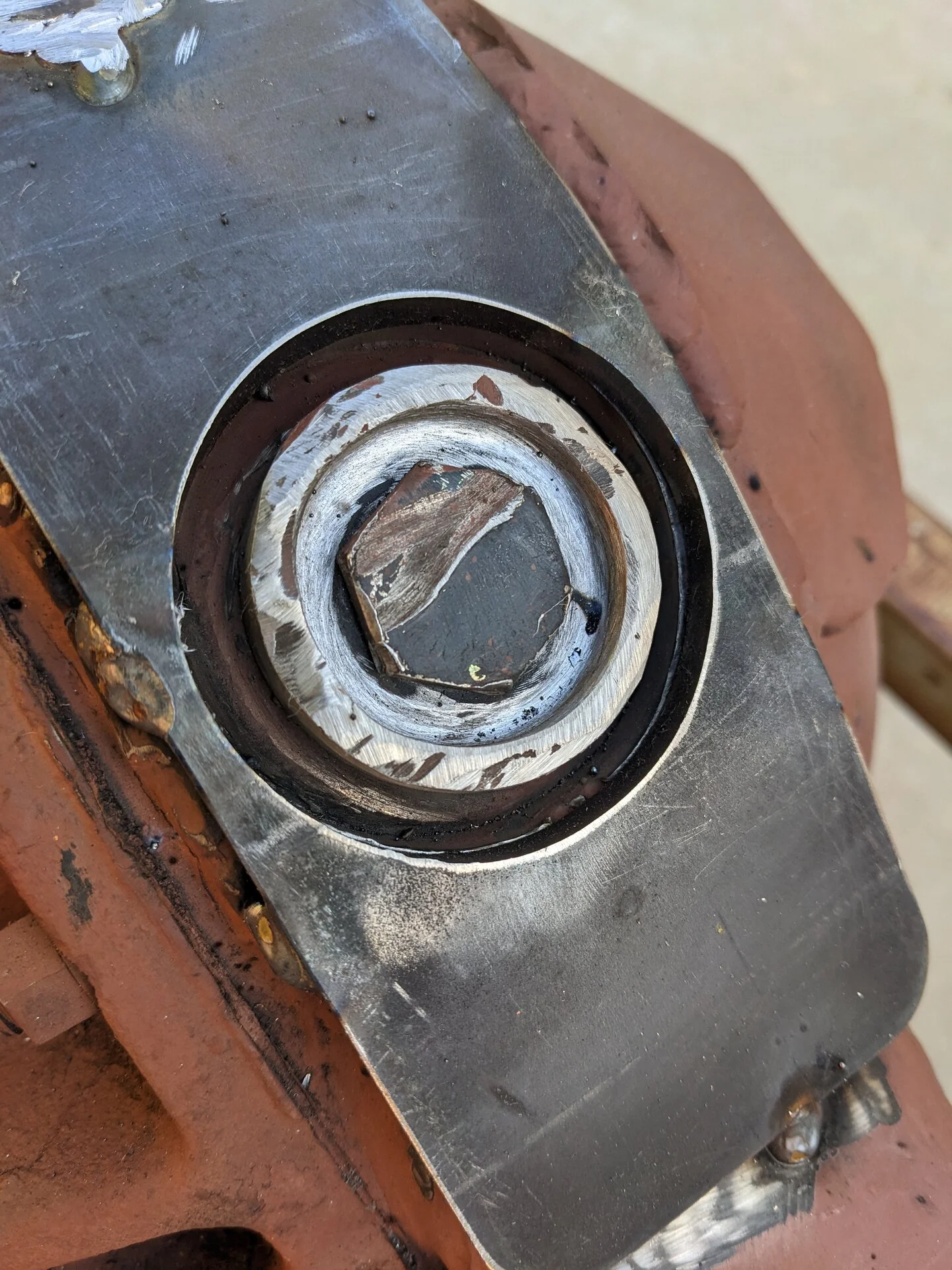

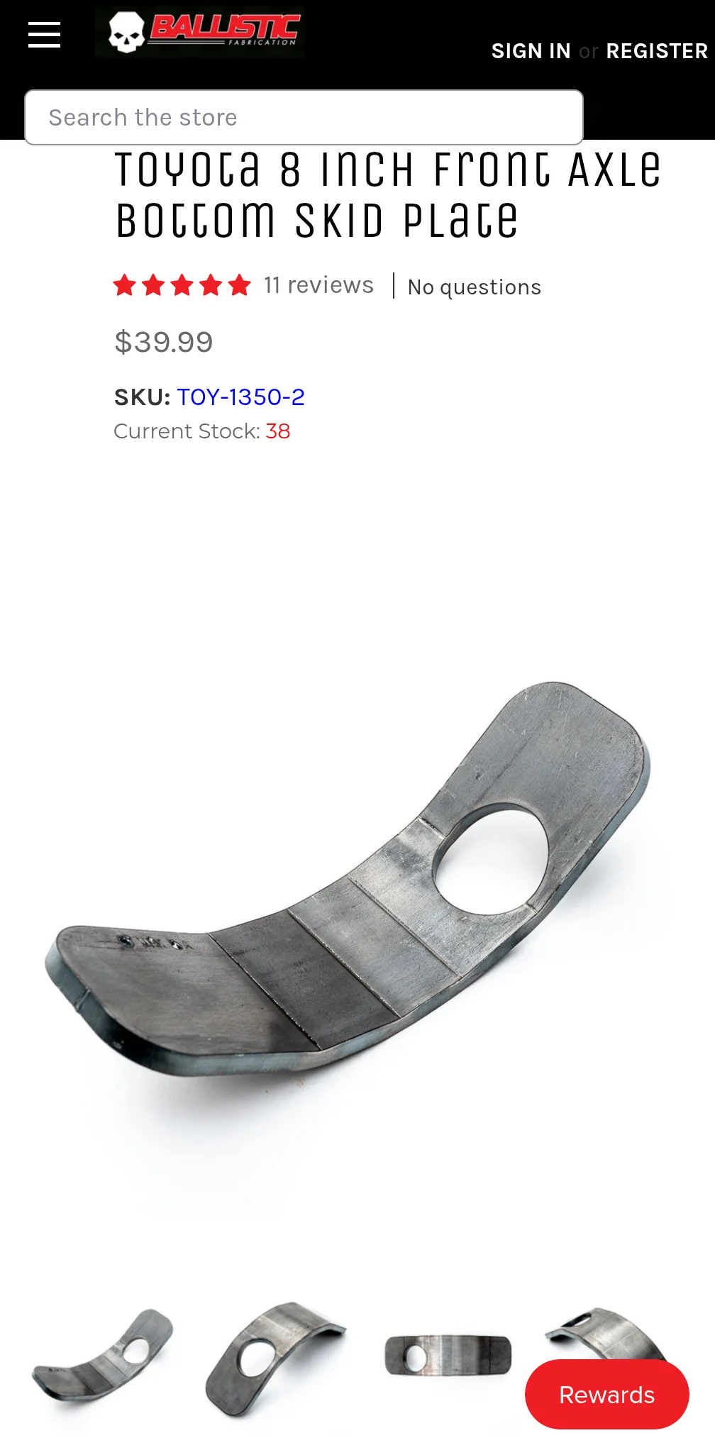

We welded on a 3/8" bottom strap from ballistic fabrication
and the same diff face armor as I used the rear
Ticked it in all place, shaped it and welded it up
New seals all around, repacked with grease and got it swapped in single weekend day.
Wired the locker, need to get some new frame clips to properly secure the harness and install bulbs in the cluster, otherwise, it's now a factory parts triple locked 80.
