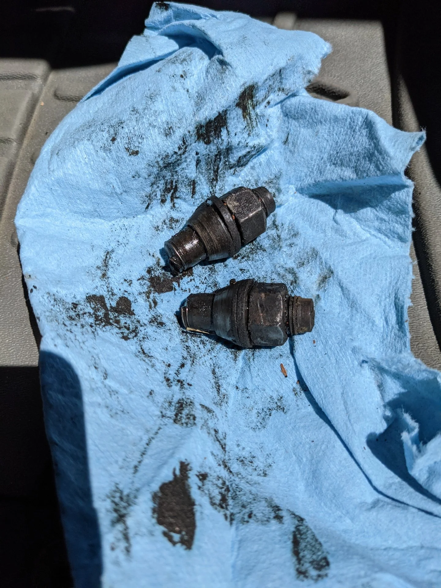

Brake fluid flush/ fill yesterday, when laying underneath the front I noticed on the passenger side there was a gap between the knuckle and bottom of the axle.
Put a 17mm on the nut and found that they were finger tight 😬
Started tightening up and BAM, with little pressure the (2) forward studs broke, nut, washer, cone and stud remnant fell out. 😭
Tightened up the (2) on the rear and made the 20mi trek home. Also noticed the steering wheel being slightly off center since I tightened those (2) remaining nuts.
Drivers side was tight and did not come loose.
I should probably replace all (8) of those studs, cones, washers and nuts...

* Disclaimer- The following pic may be too graphic for some viewers, proceed with caution.
To make you feel better after seeing that - here's the part numbers from Mr.T
Stud - 90126-12010
Cone - 42323-60020
Washer - 90201-12019
Nut - 94115-71200
You are lucky you caught that when you did. ARP studs from Front Range off-Road. Torque to 120lbft.

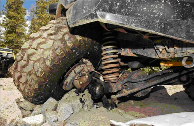

I caught mine at work one day.
Two had fallen out, one was broke off, the last one was almost ready to fall out.
I snugged it up and drove VERY gingerly on my way home.
I installed new ones the next day, but then I installed all new again when I rebuilt the front axle two months later.
I had one break recently out wheeling. Got home and two were finger tight on the passenger side. Upgraded all 8 with ARP studs and saved the 7 I pulled out for spares. I think upgrading to ARP is well worth the money!
If you own a cruiser long enough it becomes a regular check. Often an oil leak is the first indication. You can fabricate a locker for the nuts. Worst case scenario you can nick a couple of studs from the opposite side.
