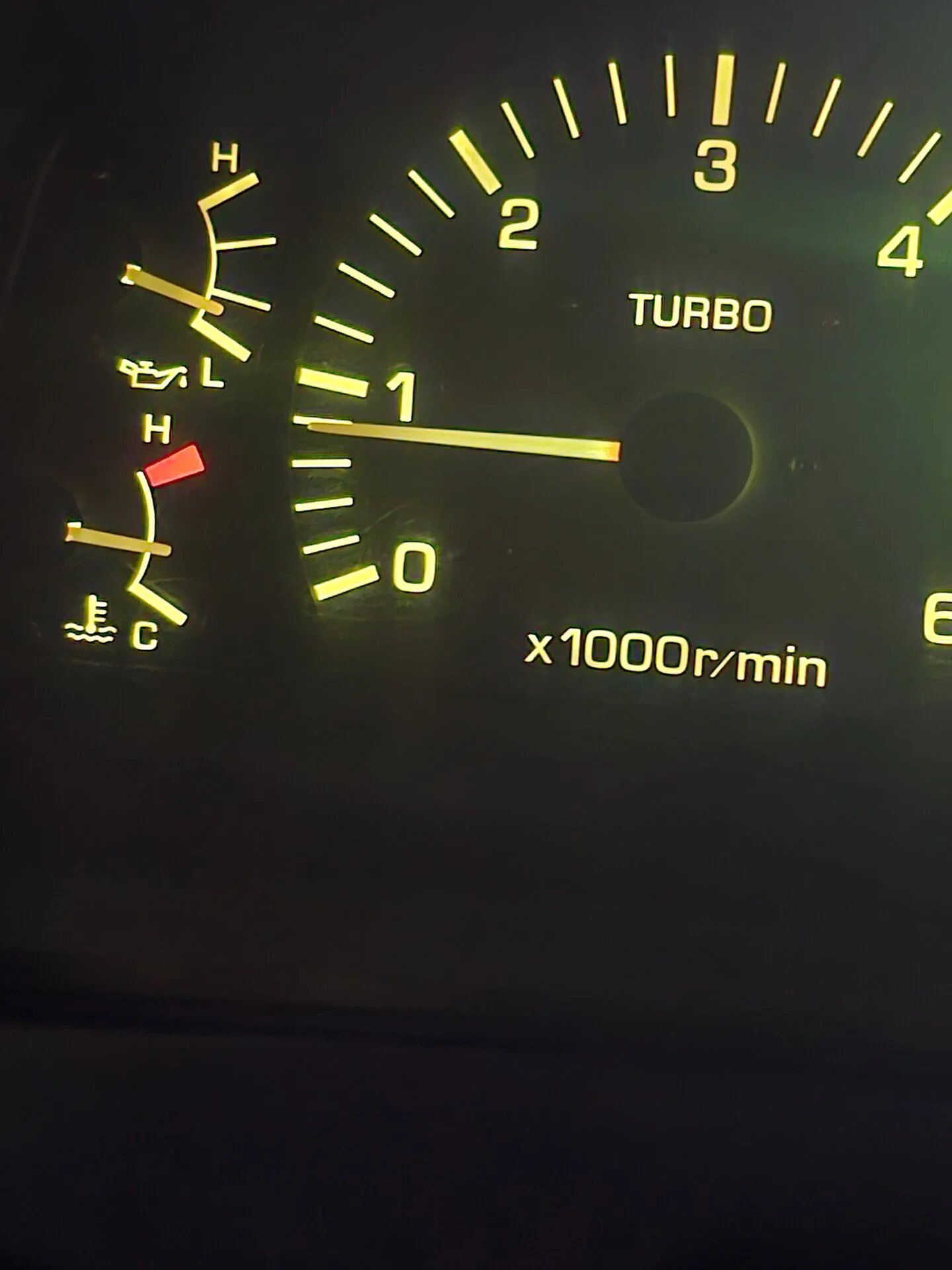

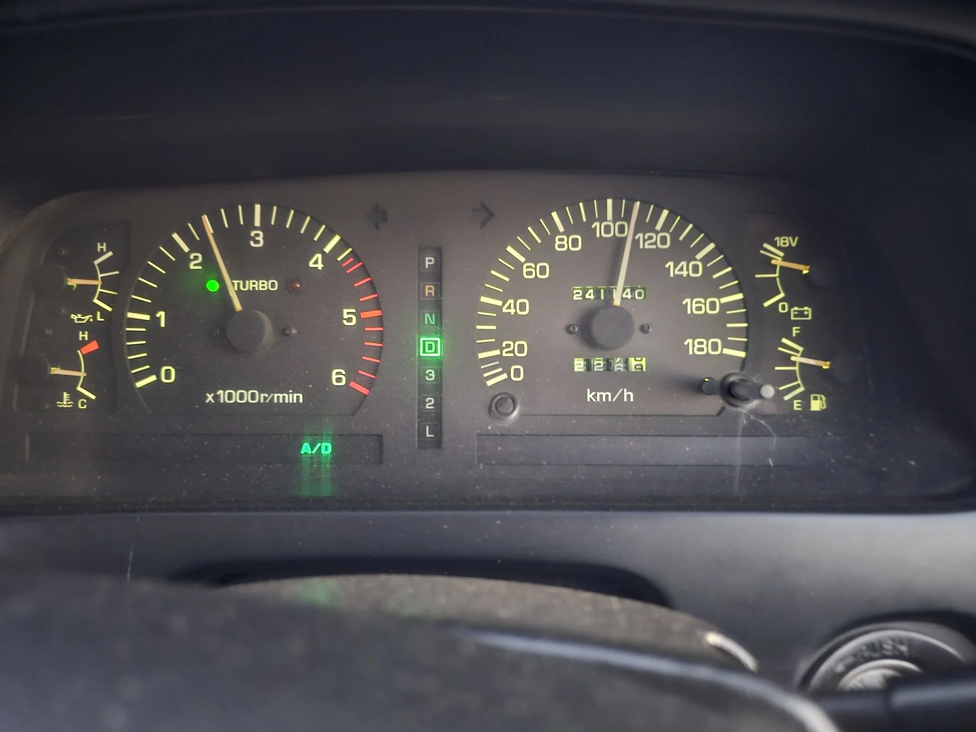

My oil pressure guage maxes out around the first hash. 1HD-T. Will drop down almost to the bottom of the guage at idle. Been that way since l got it in '21. New oil pressure sensor and BEBs in Nov.
Seeing Dustens guage at horizontal gives me concern of my own loitering around a 1/3.
Seeing Dustens guage at horizontal gives me concern of my own maxing out at 1/3.
Mine does the same, fluctuates with engine rpm. Probably close to the above picture at highway speed.

Oil type and weight has a lot to do with it in my opinion. We only use OEM filters so that’s not a factor in my shop. I have yet to see a worn out oil pump in a 1FZ, 1HZ, 1HDT, 1HDFT or 1HDFTE. Even with 300,000+ miles. Got a 475,000 mile 1FZ here I haven’t torn down yet, interested to check it as well. Always check them during tear down and they are always within specs, some like new with 200,000+ miles on them.

Mine used to sit low and barely move. A new sensor fixed that. But mines pretty low at idle
Idle
Hard acceleration

The gauges on these are a reference only.
You need to install an actual gauge with numbers to determine what pressure you're really at and cross check that to the FSM. One that has a direct connection for the oil line, not from the sensor reading electrically.
Yeah, agreed. I wouldn't put a lot of stock in the actual needle position from the oil pressure sensor. I had some issues with mine recently and went through the original, 2 used spares and finally a new OE unit. All read wildly different. Same engine, same oil, same filter, same harness.
It's just there to tell you that you have oil pressure and pay attention if it moves off the normal range your truck typical operates in.
