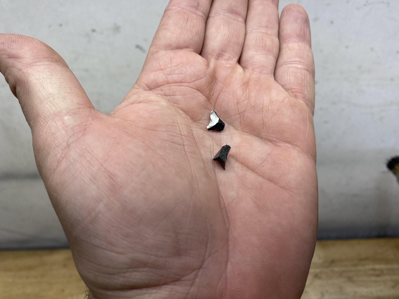

Checked the torque on my knuckle nuts. All good. Those backing plates don't make it easy.
One of these will defeat those backing plates.

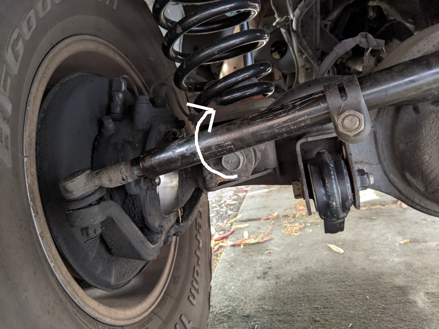

After changing from ome to dobbs springs, the steering wheel was pointing roughly at 11 o'clock when going straight. So, undid the clamps on the drag link and the DS rotated easily, the PS required a pipe wrench and crescent to break free and rotate. Took about 1 complete turn to get the steering wheel to go from 11 o'clock to 12 o'clock. Rotate as per the picture to adjust the steering wheel clockwise.
cheers,
george.
cheers,
george.
cheers,
george.
My steering wheel is the same way, do you have to remove the link in the rear before adjust the front one.
