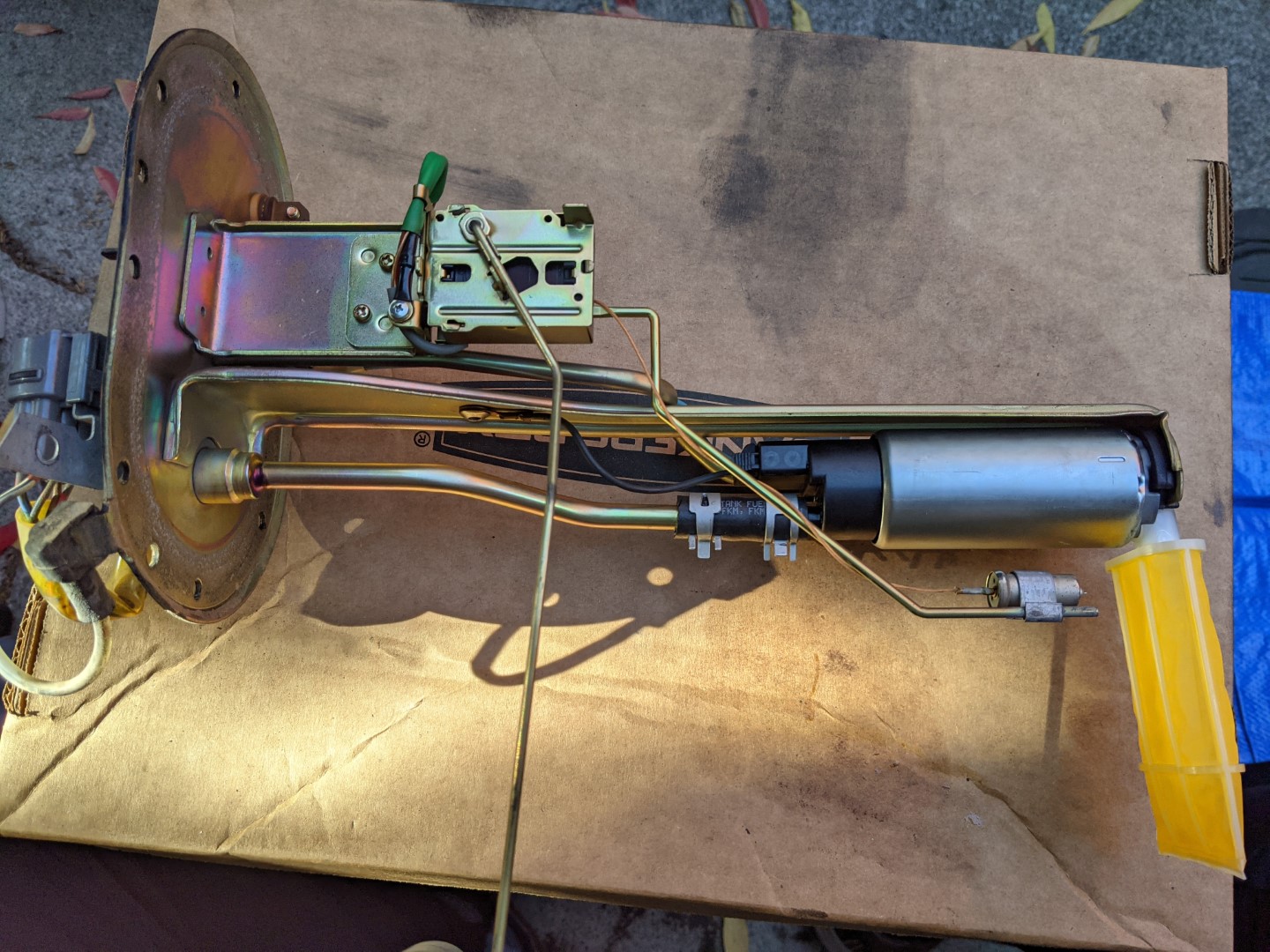

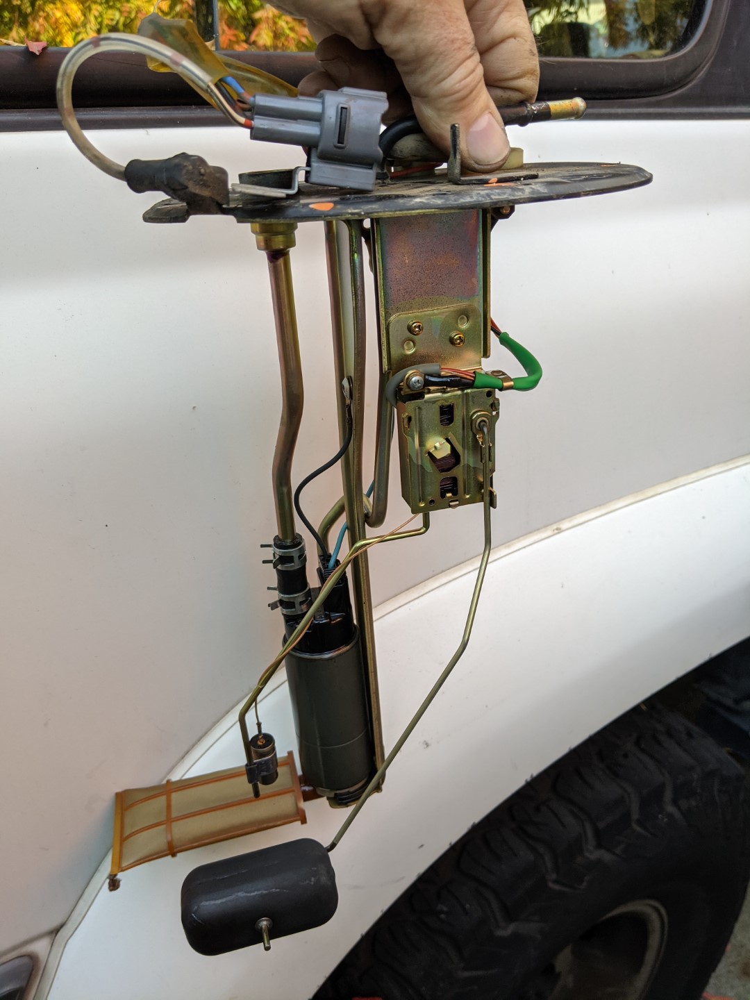

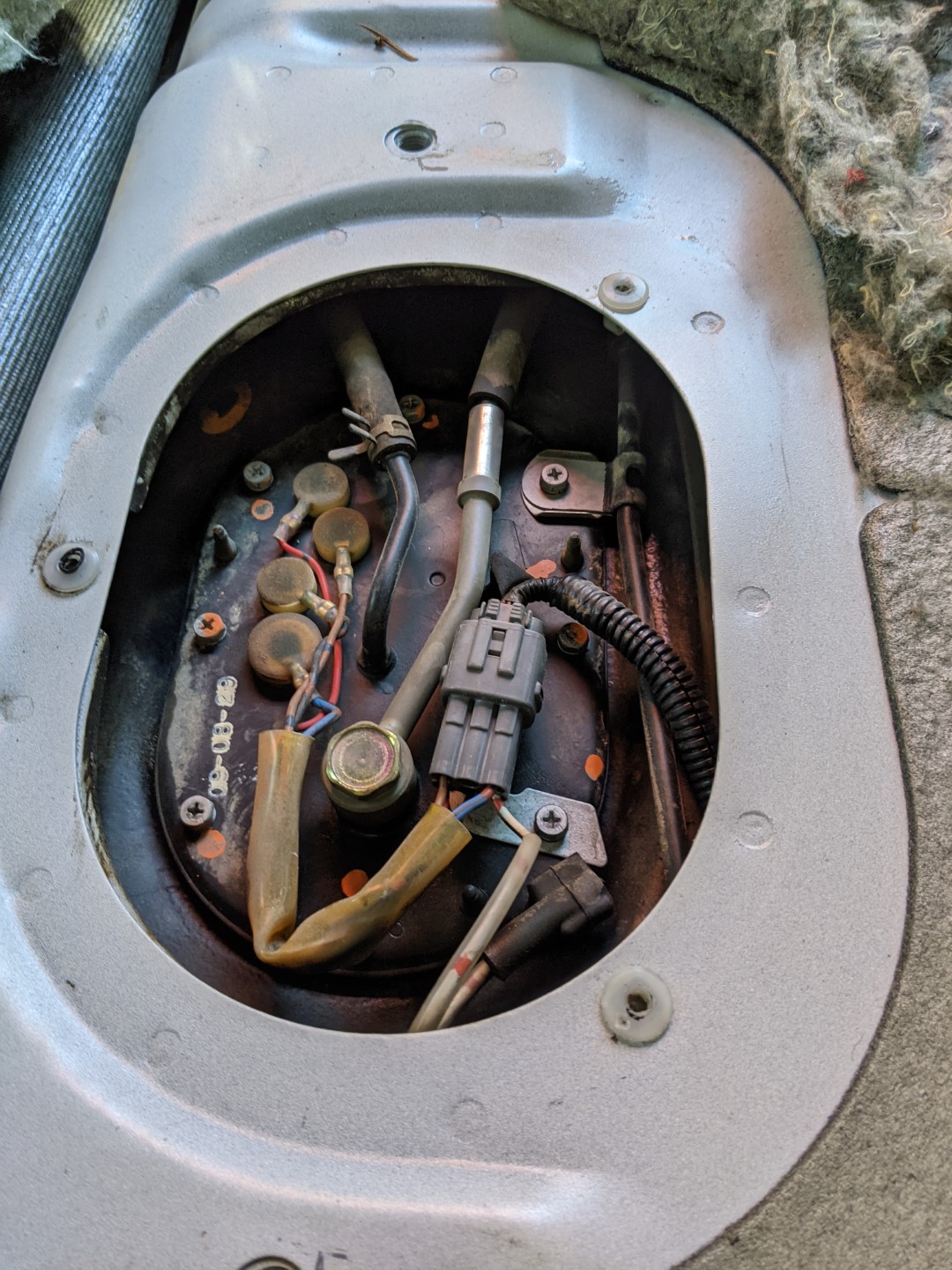

Figured I may as well proactively replace the fuel pump (original from new), so ordered some bits and today's nice sunny day project commenced.
First step after getting access to the pump doodads was to give the area a good clean and then blow dry with compressed air. Simple green and a few rinse cycles and all ready.
Undo the banjo, disconnect the electricals and remove return line and pulled out the pump. Found that rotating the assembly 90 degrees ccw as you lift up gets it all out nicely.
After 24 years I'm impressed how clean everything is. Fuel in the US is impressively clean stuff if you get it from volume sellers.
New pump/strainer assembled

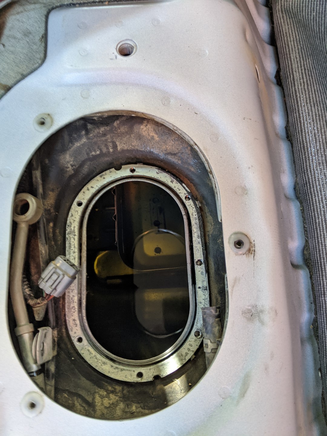

Clean and non-rusted tank

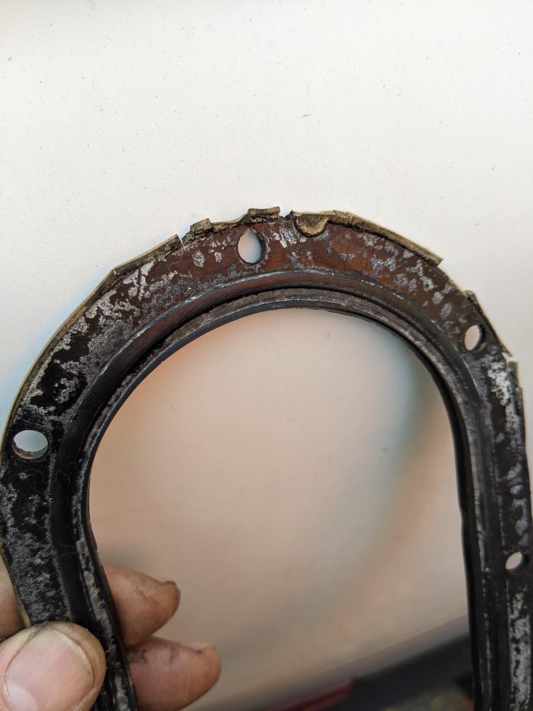

The only thing I would consider aged was the gasket and that was replaced with a new one.
Fired it up and checked for leaks. Bit of a seep at the banjo, so tightened a bit more and all good.
Buttoned up and should be happy for a bunch more years. Old pump is now a spare.

I already had the larger strainer - the denso comes with a smaller one. The denso kit is pretty complete, has most of the pump side rubber bits. All I added to the list was the 2 banjo bolt washers, the large gasket and the rubber isolator on the bottom of the fuel pump (though the original isolator was still pliable and could have been reused).
The denso is plug and play - connector mates with the OEM stuff.

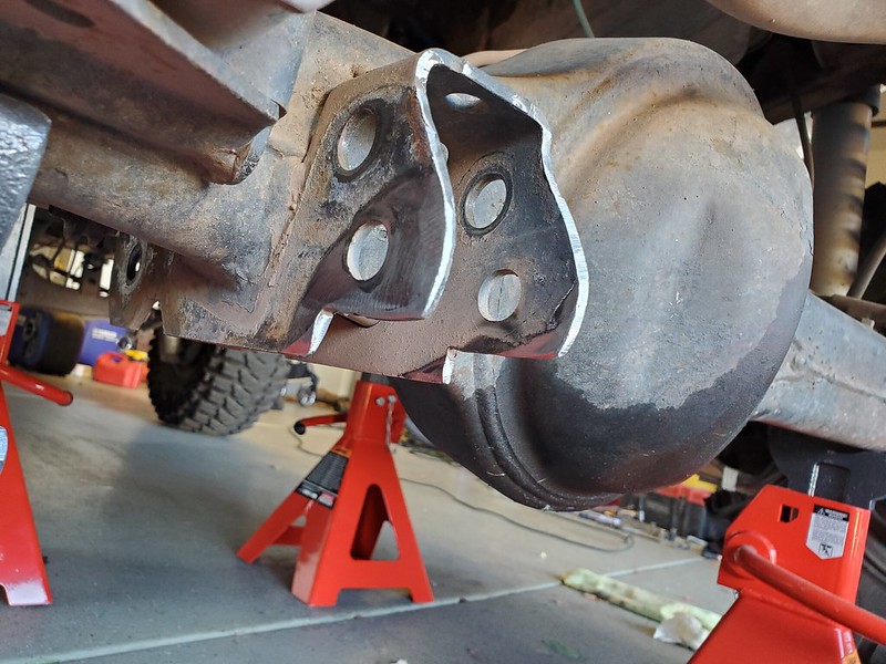

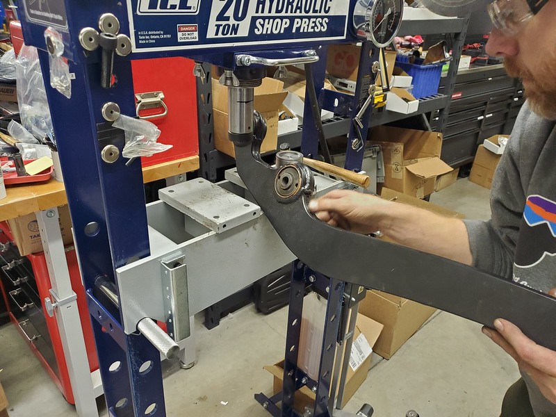

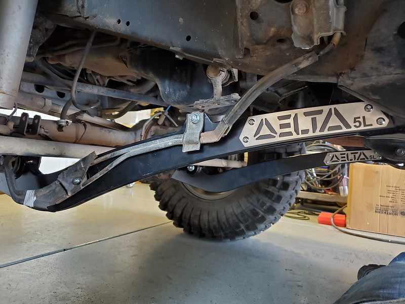

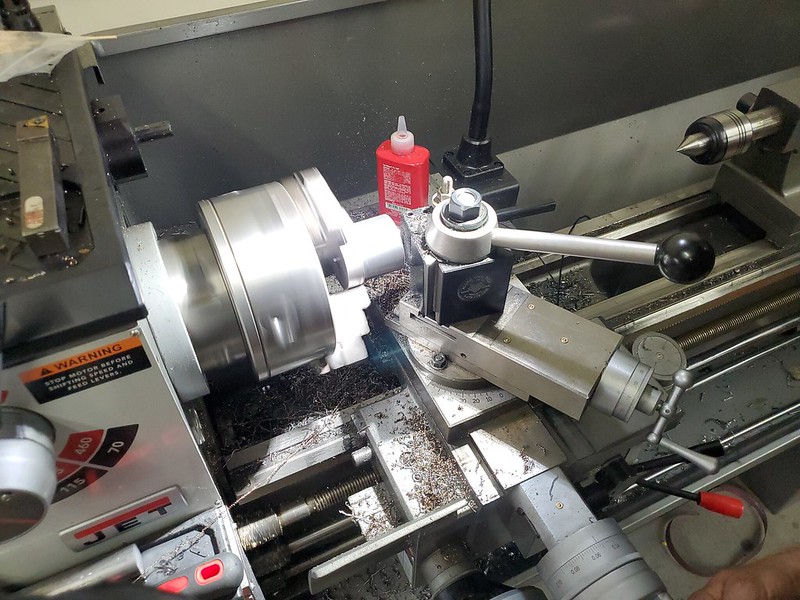

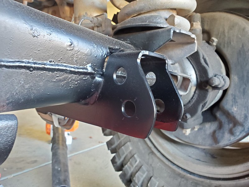

Finally got around to installing my new Delta Radius Arms. This would have been a 2 hour project but I ended up having a steel bushing press tool made, and had to reverse some of the notches from the caster plates that I installed about 10 years ago. Finding steel bushing presses is impossible right now, and I didn't want to bother with the aluminum ones from Slee as they are quick to deform, so @lelandEOD used his lathe skills to make a set out of some 2.5" round stock that I picked up. Good thing I grabbed a 6" piece as we didn't realize that the axle side and frame side bushings are different sizes, so two different press tools are needed.
It probably would have been ok to mount the new arms without reinforcing the steel below the front mounting hole, but it was a good excuse to practice some off hand and upside down welding.
It only took about 7 tons of force to pop out the old bushings. I replaced them a few years ago so I decided to reuse them. They slid right in the new arms. Most of the time spent on this project was waiting for primer/paint to dry. These arms are pretty well built and clear the HD tie rod with room to spare. The trail repaired OEM arm (broke on Rubicon, truck has not been driven since) actually still looked good and probably would have been fine long term...but not something to chance.

What are those lines running down your radius arm?
